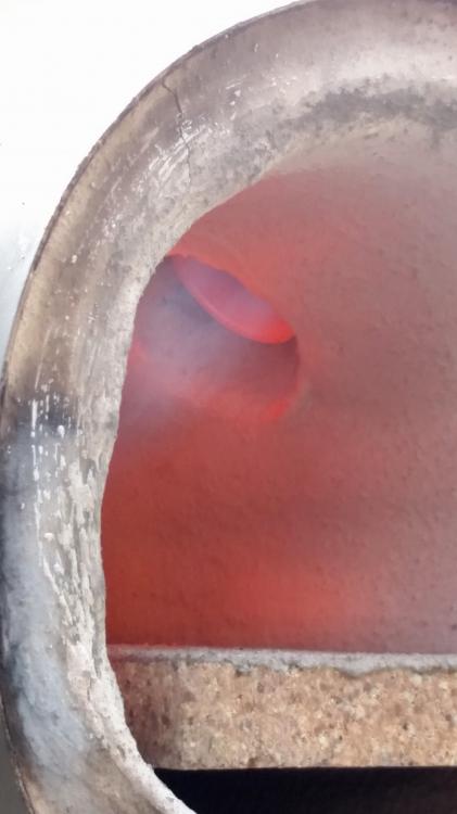

The burner works and seems to heat up this tiny forge VERY quickly.  The interior of the forge is about 5" diameter and 10" long and I have closed up the back with two insulating fire bricks. Ceramic wool has been coated with satanite and ITC100.
My question is, should the tip of the burner get hot enough to start glowing a dull red?
I have the regulator set at around 9psi. I would have tried a bit more, but I ran out of propane after about 10 minutes of fiddling with it.  I guess I should have gotten a new tank before starting.
Any insights would be very much appreciated.

Here are a few pictures that might help.
- Here you can see the dull glow of the burner tip.  The tip is almost even with the metal body of the forge.  It had been running for 8-10 minutes.

As far as the tip of the burner glowing red.... not a problem.  When the forge gets really hot it will be the at nearly the same temperature as the forge. Yellow/white.
while you have it handy you may want to get a couple of replacements for the tip.  Those things have a bad habit of melting or other wise deteriorating.
Don't obsess about the fuel pressure.  Running the pressure up and down and adjusting the air inlet are methods of regulating the temperature, atmosphere, and fuel consumption.
Thanks for the info.   I thought I remembered reading something about a glowing hot flare was an indicator of the flame burning inside the tube of the burner.  It does make sense that it will be near the same temperature as the inside of the forge, But I just wanted to make sure.  I have read so many threads on so many forums that I probably have a case of information overload.

Looks like I would expect. The flame is burning back to the section in which there is an increase in size.  Out of forge doesn't really matter.  Put it back in the forge with the flare not so deep in the forge as before and increase pressure of propane and more air.  Your forge looks ok.
Your burner  is ok.  but more air could be added  when in the forge.
It sounds like you were originally running a fairly low pressure because of your near-empty cylinder and I'm guessing you had a relatively lean mixture (not much dragons breath) with the choke fairly wide open. This combination may actually get the burner tip hotter than most other settings: a hot flame with a fairly low mixture speed.

Adjusting the pressure adjust the amount of flame you have. Adjusting the choke varies the air:fuel ratio and with it the flame temperature. Increasing air makes the mixture leaner (more Oxidizing), reducing air makes the mixture richer (more reducing).
The highest flame temperature occurs when the mixture composition is such that all of the Oxygen in the air reacts with all of the fuel gas, leaving neither unburnt Oxygen nor unburnt gas. This is known as the stoichiometric ratio by combustion engineers and (supposedly) as a neutral flame by smiths.
As far as I can tell, "we" tend not to want reducing atmospheres because they cause very rapid scaling. Scaling (oxidation) still occurs at the stiochiometric mixture and even some way rich of it, which I suspect makes a smiths idea of a neutral flame different to a combustion engineers idea of a stoichiometric flame.
When I put together a forge burner, I aim to size the gas jet so that I get a mixture that is around stoichiometric with the choke fully open. This means that I can adjust the flame temperature by choking down the airflow.
Generally speaking, for a given choke setting, there is not a lot of change in the air:fuel ratio when the gas pressure changes in a Venturi burner: as the gas pressure increases, the gas speed through the jet increases, so the suction generated at the Venturi throat increases and the airflow therefore increases, keeping the air:fuel ratio constant.

This is the first time I've seen one of these burners, but I can tell you a few good things about it. In the first place, seeing the red/orange hot flame nozzle out in open air  tells me that the fuel/air mixture is exposed to a generous ignition source (very good). Your combustion is mostly in the primary flame envelope; AKA combustion wave front (also very good). The orange streaks in the secondary flame are from a reaction between super-heated gases and that particular stainless steel alloy, which is undoubtedly #304, instead of the longer lasting #316 S.S. alloy; you needn't worry about them, but you will have to replace your flame nozzles much sooner than you would with #316.
Now we come to the color of your primary flame, which has a slight tinge of green in it, instead of being pure light blue. There was a time when I would have said VERY NOT GOOD, but so long as you use your forge outdoors, or are careful to provide your forge area with a powered exhaust system for it is  merely problematic; in other words both good and not so good. The good part is that it will provide a perfect heat source for welding, as the slightly reducing flame will protect your work from oxidation, while in the forge. The not so good part is that, if you ignore Frosty's recommendations about providing a powered exhaust system and CO alarm in your shop, you could end up with carbon monoxide poisoning, which is an outright bad thing.
