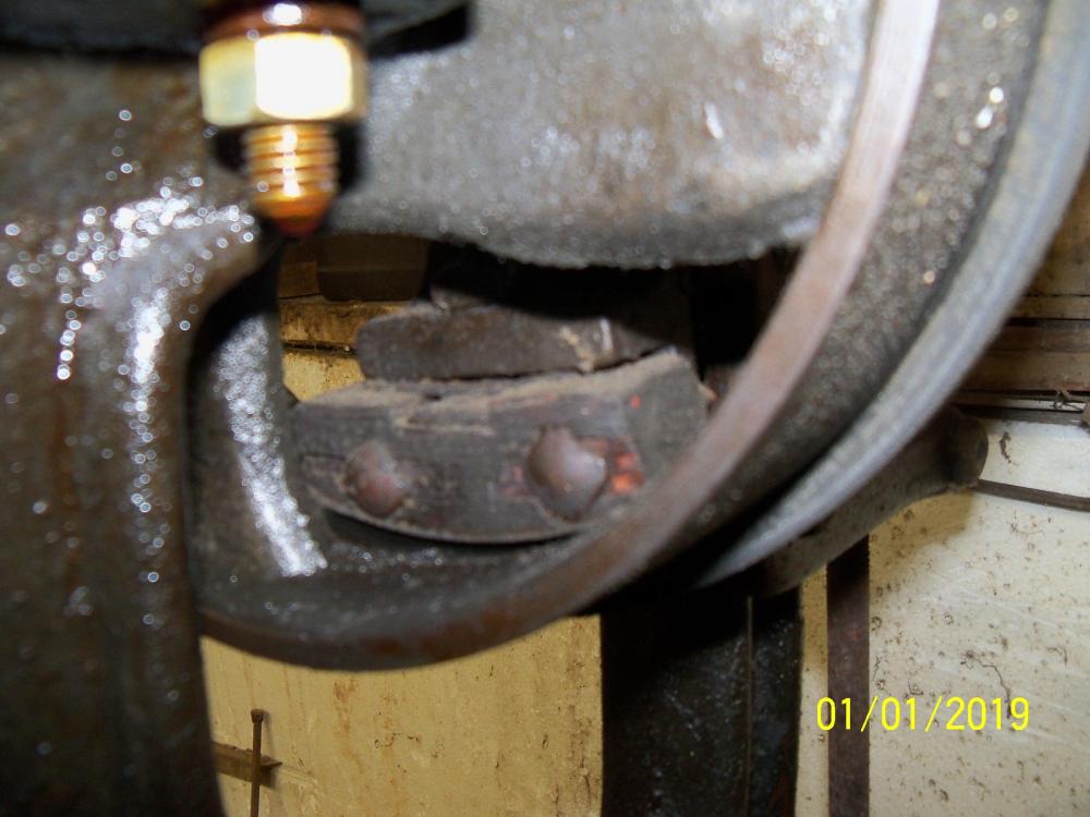

If you look up article on Welded Hammer Dies  they are amazingly simple to make... That's coming from a blacksmith not a machinest.....Can anybody help me with My 50# Star? I can't seem to get it timed right without "loping".. I've rebuilt lots of Little giants but this has a different feel.. I read one article that said the clutch blocks were wood,but mine are metal...

Chris: Thanks. I was looking for info for a Star I'm rebuilding and and responded before seeing the date. However- I sure saved some bucks when I learned to make my own dies instead of paying to have them machined.  I'm still stumped as to why my Star has metal blocks and all pictures I see have wooden ones...

Wonder if someone retro fitted steel not knowing they were wood. If your blocks have a lining like brake shoes they will be sturdier and last longer than wood blocks. To me metal on metal is not good. Do you have a picture of them? I made one set of dies out of RR rail. Used an angle grinder to put in the dovetail, not hard at all.
I don't have a picture. The blocks are perfectly fitted but, like you, I wonder about wisdom of metal on metal. I started using a Little Giant in 1967 (yup I'm an old fart) so when I first started the Star up I did what you do with Little Giants and squirted the heck out of it with oil .Oops-wrong thing with this hammer. Wouldn't work worth a tinker's dam.. So I cleaned off pulleys and belt with carb cleaner and it runs like a champ... Wouldn't have known about metal blocks if I hadn't squirted oil on them....Anyway- I am going to take them out and either have metal shaved down to where I can put some asbestos on them or make some nice oak blocks... I'll put it on here when I'm done. Thanks for your reply.... Eric
Not a problem at all once I figured out that you don't treat a Star like a Little giant. Have it going fine now with clean clutch and some nice synthetic blocks.. It is a metal smacker...
