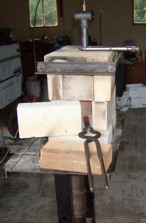

jacob's hammer Posted August 27, 2015 Share Posted August 27, 2015 You could do t-burner,regulator and firebrick for around $50also, start collecting tools for all imaginable hobbies. someday you will be glad you did.good luck. Quote Link to comment Share on other sites More sharing options...
Elvirth Posted August 27, 2015 Author Share Posted August 27, 2015 You could do t-burner,regulator and firebrick for around $50also, start collecting tools for all imaginable hobbies. someday you will be glad you did.good luck.Ok, so I've been searching and searching for a build guide for the T burner on here, on google, and I've come up with nothing except a very vague sketch and a few blurry pictures. Is there an actual thread buried on here somewhere for that, or a webpage that is still actually up? For the firebrick, I'm assuming that's for covering the front of the forge, not for use on the inside, correct? Quote Link to comment Share on other sites More sharing options...
jacob's hammer Posted August 27, 2015 Share Posted August 27, 2015 (edited) this is mine. Edited August 27, 2015 by jacob's hammer Quote Link to comment Share on other sites More sharing options...
Elvirth Posted August 27, 2015 Author Share Posted August 27, 2015 The reason I'm focusing on using a can or other cylindrical piece of steel is because I live in a duplex and have a very small space out back where I can set up a small basic forge to learn on. Thus I have to have something portable-ish so I can cart it in and out of my basement when I'm not using it to protect it from the elements and so forth. I just feel like moving fire bricks that much would probably do more harm than good. Quote Link to comment Share on other sites More sharing options...
