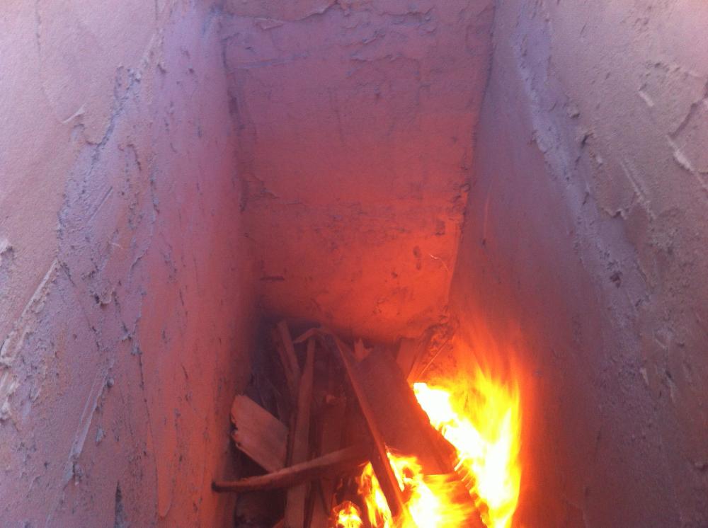

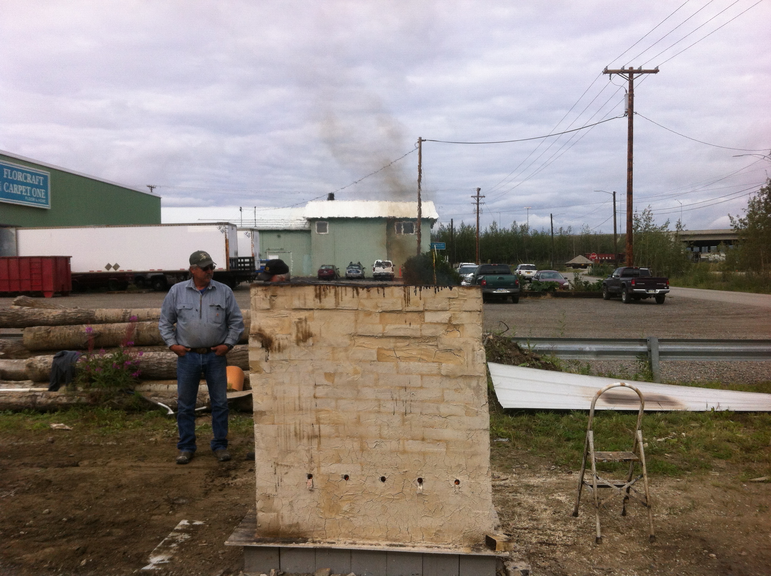

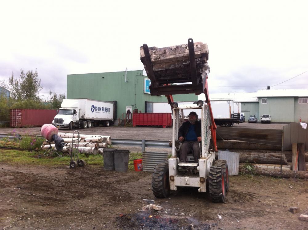

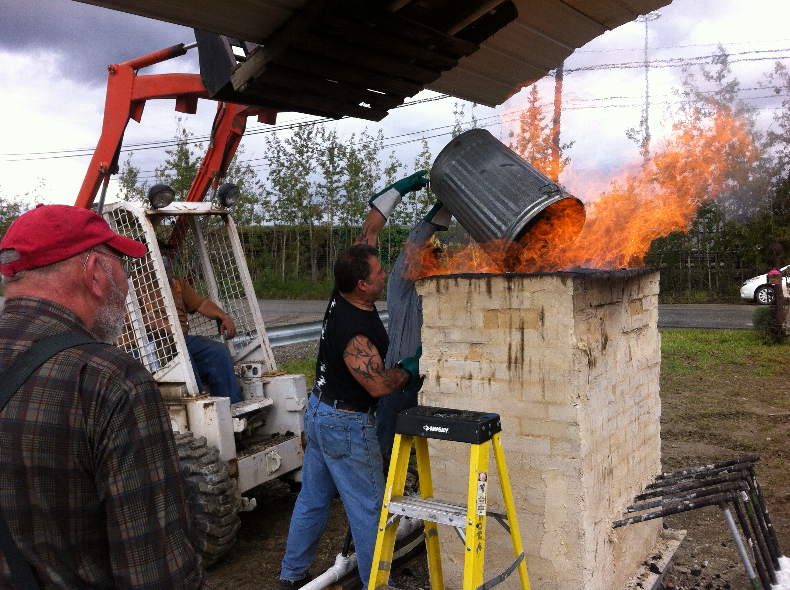

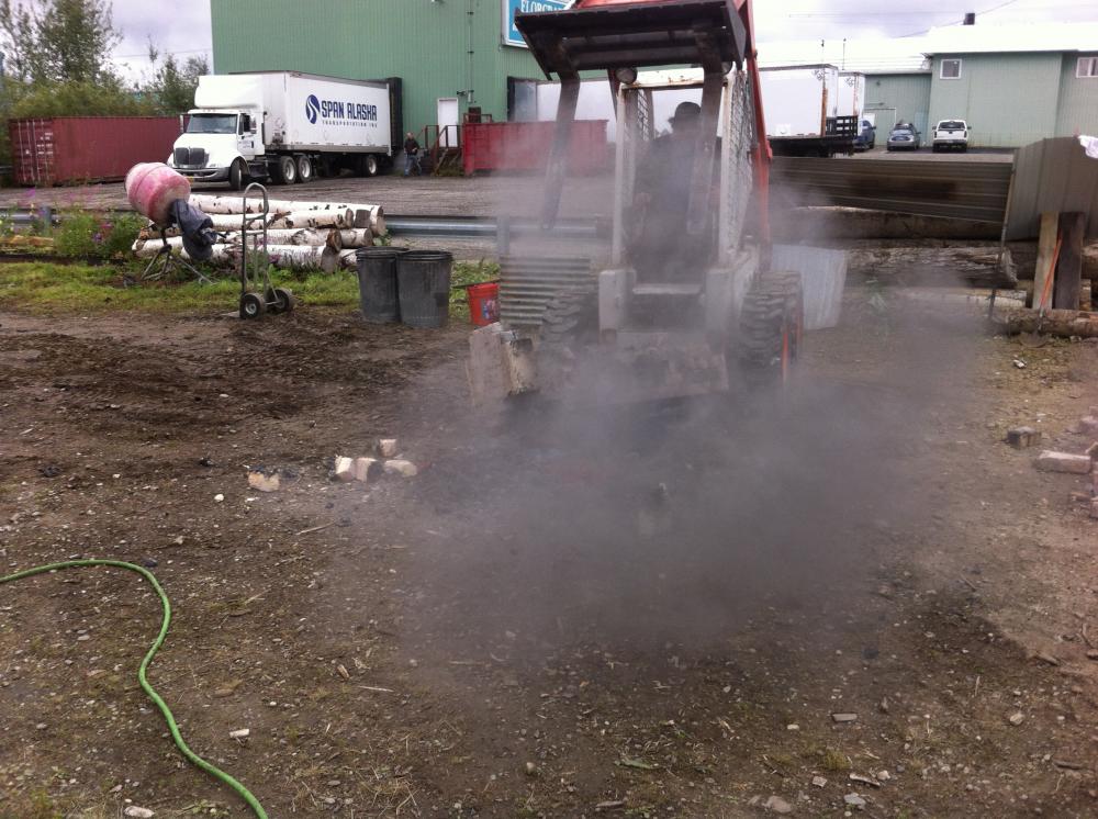

K. Bryan Morgan Posted August 14, 2015 Share Posted August 14, 2015 A project that I've been working on since Tuesday. Some friends and I worked on making steel. We had ABS Master Bladesmith Bill Burke to head the project. After many hours of hard work we broke apart the furnace and found....not much. It was a terrible disappointment. We had hoped for about 300 pounds of usable tamahagane steel. The leaders of our team are very experienced and knowledgeable, however many variables can contribute to a poor outcome. Weather wasn't great. The iron sands were from an unproven source. It could have been any number of things that lead to the less than hoped for result. After going through 400 lbs of iron sands and two tons of charcoal we estimate that we ended up with about 7-10 lbs of material that will have to be can welded to be usable. Getting together one more time tomorrow to see what can be done and to salvage what we can. Still, I would totally do it again. Quote Link to comment Share on other sites More sharing options...
phabib Posted August 17, 2015 Share Posted August 17, 2015 That's really interesting. My son and I have been talking about collecting some ore and trying to refine the iron out of it for a project. I was thinking of a smaller scale project using some terra cotta flue tiles and then throwing in more ore and charcoal as it burns down and (hopefully) taking some iron from the bottom the next day when it all cools down. After that we'd turn it into wrought iron. With no real info to go from, I was thinking that getting 10% iron from the ore would be acceptable to us. A bucket of ore and a couple big bags of charcoal could give us a couple pounds of iron and we'd have enough to make some small project from the resulting wrought.Any advice or reality checks from someone who'd done it? Quote Link to comment Share on other sites More sharing options...
Frosty Posted August 17, 2015 Share Posted August 17, 2015 Good GRIEF Bryan, that was quite the project! Did you concentrate the ore with a magnet? Roast it first? Details please, I REALLY wish I could've been there.Where did you guys do it? I'm no longer familiar enough with the interior to recognize the neighborhood but that isn't in the bush. I also love to see a typical Alaskan project, if we aren't burning diesel we ain't serious. Power tools forever!If you were to want to drive to Haines I can point out a big black mountain of magnetite that's listed as a hazard to navigation it's so magnetic. The highway cuts the toe of the slope so you don't even need to pull all the way off the road to fill a truck. Hmmm?Frosty The Lucky. Quote Link to comment Share on other sites More sharing options...
K. Bryan Morgan Posted August 18, 2015 Author Share Posted August 18, 2015 Phabib, yes doing it using flue tiles is possible. We ended up with about 20-25 lbs total. I have more pics to post as soon as I find my phone. Now where did I put that? So yes. Terra cotta flue tiles and a shop vac blower. The largest expense for the project was the 4000 lbs of charcoal. Now it was hardwood charcoal not soft wood. I don't know if that made a difference. The ore was untested. It came from SE Alaska and was all sorted by magnate. All 600 lbs of it. We used approximately 400 lbs. Frosty, yes we dried it out on a big bit of 3/8" plate with a turkey burner under it. We dried it out. I don't know if that's what you mean by roasting it, but that's what we did. Bill Burke has done this about a dozen times. We did get very usable material and it was forged into a blade. I don't have pictures of that particular blade but everything else. He used the tamahagani method. Sorting and stacking, smashing folding and welding. No rice paper, no rice straw just borax. It all stuck very well and the steel had a very good grain structure. The location was at Mark Knapps shop, The Cutting Edge, in the rail yard. We were basically in town. Hoodoo brewery is right next door. We have a small group of artists, knife makers and blacksmiths who meet there monthly. Well one blacksmith anyway...lol. Mark is super talented. Everyone was very excited to try this and we had a wonderful time. I mean fire, steel, large hammers, how much better does it get? We were disappointed by the small return, but then its the first time we've ever done this and the first time this particular ore was ever used for this purpose that I know of. So there were several unproven factors. We had a sheet steel vapor barrier between the bottom of the furnace and the ground. An airspace made with concrete block, a hardy board barrier, then fire brick mortared with sand, clay and grog, with sawdust mixed in. We fired the furnace and then covered it over night letting it dry out. The next morning it was still just a little bit damp on the exterior but the interior was quite dry. We began filling the furnace with charcoal and started the blast. Filling it to the top. When it was full we started adding the dry iron sands, one coffee can for every 25-30 gallons of charcoal, wait 12-15 minutes and repeat. That was done for about 24 hours. Durring the night one of the tewyars blocked up and was removed. The next day we let it burn down to the lump and started taking it apart. When we first saw it we were very hopeful but as we broke things up it became apparent that we hadn't had very good success. All that said we did have a very good time doing it all. Bill was very knowledgeable and was happy to answer questions. We got lots of people from next door at the brewery coming over and asking questions. One guy even started chopping charcoal up. His guest from Germany asked lots of questions and we were happy to accommodate. Quote Link to comment Share on other sites More sharing options...
DanielC Posted August 18, 2015 Share Posted August 18, 2015 If it is magnetite, you wont have to roast it. Hardwood charcoal is the preferred charcoal for smelting. Softwood for forging.Very cool experiment guys!! Lots of charcoal and ore. Several factors can lead to a poor return. Air pressure ran too high, and low yield ore are obvious ones.Question, did you guys test your slags? Often the first slag tap or so will be magnetic, and the following taps should start to be mostly pure impurities, of course this would be hard to tell if you allowed it to self tap. I would check the slags and see if they are very magnetic. This could be indicative of running the furnace too hot, as you were essentially creating cast iron, and it was pouring out with the slags.Normally I would change only one variable per smelt until you get it somewhat dialed in. Every smelt is a little bit different as no two ores are exactly the same. Some slags require lower or higher temps to be runny. At least you know you weren't running it too cool, as it didn't irreversibly freeze up.Also from here I would try the ears of both Lee Sauder and Mark Green for any further suggestions. Both have the experience of smelting over 100 times in the recent decade. Quote Link to comment Share on other sites More sharing options...
