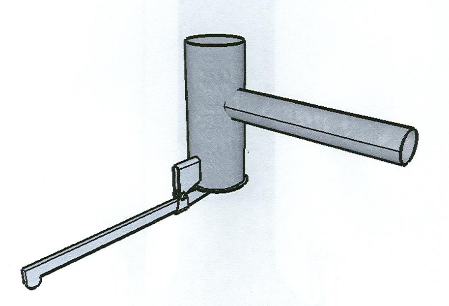

Frosty Posted July 31, 2015 Share Posted July 31, 2015 Charcoal is free if you make your own and bamboo grows FAST. Bigguns is right, take a college extension welding class and build a forge as the class project. Easy Peasy and the instructor will help you.The hub hole diameter in a brake drum, Rotor (better choice) doesn't matter one bit. Simply cut a piece of steel and drop it in the hollow, Hole GONE! Now make one that fits.No need using plumbing pipe. I like exhaust pipe, it comes in lots of sizes from Dump truck 5"+ dia. down to motor scooter 1"?. 3" makes a nice vertical section connecting to the air grate. Make it about 8"-10" long. Then make a 2" dia. hole in it about 4"-5" from the air grate. I use a hole saw and a hand drill, easy peasy. Now just weld a short piece of 2" x 6" pipe to the hole and you have a "T" shaped tuyere. Connecting it to the air grate is the ONLY challenge, a little imaginative saber saw work and you can have tabs and screw/bolt it to the air grate but if you're taking that welding class just buzz it on.Now you have a tuyere (air blast supply pipes) an air grate. (The plate blocking the hub hole in the rotor/drum) The plate needs a hole or two so air can get to your fire. don't get carried away 3-4 1/2" holes is more than enough and it's easy to drill more if you wish. It's also easy to just block a few if it's too much.One little thing, the bottom of the vertical section is wide open! This is my favorite part, next to how easy the thing is to build. You want an ash dump so go to the truck supply you talked the exhaust pipe drops out of. (Oh NO don't buy the exhaust pipe! talk to the guys at a truck shop and see if they have any drops, short sections trimmed on stock on a job. It's usually headed for the scrap bin and folk LIKE helping blacksmiths you know. Oh yeah, the ash dump say your vertical section is 3" hit the supply and buy a 3" exhaust flap cap. You know those thing you see on top of exhaust pipes on semis. Add a little extra weight to the counter balance and clamp it to your tuyere with the counter weight facing here you're going to stand so you can reach under the forge with tongs, hammer, piece of wood, etc. and flip the ash dump open if it gets full.Were we in my shop I could build all this faster than I can write directions. did I say it's EASY?I couldn't find a good pic so here's a drawing with a silly long counter weight arm and I show it integral to the pipe but they actually just clamp on. It's easier than it looks.Frosty The Lucky. Link to comment Share on other sites More sharing options...
