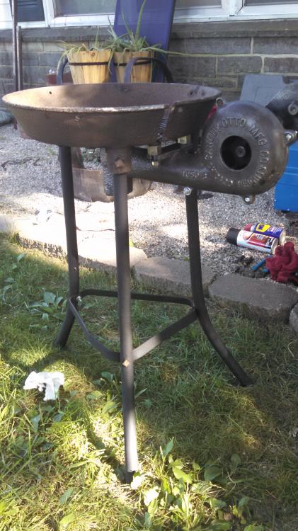

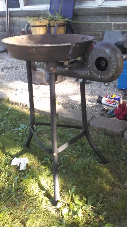

  2. Like I said, the rotor is basically sitting on top of the pot. The welds could have been bolts set outside the rotor against its rim and it would accomplish the same purpose.
  3. Thanks for the warning but the welds are only to keep the rotor from sliding around too much. The rotor sits on top of the original pot and the blower is bolted to both the pot and rotor. Gravity keeps the rotor in the hole and the blower is hanging from the bottom of both. If the legs where attached to the blower this might be a problem, but I made sure everything worked out.

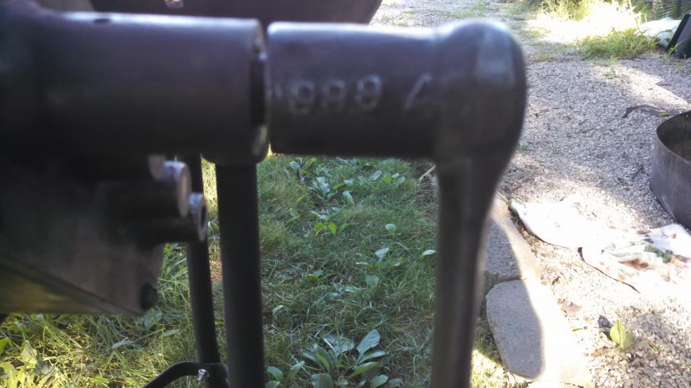

  4. Hope y'all enjoyed. If anyone needs pictures of stampings or numbers for research purposes just let me know. I fired it up today and boy does it blow aor.
  5. I recently picked up an old rivet forge made by Canedy - Otto Mfg Co, usually known for their drill presses and larger blowers. I don't have a lot of info so I hope some of y'all might be able to help. Well I went to work restoring/refurbishing it as well as making upgrade like repairs in the prossess. Here are some pictures of the forge as I got it. The blower does turn but its not smooth and I worry that with every turn it could break a tooth. It's definitely not clean or lubed. Inside the forge is a brake rotor and tongs. The rotor will come into play later. As you can see, its been neglected for quite a while. We'll start with disassembly and wire brushing. It all started off easy, but then there was one stubborn bolt. I cleaned out and cut the slotted head, but it broke one of my flat head bits. So I cut into the back of the bolt, still to no avail. So finally I cut it off with the angle grinder. With a bit of gentle persuasion I got the extension off. As you can see its in pretty bad shape. I continue disassembly with the legs. The hardware was dirty and rusted. A little brush down with a wire brush and some WD-40 got the bolts out. The blower was attached with two bolts. Those came out without incident. Now I get to really clean it. I started brushing it down and found the gearbox had a separation where the lid goes on, so I opened or up. Here is a before and after showing how it is now compared to how gunked up it was. I cut a layer off the rotor so it'd sit more flush to the bottom if the pot. I also cut the pot to fit the rotor. It is so cracked and decayed that I don't feel bad about cutting it to make room. I prepared the metal for welding. As I welded in sections to stress the metal less I disassembled the legs further, wire brushed them, and painted them with rust converter. Put it all back together (plus some spacers under the pot and some new hardware where needed), grease the gears, and you're done! I'll make another post just for all the finished photos.

  8. Oh I'm definitely not trying to fill in the crack, just welding the rotor in enough so I don't have to worry about anything shifting around. I intend to keep the bolts working so I can continue to break it down like it currently is. Its sitting in a corner after I stopped yesterday, it looks sad not put together.

  12. Thanks for the tip. Yeah its pretty bad, but I'm setting a rotor into it so it'll be back up and running. A forge with a working hand crank blower for $75. Crack or no crack, can't beat that.
