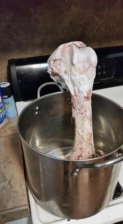

Got a huge beef soup bone for $23 at Kroger today, and some TSP (posphate free version, but still a degreaser and a base.) It looks like something out of a Flintstone cartoon. I'd feel that it was too much cash, but I could easily make 10 or 20 sword handles out of the darn thing it's so big. Trying to figure out how to slice it up to fit one of my stock pot, and I'm going to simmer it for about three hrs with a few tsps (tblsps?) of tsp tommorow. It's a monster.

Giving up on the barley carving, I think "keep it simple, stupid" is a better idea for a first one. Either a variation on rounded rectangle with mld tapers, or add the finger ridges.  Planning to dye it with tea or tobacco, then stabilize, maybe a dark stain on the other pieces for contrast. Here's pics of the bone before and after the TSP boil. (did it outside, btw)
