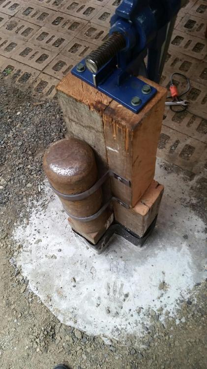

so the combination of being stir crazy, the little lady being tired of waiting on me, and my brother being voluntold to come over and help with another project, We got the concrete poured and of course the posts in the ground. Got a lot of help from my step son and my father in law lent me the use of his power mixer which made the concrete a breeze. Now I've just got to really heal up before I spend to much time on my feet. I was able to walk around without crutches for a bit this evening. but I'm feeling it now and think tomorrow I'm going to be paying for my transgressions. but hey, The posts are set and now it's just a matter of waiting for the concrete to cure before I throw the vise on there and attach the post anvil after figuring out exactly how I plan to attach it. (Thinking two flat stock straps should do nicely.)
Thank you all for the advice and tips. I treated the posts with wet seat roof sealant liberally then wrapped that in landscaping cloth so as to minimize the amount that stuck to those helping with the project.  The three posts were coated and secured to each other then the outside of the all were coated well. and left the bottom untreated.

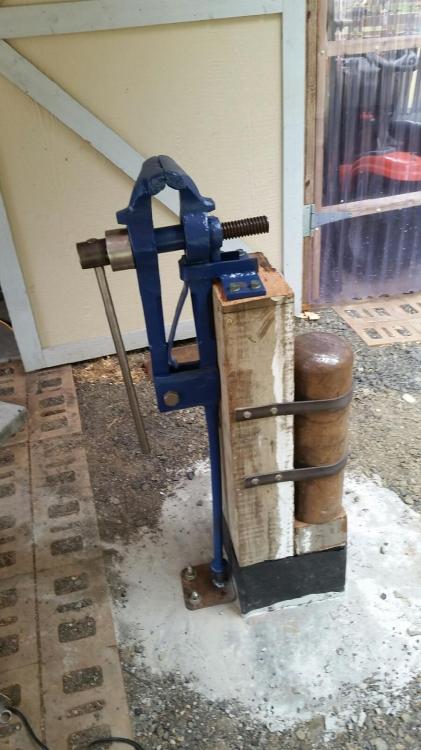

Well they've got me in a walking boot and so I decided to mount the vise on the post. Next I'll make a pedestal for the leg, and mount the post anvil. I set it on the post to check height tonight and tapped it a couple of times to check rebound. That thing rings like a bell. will definitely be putting some caulking under the base and on the straps. I should have the Anvil mounted on Saturday. I'll take pictures then.
Edited by ThorsHammer82
Well She's just about done. Still need to cut and dress the RR track and mount it on the notch. But for all intents and purposes, the mount, the vise, and the Post Anvil are ready for me to find some time to get some coal burning. Just strapping the Post Anvil to the wood securely quieted it down by probably 50% so I decided Not to mess around with the caulk. Let me know what you guys think.

looks good.  I've been thinking of a similar setup.  Thanks for posting the pictures.  Hope the leg is healing.

Why'd you put your post anvil so low and back it up against the post like that?  Those chunks make for great anvils, but setting it against the post will really hamper what you can do with it.
Lets see if it lets me on this computer. It won't at home.
Anyway, Nothing is permanent. And since I've got access to a vast majority of the round anvil I don't see it being an issue. We'll see though.
