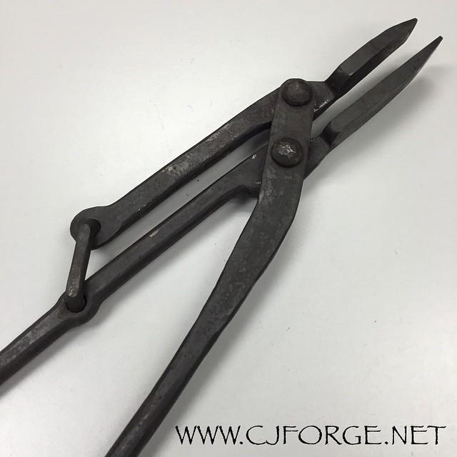

Dogsoldat Posted June 7, 2015 Share Posted June 7, 2015 Poking around trying to find stuff on basket. birdcage twists for handles. Came across these. Just may have to try a set for kicks. Quote Link to comment Share on other sites More sharing options...
HWooldridge Posted June 7, 2015 Share Posted June 7, 2015 Someone's attempt to keep the jaws parallel at multiple widths. Unfortunately, they will not pinch hard like conventional tongs because of the leverage lost in the links. An interesting exercise to be sure and certainly well made, but probably not as "universal" in actual use as one might like. Quote Link to comment Share on other sites More sharing options...
gote Posted June 7, 2015 Share Posted June 7, 2015 I doubt that there is any leverage lost. The geometry will give the same force at the tip as at the outer fulcrum. Gripping thick objects there is a definite increase in pressure excerted by the jaws. I think this will ofset any power lost by friction in the linkage.CheersGöte Quote Link to comment Share on other sites More sharing options...
arftist Posted June 7, 2015 Share Posted June 7, 2015 I doubt that there is any leverage lost. The geometry will give the same force at the tip as at the outer fulcrum. Gripping thick objects there is a definite increase in pressure excerted by the jaws. I think this will ofset any power lost by friction in the linkage.CheersGöteUm, that is only true if you discount the fact that the "universal" tong suffers 3 times as much friction loss at the pivot points. Quote Link to comment Share on other sites More sharing options...
HWooldridge Posted June 7, 2015 Share Posted June 7, 2015 If these were the "cat's meow", you would see them used in more shops. I think it's a great example of forging skill but the practical benefit is not great enough to offset conventional tongs. However, the great thing about being a blacksmith is that you can make a set and see how they work! Quote Link to comment Share on other sites More sharing options...
Frosty Posted June 7, 2015 Share Posted June 7, 2015 They're sure cool and I can see uses for them regular tongs don't do so well but I'll reserve my opinion about how well they work till I try them out.Maybe a little tweaking of the basic idea would turn them into compound lever tongs. Parallel jaws that put a death grip on the work without me having to take a death grip myself might be DE BOMB.Then again it might be more hassle than it's worth. Something to experiment with though.Frosty The Lucky. Quote Link to comment Share on other sites More sharing options...
Richard Furrer Posted June 8, 2015 Share Posted June 8, 2015 Seems like they would grab tapers.Ric Quote Link to comment Share on other sites More sharing options...
Frosty Posted June 8, 2015 Share Posted June 8, 2015 If a person were to put an adjustment screw on the second link they could be custom fitted to any odd shape. They could be made to reach over the head of a RR spike for instance.Frosty The Lucky. Quote Link to comment Share on other sites More sharing options...
gote Posted June 13, 2015 Share Posted June 13, 2015 In "normal" tongs, the gripping force at the jaw is inversely proportional to the distance from the fulcrum to the point of contact with the work piece. In this one, the force is independent of the distance from the fulcrum. The force is the same as if the jaw were as short as the distance between the two pins at the jaw end.In addition to this we have the bend of the moving lever. In the picture it looks like around 20 degrees. If the bend were to be increased to sixty degrees the force exceted by the jaws would double - with a corresponding loss of jaw travel.This loss of jaw travel is the drawback of this design. The distance between the jaws must be very well suited to the work piece because the increase of gripping power is achieved by longer travel by the reins.The force of the gripping is taken up by the two pivots at the jaw end. The other two pivots have only a fraction of the load (about 1/5 ) so the friction there is neligible. The friction in the other two is not more than in normal tongs gripping with the same force.It is an interesting design but the usefulness is severly limited by the requirement that the work piece dimensions fit the jaw distance very closely.Göte Quote Link to comment Share on other sites More sharing options...

monstermetal Posted June 14, 2015 Share Posted June 14, 2015 regardless of how they work, they are a thing of beauty, well made and clever. Id be proud to have a pair on my rack even if they never saw a fire. Quote Link to comment Share on other sites More sharing options...
