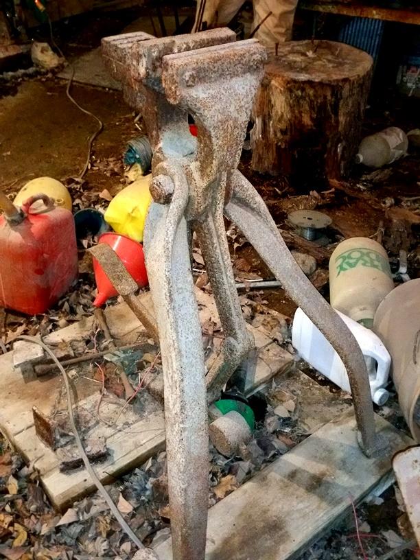

Odd foot vise, anyone recognize?
Anyone recognize this old foot vise?
I had never seen one like this before, and I could find no markings on it.  Some sort of farrier's vise, but any info?

Dunno what it is, but I LIKE.   It looks like something that belongs in Alabama... just sayin.....   :D
Yep, its an odd caulking vice, the block in front for sharpening the caulks gives it away.  Not one of the more versatile designs.  But still very handy for a quick hold on things.  Never seen anything like it, sorry.

That vise is for upsetting/heading. I have one similar but it mounts to a bench. Yours is nicer in that it is free standing. Also, on mine both jaws are replaceable.
Are the parts free?
Edit; Both of your jaws are replaceable. The idea is the you make jaws for specific purposes and swap them out. The foot action is important when upsetting or heading because the iron cools so fast.

It's not mine, it was at a place where I picked up an anvil and I was looking at it.
Everything is free and very nice except for the surface rust.  The owner was even standing on the foot lever with all his weight to show me how strong it was.....  I liked the design, one downside is that it takes up a lot of footprint floor space.  Cool counterweight on the pedal lever opens it up quickly.

Hard to price because they are so uncommon. For a hundred or two I would grab it assuming you have room. I noticed a lot of folks buy rivets but in my strange little market everything has to be hand formed.
He wasn't selling it at the moment, but contemplating it.  I would be interested if he does decide to- It would look great all cleaned up!

Surface rust on something 150 years old doesn't bother me much but I do understand wanting things to look nice.
Jim, not sure about it being called the 'frogopincher', but I'm thinking I'd like to call it mine....  :).
