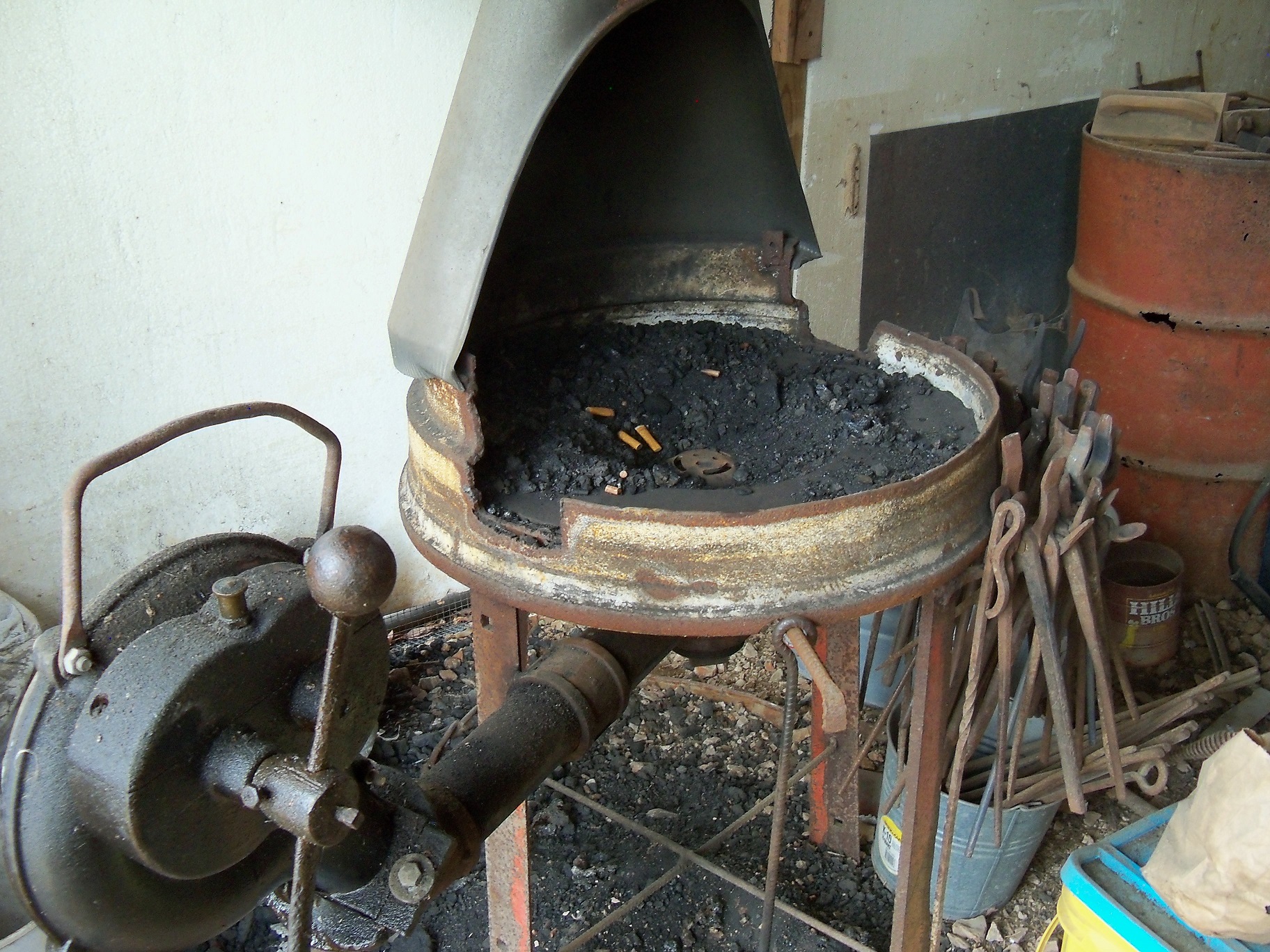

I am just about to build my first forge in 15 years. My last forge was made from an old truck wheel rim. With that in mind, I found an old rim at the side of the road a few years ago and put it aside for a future forge. Now the time is here and I'm not sure if I should use it.
I was reading on the forum how it is better to have a more shallow fire pit in the forge. To that end I have scrounged an old Hibachi BBQ cast in iron, and it seems it would make a fine fire pan on the bottom of my forge.
I have an old oil drum I will cut to the appropriate length to act as a body to hold in clay or cement that I will build up around the fire pan or wheel rim. I also have an old iron table frame to use as a stand for all this and a piece of 1/4 inch steel plate to make a side board/table top beside the forge, on the table frame.
So my question is this. Do I use the wheel rim and make a deeper fire pit (possibly cut down the height of the table legs), or, do I use the BBQ pan and make a more shallow forge.
I am considering doing some casting of aluminum, so the deeper wheel rim might be better for that, but I could build a separate furnace for casting and keep this strictly for forging iron and making tools.
How should I proceed?
In the pix below I show you all the parts, with the wheel rim and the BBQ pan. If I use the wheel rim I would still cut the oil drum and use it to get a bigger area. Perhaps cut the wheel rim in half to lower the profile.
Christopher

In general I would go with the wheel rim. You want a fairly deep fire but need the ability to slide your work piece in horizontally in the reducing part of the fire.
After a few fires you will find the sweet spot of the fireball. Why not cut a slot down the near side of the rim so when the metal hits the bottom of the slot and is horizontal, it is also aligned with the sweet spot? Sure saves tearing up the fire when you insert the metal and dig around to locate the hottest part of the fire.

I think a wheel rim is way more firepot than you want for making wood working tools, even if they're for cabin making. Go to a mechanic's shop and ask if you can have an old brake drum. They usually have to pay to have them hauled off so you may have to resist taking a bunch.

I made a small forge with a wheel rim, it works ok and being mild steel it was easy to weld on a swinging rest for long bars that drops down out of the way when not in use. I think the brake drum would be able to take the heat better if it is cast iron.

Been a few years. I lined it with clay. It's a subsoil found in damp places on my farm.
I made my forge some 30 or so years ago. Semi trailer rim cut down with a manhole cover ring as the table. Fire pot made from fire clay with a commercial grate. Old Champion hand crank blower. Still going strong after all these years.
