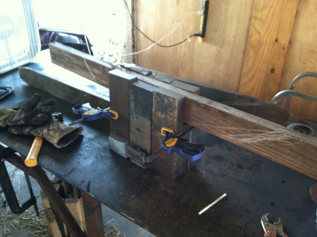

I purchased a pair of fork tines locally for the sum of $75.... Class III 4x1.75x60", by the weight of them, they're a good +150lbs. each guesstimation considering I'm not pot bellied slouch of a man, and they gave me trouble...
I'm going to laminate the tines into a two horned nimba' esque' anvil, of which, I will give a ridiculously stupid name... peanut, bam-bam, bubbles,etc... That way I can giggle when it's referenced in future diy undertakings...

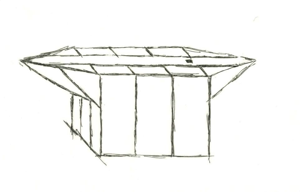

Laminated vertically for optimum awesomeness! Harfaced, twin horned. Hardy, Pritchel..... I'll upload the sketches in a few hours, I need to be cutting... that way the forum can't talk me out of doing something retarded...
Gee whizz that picture sucks... never mind though, won't be forks for long...

^... Sketch up
Dimensions;
Height: 12"
Width: 5 1/4"
Face Length: 12"
Horns: TBD...
Might get mysel another pair of forks to add to the mix, just for the heXX of it.... eventual goal will jive in the same fashion as "the guru's Anvil of Creation", because of his inspirational drawings and how to...

ha ha... photobucket has decided to show you my concept drawing doing a pirouette.... Don't fret, I do not plan on working hot metal in this fashion....
Got rough general dimensions? The width of a typical fork tine is pretty nice for an anvil face.
Phil
the forks are 4x1.75... X 60"... with a 20" or so taper... All of those rectangular like pieces are cut sections of fork laminated together... The center section (including horns) of the anvil, as pictured above, is the only horizontal piece of fork, diagonally slash cut at the ends to make horns...
So in this case, the face of the anvil, not including horns, will be 12"x 5.25"... Not a bad surface area for pounding...

Nice design; a *lot* of work and welding! (especially with all the preheat needed!)
I was thinking you were going to chop the forks and weld them up back to back with the chopped ends ground into the horn shapes---more of a medieval stake anvil form.
The two forks back to back will give a good sized sweet spot.

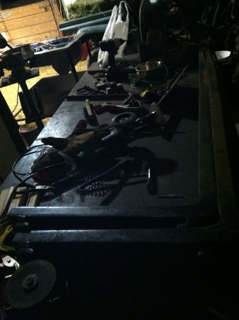

mad idea PPP, i like the more insane plans on here - it certainly looks like a lot of Work of a certain Type, but im So gladdened to hear this is infact your zen - relieved that a) youve found it and B) you are indulging in it :) nice one ! your photo does suck, all i can see is a patch of grass and a plastic carrier bag.. despite this i have every faith that Peanut will be a groovy useable anvil. :)
