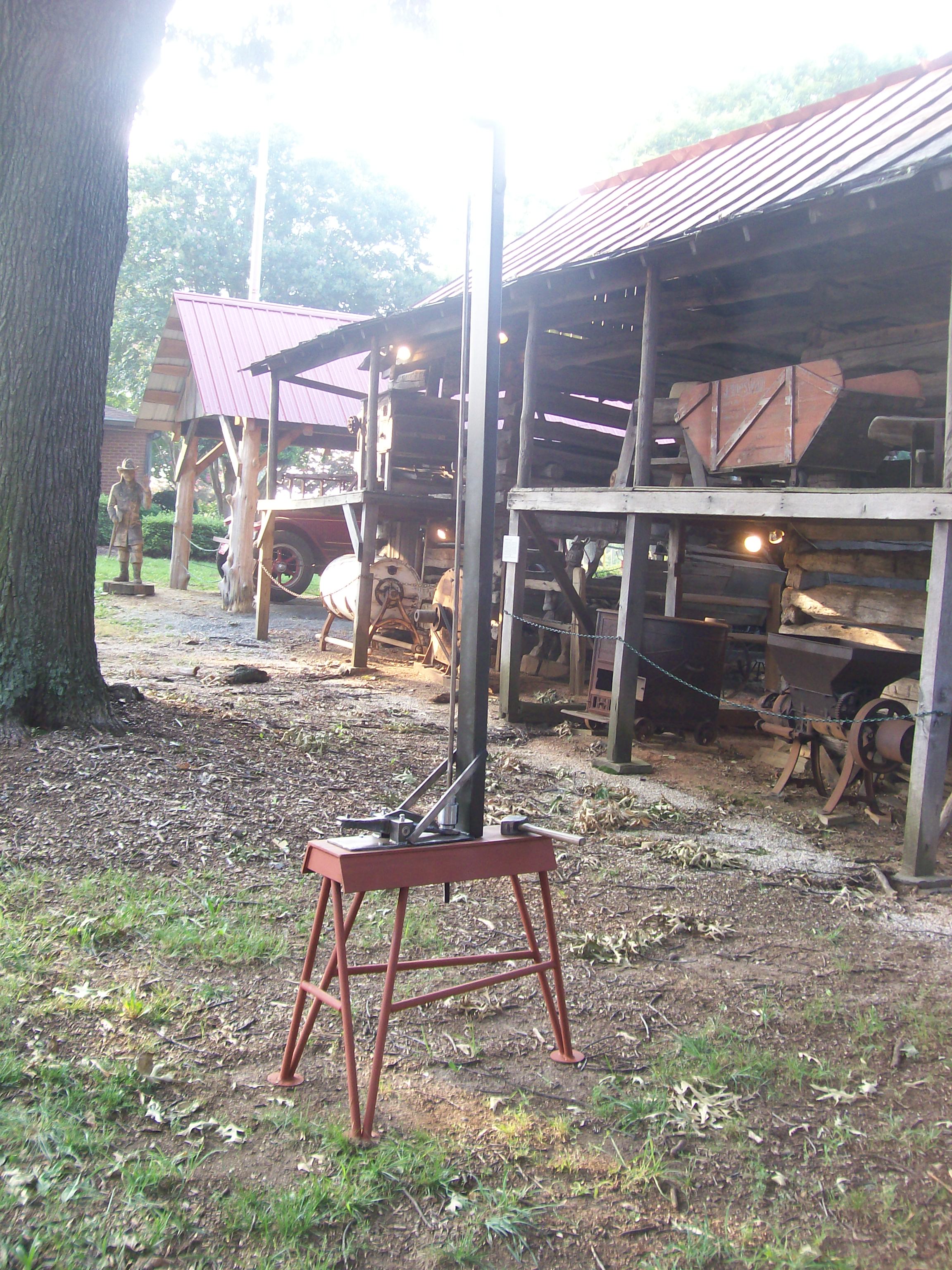

Nakedanvil - Grant Sarver Posted December 10, 2010 Share Posted December 10, 2010 Anderson: Can you post more information and maybe a picture? How tall was your test setup? How heavy was the weight? 1:1 on the lever? Quote Link to comment Share on other sites More sharing options...

Anderson G. Phillips Posted December 11, 2010 Share Posted December 11, 2010 This is the scale mounted to its traveling stand, it can also be mounted in to an anvils hardy hole. The scale is in NC and I will have it with me for the Madison GA meeting next year. It will eather be at the BLU hammer tent or at the NC ABANA tent and we will set up some time for people to try it out. Also here is the original artical.ABOUT THE WATT SCALE.docWhy I Built the Watt Scale.docThe Results So Far.doc Quote Link to comment Share on other sites More sharing options...
oscar C Posted December 11, 2010 Share Posted December 11, 2010 bring your ear plugs to try it :D Quote Link to comment Share on other sites More sharing options...
Ramsberg Posted December 11, 2010 Share Posted December 11, 2010 Hey Anderson, Are you an ex-carnie? HA! The test apparatus looks just like those sledge hammer bell ringing deals. Same principle as a tetertotter that is struck on one side that throws up a weight on the other. Good deal man, I see a lot of useful information coming from duplications of that! With the old steam hammers they found that a really great speed of the hammer effected the "skin" of the work more then the "core". That is why the kept using bigger and bigger hammers instead of using bigger pistons and higher velocities. The same thing goes for knocking together timber frames, the old school method was to use a chunk of a trunk with a handy "handle branch" as a hammer to knock the joints together. Now a lot of people try to use "light" 15 lb sledge hammers swung rapidly and they mainly mar the end of the timber instead of drive it in! All inertia is not created equally! There is also a theory out there that as the speed of light is approached the force that is encountered is an "inertia wave", just like the "sound wave" is the sound barrier, this is a theory that I am fond of. Firebug, The swing is important, before I got into blacksmithing I was into boxing and found that a jab with a tight snap gave just as much force as a wind up punch, I used this when hammering, a quick snap with a loose grip basically throwing the hammer at the stock. I would lightly hold the hammer on the way down, then just before impact whip it and almost let go only starting the pivot of the hammer when the hand was 2/3 to 3/4 of the way through its stroke, like that I could heat up the stock from dull cherry to bright yellow with the hammer. I always believed that this was a very old technique, nothing new. The detrimental leverage of the head of a heavy hammer on a long handle is exactly what gave me the idea for the counterweighted hammer, that way a heavier hammer can be used without the serious and ill effects that build up. Caleb Ramsby Quote Link to comment Share on other sites More sharing options...
Anderson G. Phillips Posted December 11, 2010 Share Posted December 11, 2010 First you ring the bell, then i guess your hammers age and weight. Quote Link to comment Share on other sites More sharing options...
