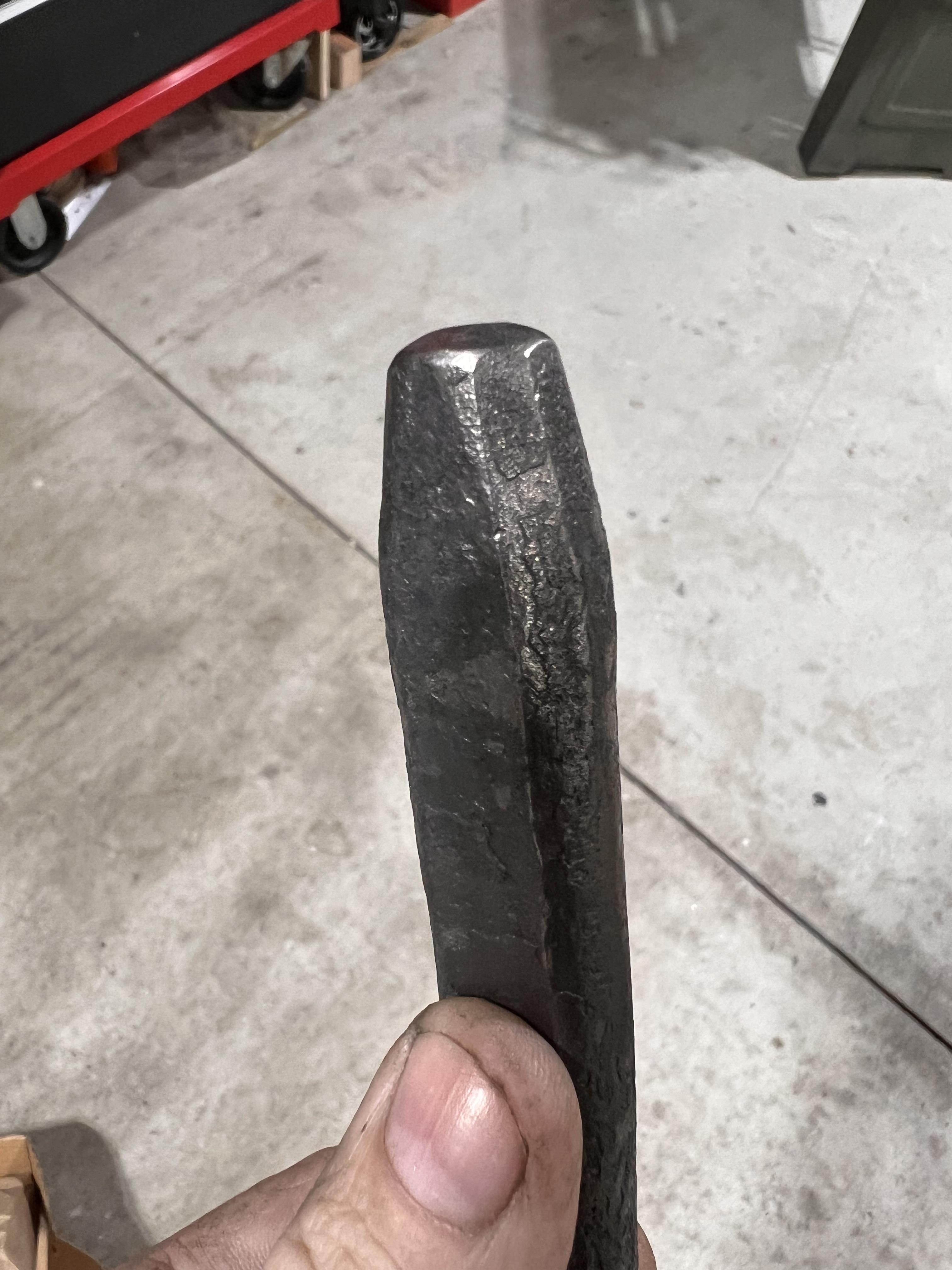

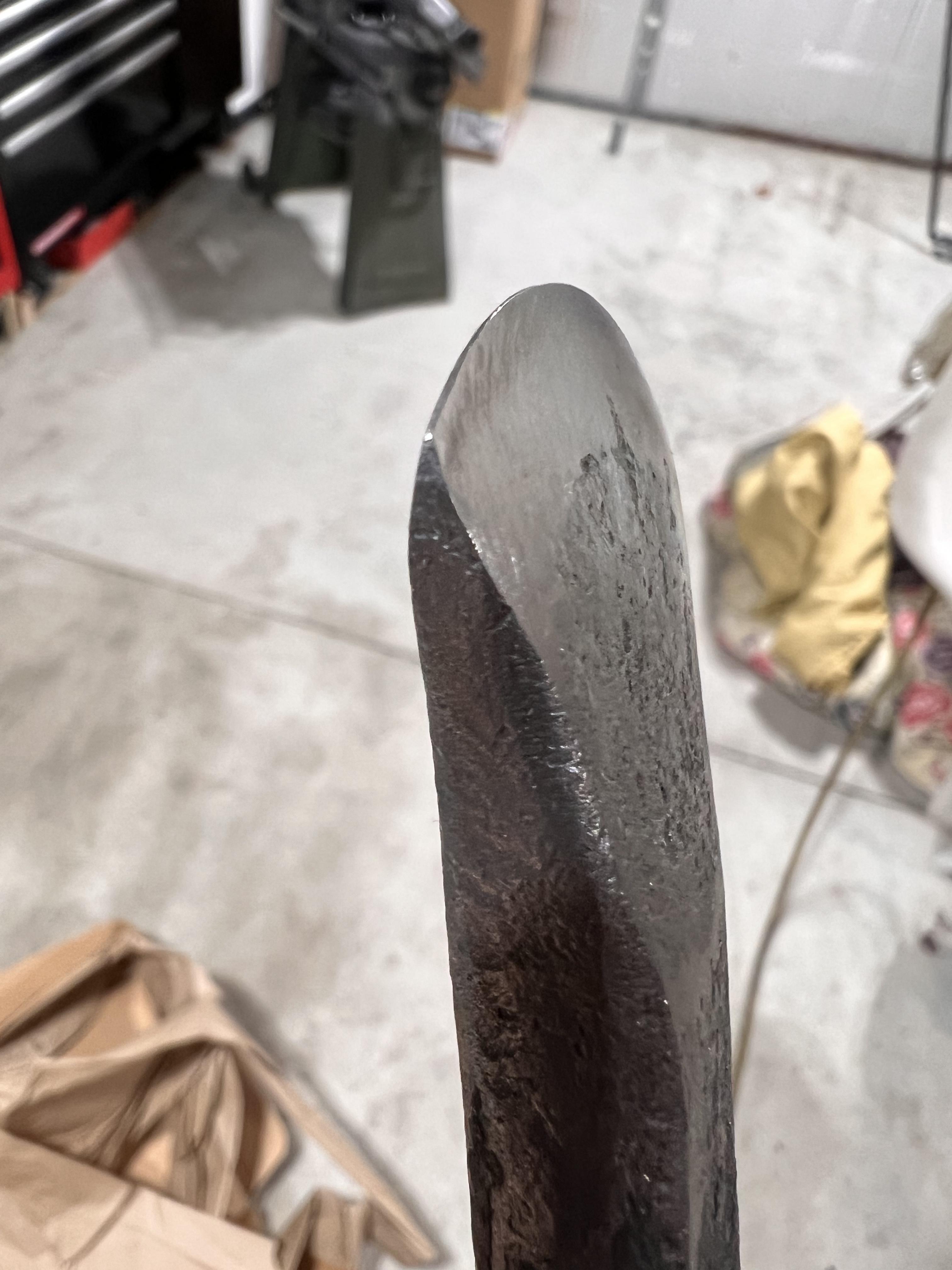

  5. I planned on doing a hardy hot cut but haven’t decided on what shape would work best because I’ve seen it both ways. It would seem easier to cut stock with a straight edge. How wide are they usually? As for having a chisel with a blunt end might be what I end up with due to this being the first time I’ve ever heat treated anything. I made about for cuts into cold 3/4” round and the edge hasn’t changed. Finger crossed I did purchase and use that type of brush but not on every heat. Which I should start doing.

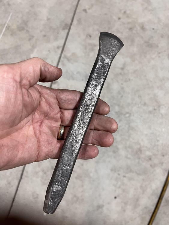

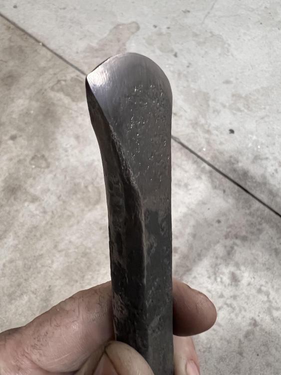

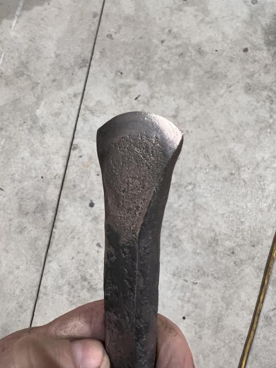

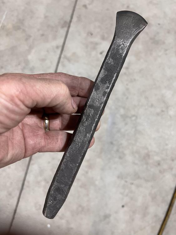

  7. This was made from 3/4” coil spring. Looking for feedback on anything that could be improved on. There is a lot of forge scale on it which I’m not how to remove. I brushed it each time I pulled it out of the but couldn’t remove it all. not sure if the edge if supposed to be completely sharp?
