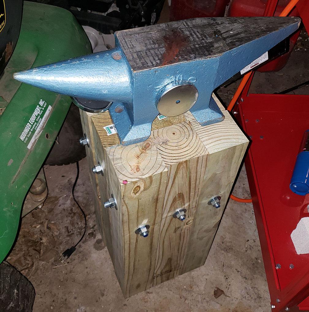

  1. Finally got around to test-fitting the anvil on the stand. Need to shave the bottom of the blocks so they're level. There's about 1/4" - 3/8" difference right now. Not enough to be major, but it does rock a touch. Found a rail spike in my garage and stuck it in the forge, gave it a few whacks to test the height of the anvil. Could stand to go down about an inch, which is perfect for when I level the stand. I also have to drill the other set of holes for the bottom so it matches the top. And the magnets definitely reduce the ring on the anvil to almost zero. I'm sure once I secure it all it'll be nice and "quiet".

  22. Wouldn't the angle iron be overkill or unnecessary? Everything else makes sense, but my brain can't wrap around that part for some reason.
