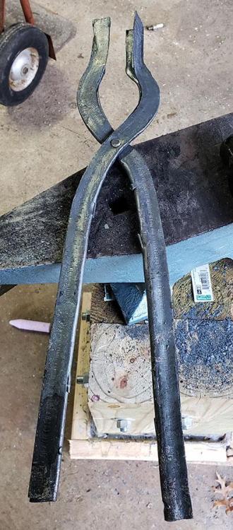

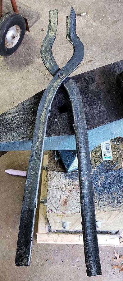

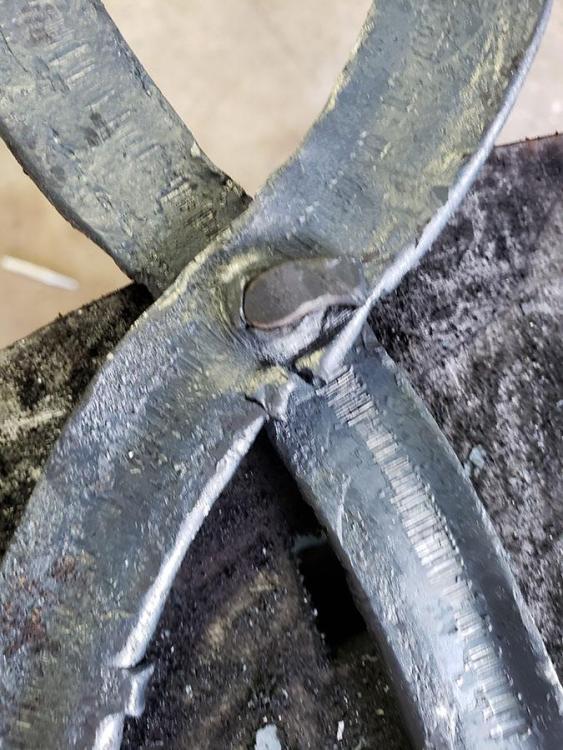

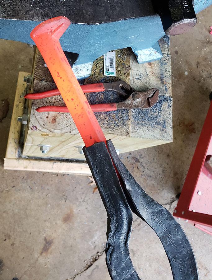

  16. I give you what I'm calling the Fuglies. They're a "special" breed of tongs. They're not pretty, they're surely not comfortable, but they work. Although I did crack one of them. Probably beat it a little too cold, trying to line things up. I made this as a proof of concept. This is from the t-stake I mentioned in another thread. And I cut the rivet too long, so peening it became bending it. Functional. I might take the angle grinder to the jaws just to even them up, and I might try to fold over the reins again to make them a little more comfortable in the hand. But as a first set of tongs, you gotta start somewhere. And if that one crack doesn't cause a self-destruction before I can get a real pair made, I'll consider this a win. Right now, it's on the bubble. Could go either way.

  18. JHCC, that's really really close to what I was planning on doing. The channel in the stake is the reason I thought I could make a quick and dirty pair of bolt tongs out of one of them. The channel for the jaws is already there. I'll definitely give it a go. Like I said, I'm pretty sure I've got a ton of them in the shed, so if I screw it up three or four times I won't be mad that I pooched material I paid for.
  19. They're definitely not new. But they aren't real thick. I stuck one in my forge, brought it up to orange, and was surprised at how easily I was able to flatten it. It moved EXTREMELY easily under a 2lb hammer wielded by a guy who knows squat about smithing. I would probably guesstimate that it's 1/8" thick, tops. My next off day I'll tinker with them some more and report back on any successes or failures.
  20. In the past few days I've been tossing garbage out of my garage to make room for a little workshop. In the corner I found a bucket with some odds and ends, like some conduit pipe and broom handles, things like that. One pair of items caught my eye. They were t-stakes (like this, but not exact, but similar enough to get my point across of what they are. Many many moons ago we used to have a garden, and we had a chicken wire fence to keep bigger critters out. We used the stakes in the garden, probably close to 30 or so. I know for a fact I have more that are in the dilapidated shed in my yard. These are well over 20 years old, probably pushing 30. The questions I have are as follows: - Some of the reading I've done have some of these made with galvanized steel and then powder coated. Is there a way to identify if these happen to fall under that category without sticking one in my forge and waiting for white smoke after the paint burns off? - Would something like this make a passable set of beginner tongs if it's safe to work with? I ask because they've got a channel in them already, so making a pair of bolt tongs wouldn't require more than bending the steel between jaw and boss, flattening for the boss and reins, and punching for the rivet. I think. Unless I'm in the wrong frame of mind. These could then be used to make "real" tongs, as I'm pretty sure they're not going to be too comfortable for extended use due to the nature of the bend, and trying to fold it onto itself isn't going to be a key to longevity. I'm probably WAY out in left field with this line of thinking, but I just saw those two stakes and the idea hit me. I wanted to get the valuable input of those who might have tried this before.
