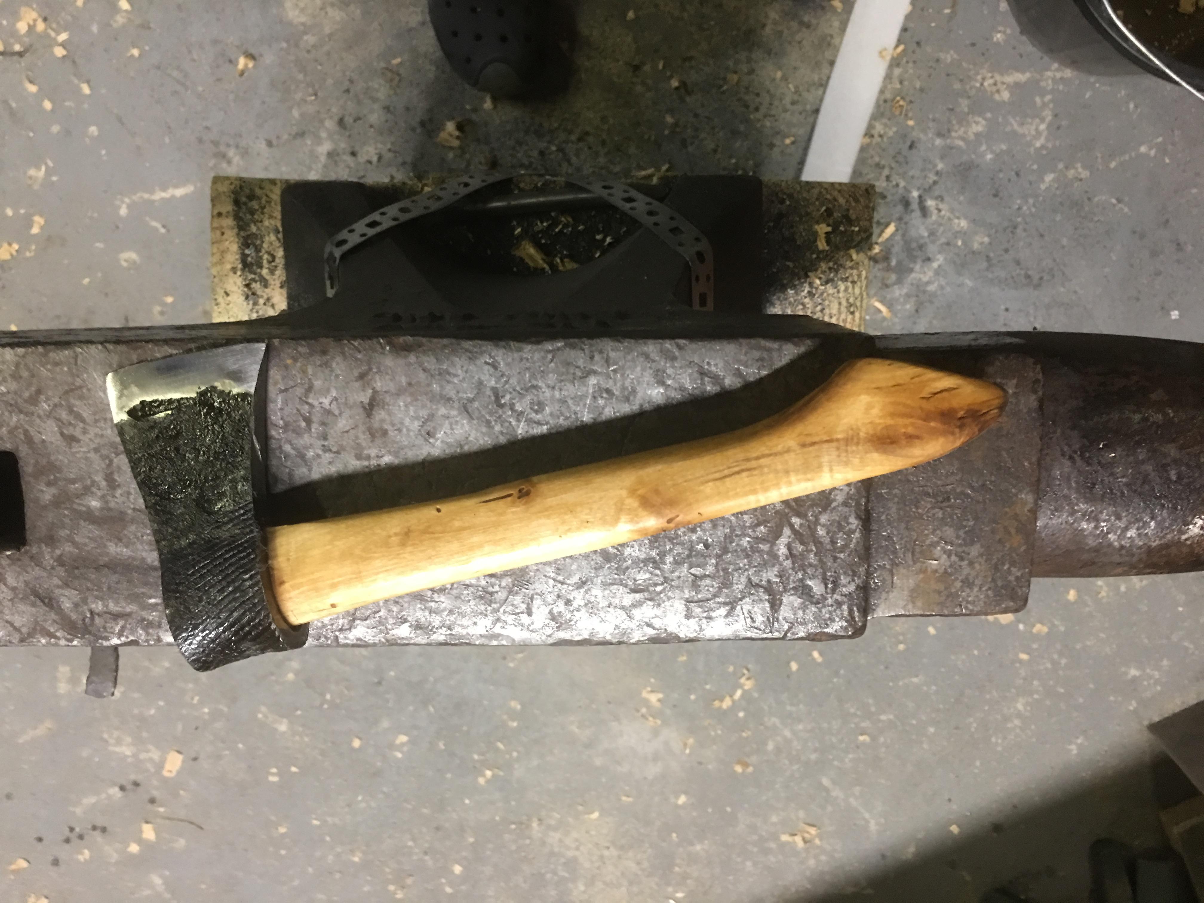

  3. Thought I’d make a little axe for no reason other than my own amusement. About half of a farrier’s rasp and a stick I picked off the forest floor last summer. Finished with raw linseed oil. I mowed the lawn too - no goats to help.
