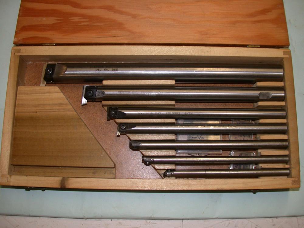

    Carbide does not work in regular holders? Nobody told me. Look close and you will see a mix of HSS and Carbide. HSS grinding today is exactly the same as shown in the old South Bend book. More HSS bits as used in boring bars:
