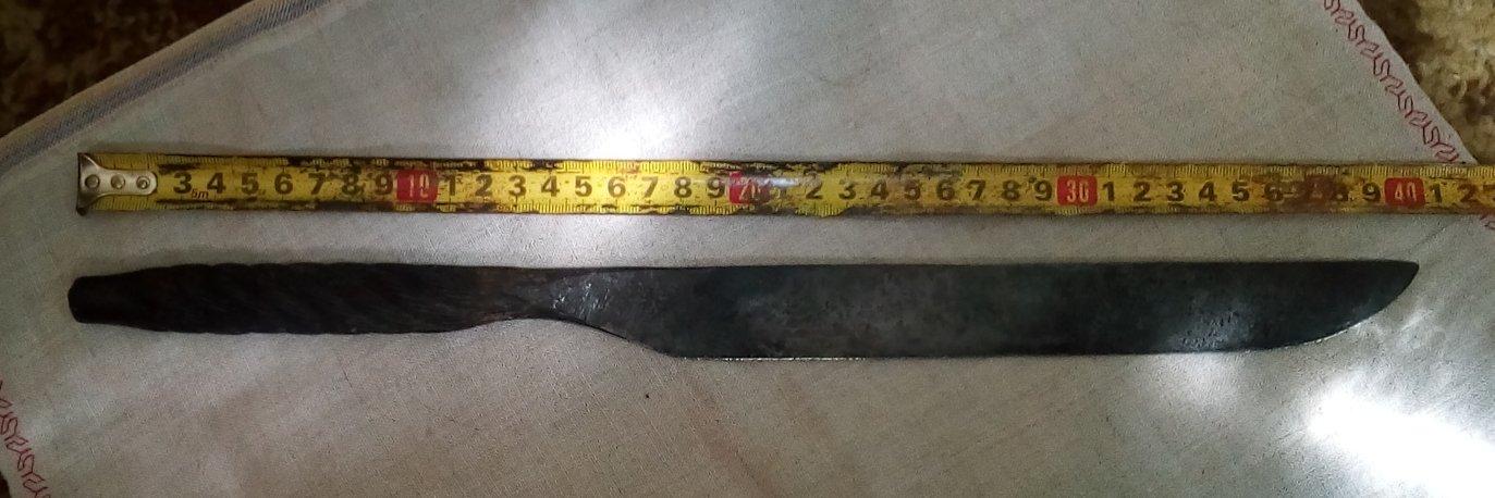

  2. May be it will be usefull idea. You need only hairfan, box, metal pipe 1" or little more, some clay. I forge outdoor because have not exhaust pipe, and dont want to broke roof.
  3. My shop made in old shed (or barn) in Boyarka near Kyiv, Ukraine
  4. Coals must be fresh? "old" coals (that fire some minutes) can make oxidizing flame?
  5. Mister Thomas! Do I must put cable inside white colour glowing maximum heat coals? 10X10X10 cm to 15X15X15/ Maximum heat area? Or just put near it? I will try now.
  6. I have no possibility to get lessons with teacher. ((((
  7. Can someone draw a sketch of relative position of tuyer, thickness of coals layer, cable, coals from above cable? I read many posts about oxidizing/reducing flames but cant understand how steel can get hot enough to weld out of hottest part of fire. I use selfmade charcoal. Excuse my English. Thank You!
