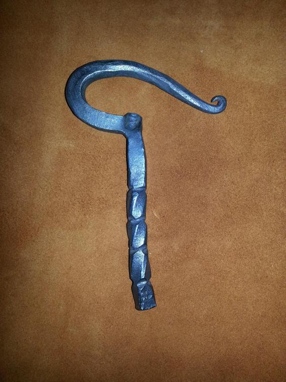

  10. I have only been smithing for around 3 months and I finally got around to making a bottle opener! My last name is Patton so i made it in the shape of a P (or I tried)
