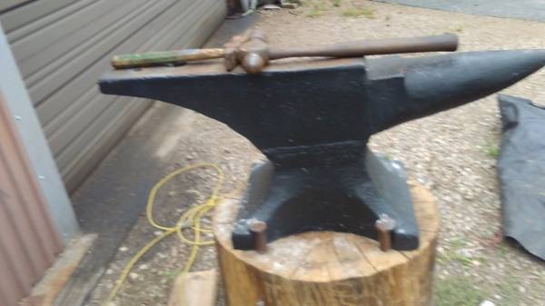

  9. Will welding a stand to an anvil cause any issues to the anvil? Picked up these 2 Peter Wrights and the smaller 130lb. is welded to the stand. Plan on using the 152lb. until I find a larger shop anvil but couldn't pass the pair for the price. The welded anvil is much quieter and I'll leave it welded, adding a brace or 2, if its not an issue otherwise I'll cut it off. Never used any other stand than a stump and chain so this is beyond my limited experience. Doesn't seem like it would be an issue but I don't know, I do like how quiet it is though.

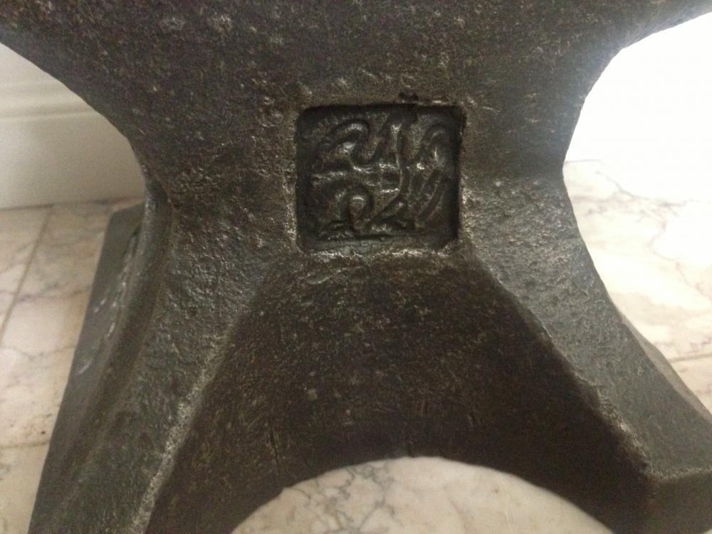

  22. Just set it in to show the hole size. Not sure if she'll see use or not. I have a slightly larger Peter Wright I'm using now, but I'm searching for a shop size anvil, something around 200 lbs. or more.

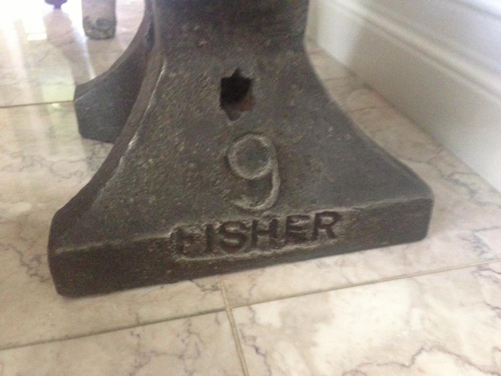

  23. I bought this one for a conversation piece. 90 lb. Fisher from 1885. I think she'd clean up nice if I decided to put her to use.
