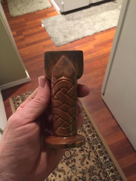

  10. Oberu replied to Oberu's topic in Knife Making
    One of the handles carved up. Slow but going!
