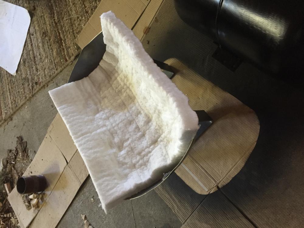

  2. Update: I'm working a lot lately and don't have much time to tinker but I'm trying to document what I'm doing. If you lot like it or have suggestions let me know. I'd like to possibly make a picture heavy build along so possibly what I'm learning might help others. Let me know how you feel about it and what you think I should change. Body is finished and the ceramic blanket goes in. I've got my kiln shelf cut and fitted. The excess blanket hanging out gets trimmed off and the lower half ends up being flat across. Starting to lay in the castable refractory. I took this picture after I'd trowled the mizzou on and afterwards I used a drill with a pieces of bar bent into a 90 to create a "shaker" to bump out the bubbles. The upper portion of the body needs to be rotated so the surface tension of the refractory keeps it inside the lip of the shell. It gets rotated after a flat portion is set so I can fill in the rest of the arc by rotating the top half bit by bit. Next up.. a final layer of sifted refractory so it's finer and then off to the the IR coating
  3. I'm not sure where else to post this and I've made so many posts now that in hindsight seem pretty dumb so I'll just clump it up into this one. I'd love some advice on the opening where my burner comes into the chamber through the mizzou castable. I'm planning on using some of Frosty's advice and I've welded my burner holdfast aiming to a tangental angle where it will form a swirl. I'm not sure how to shape this. My insight tells me to round things out as sharp bits will be thin and wear off quickly. I plan on covering even the blanket in castable where my burner comes through. My plan, as it sits, is to spread the opening a bit making a very slight conical opening with soft round edges. If anyone has any sort of advice I'd be stoked. I'm close but I want to make this thing right.
