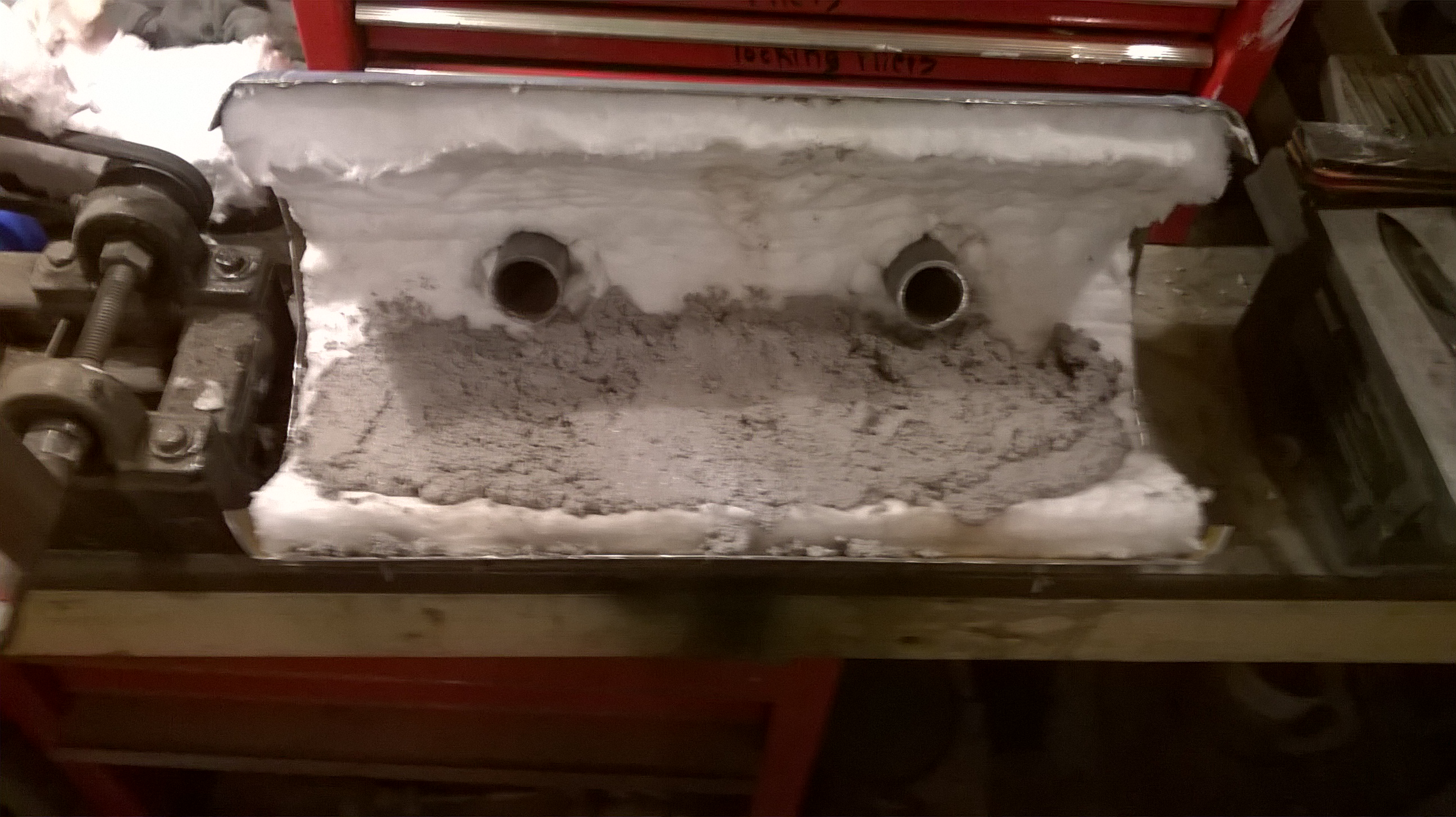

As unpleasant as it was, I cut out the original, 6", burner mounting tubes. i replaced them with 3" tubes that just barely stick through the outer, metal shell. I then applied the last coat of Kast-O-Lite, and sealed around the holes where I shortened the pipes. I am also attaching a picture of my current forge that I have been using for a year now to harden steel. -

I will cut the welds on the mounting tubes so i can pull them out some and remount correctly. I assume the inswool that will be exposed after pulling those mounting tubes out some, will have to be covered with Kast-o-lite. -

By the time I finish the second coat of Kast-o-lite, the burner mounting tubes will be sticking through the lining, into the chamber about 1/2". Is that too much? Should I cut the ends of the tubes off even with the liner on the chamber side? If I am understanding, over-heating the ends of the burner and mounting tubes is one of the problems? The mounting tubes are about 1/2" larger in diameter than the burner tubes, I will be able to adjust the angle slightly, but not much. I will have to try it and see how it does. Thanks for the info Frosty, let me know if I should cut the tubes off even. It may be easier to grind the welds on the outer shell and pull them back out some. -

They are at about the 1:00 position and angled to the other side, kinda toward the 7:00 position. Hope that makes sense. -

Thanks! I made this one long with the two burners so I can harden longer blades. I am using the 3/4" T burners also, I hope it all works like I want it to. -

I don't have a clue about the cubic inches for sure. If I am cipherin' right, it is around 200. The bottom, or base in the picture is 9" wide by 18" long. Yes, I am built like a bull. LOL!! I am a knife maker, and want to be able to work with longer stock. It also has a pass through design. I am assuming I can maybe plop a fire brick in from the back, to take up some cubes, and shut off the back burner if not needed. We'll have to see how that will work. The lining will be 2" inswool around the top, 4" in the base/bottom. (Even though Wayne suggested 1" top and 2" bottom. I tend to over do everything.) The inswool will have a 1/2" coating of Kast-o-lite, and a final coating of metrikote reflective. -
