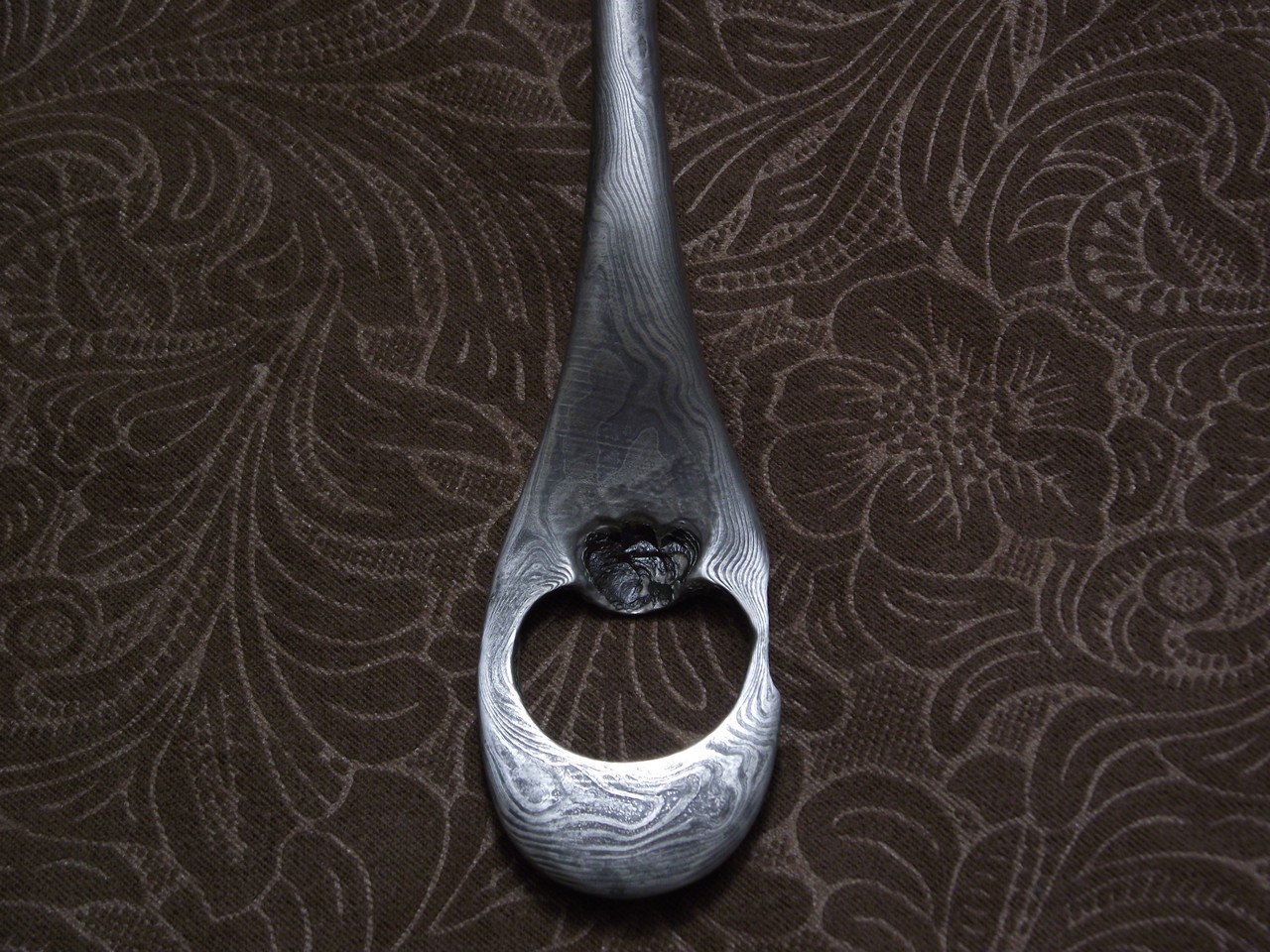

Show me your Bottle Openers!
bobasaurus replied to Arbalist's topic in Blacksmithing, General Discussion
I made this damascus bottle opener from a bandsaw blade and pallet strapping. It was my first attempt at pattern welding layered steel, and went pretty smoothly. It got a little thin on one side, but seems to hold up in use. The strapping is mild steel. The old bandsaw blade could have been a number of things, possibly 15N20, but the etch didn't bring out much contrast so I suspect a different steel. I included a picture of it pre-etch, just because it was so nice and shiny. Maybe it's better to start at a coarser grit for etching though? -
Looks great, I might have to try making one. Was all the steel from the spike originally, or did you have to weld on extra? Seems like a lot to draw out from a single spike.
