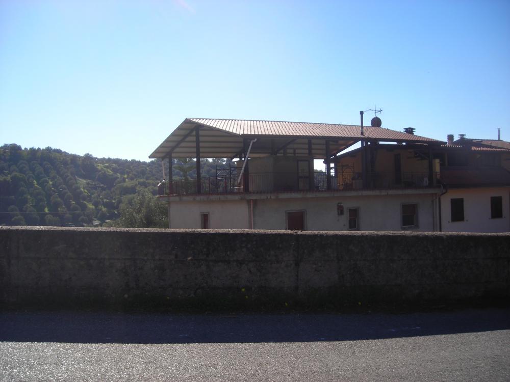

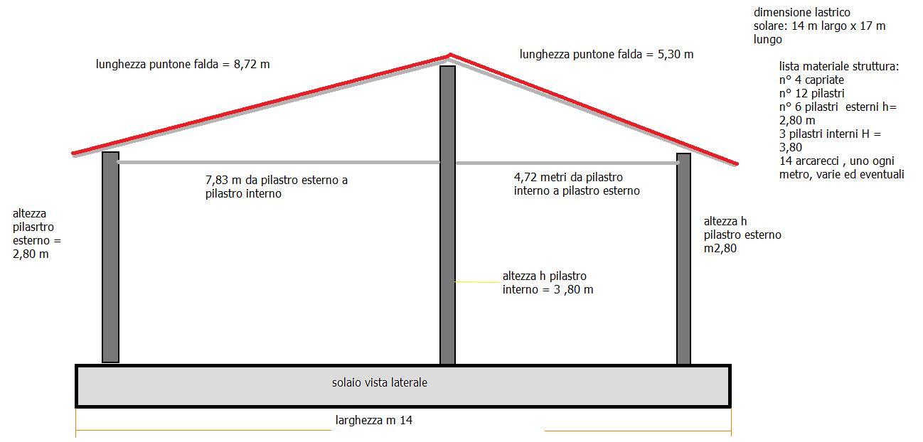

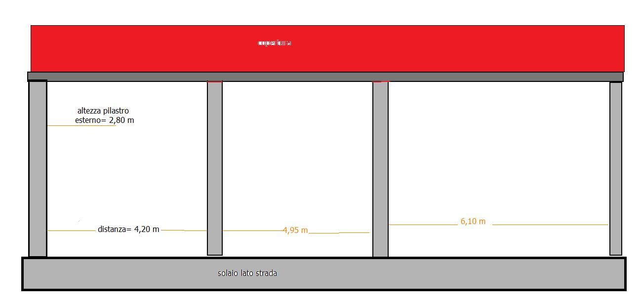

building a roof with metal frame and roof insulated type "attic" constructive advice
hello, I know I should appeal to a technical, engineer, architect, surveyor or structural engineer or higher, but I should make a cost estimate what you think? http://www.cad3d.it/forum1/attachment.php?attachmentid=44416&d=1467874497&thumb=1 http://www.cad3d.it/forum1/attachment.php?attachmentid=44416&d=1467874497&thumb=1 http://www.cad3d.it/forum1/attachment.php?attachmentid=44418&d=1467874954&thumb=1 ho anche fatto i conti della massaio, in linea di massima se manca qualche cosa ti invito a sottolinearmeloElenco materiali:1) N°6 pilastri esterni h= 2,80+ 3 pilastri interni 3,80 hea 1206x2,80= 16,8 m 3,80x3 =11,4 mTotale 11,4+16,8 = 28,2 metri x 19,9= 561kg pesoCapriata:14,02x n° 4 = 56 metri ipe 12056x10,04 kg/m= 582,4 kgArcherecci correnti = sezione 50x30x 1,5 mm17 m x 14 pezzi = 238 metri238x 4,27kg/m= 1016,26 kgCatene di controspinta14 metri x 4 pezzi= 48,4 metriProfilato ad U 100x50 = 10,6 kg m48,4x10,6 kg /m =513,04 kgTotale kg=2672,88 kg I also did the accounts of the steward, in principle, it lacks something I encourage you to sottolinearmelo Materials List: 1) # 6 external pillars h = 3 2,80+ inner pillars 120 3.80 hea 6x2,80 = 16.8 m 3,80x3 = 11.4 m Total 11.4 + 16.8 = 28.2 meters x 19.9 = 561kg weight truss: 14,02x No. 4 = 56 meters ipe 120 56x10,04 kg / m = 582.4 kg current Archerecci section = 50x30x 1.5 mm 17 m x 14 pieces = 238 meters 238x 4,27kg / m = 1016.26 kg Chains of counterforce 14 meters x 4 pieces = 48.4 meters U section 100x50 = 10.6 kg m 48,4x10,6 kg / m = 513.04 kg Total kg = 2672.88 kg what do you think, how you costruireste empirically, what do you think, where I went wrong thanks for your attention and technical advice http://www.cad3d.it/forum1/attachment.php?attachmentid=44432&d=1467907582
