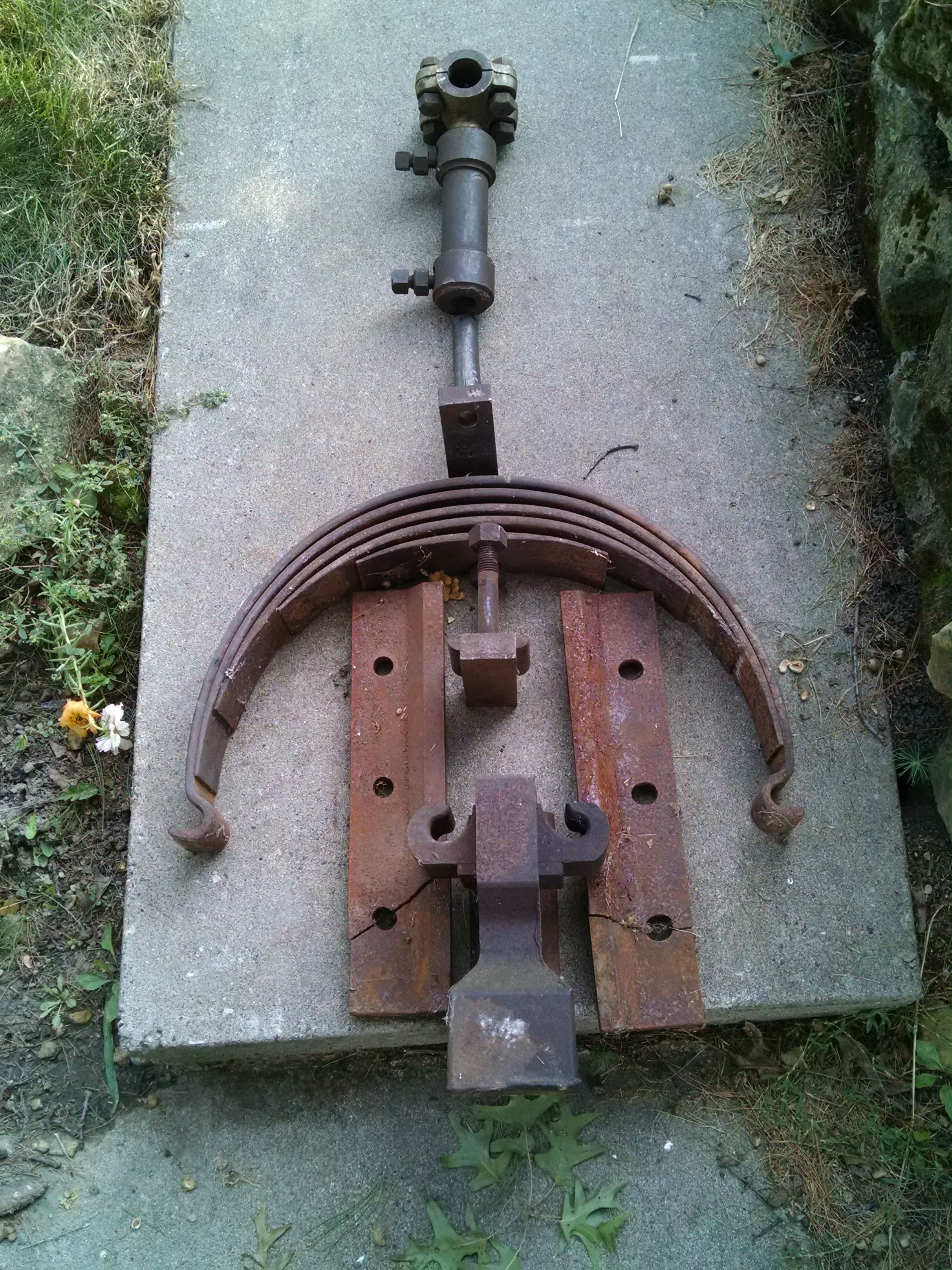

No idea how old it is. I think W&W is still in business, but they don't have records from their hammer building days. When you get it off the trailer post more photos and measurements please. There are lot of ways to do a motor mount. Look at Little Giants center clutch models. I've made a motor mount single piece of heavy pipe up the back of a 50lb LG to place the motor directly overhead, made u bolt/straps to clamp the pipe on. You can go of the side of your machine, and if you get creative you might not even have to dill into the frame. On my Bradley I made a motor mount the bolts onto the foundation bolt hole in the base. Not the best photo and a different situation, but this attaches to the two 1"foundation bolts and hold a 5hp motor and jack shaft for the slip belt system.
Guides likely cast iron maybe flip upside down and bolt steel flat bars over the top, that photo is from a smaller hammer 35 or 55lb. That's most of the info I have if I find anything new I'll send it to you. The pulley and fly wheel look a little smaller on your hammer I wounder if yours matches the diameter in the specs. As far as leaf springs hitting harder, I think it might have more to do with the length of the horizontal toggle arms rather than type of spring. Leaf spring hammers look like they have longer toggles.

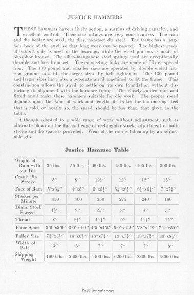

On the left hand side, I'll see if I can find a photo. Does the hammer say 100lbs on it anywhere? My info shows 90lbs being the largest size one piece that W&W made. The guides seem to be a weak point, I've seen 3 hammers, 2 have had broken guides. If you look at my photo the casting around the bottom of the guides is slightly different.
My info says 4400lbs and 350 bpm. See what the smallest pulley you can get for your shaft size and do the math.
