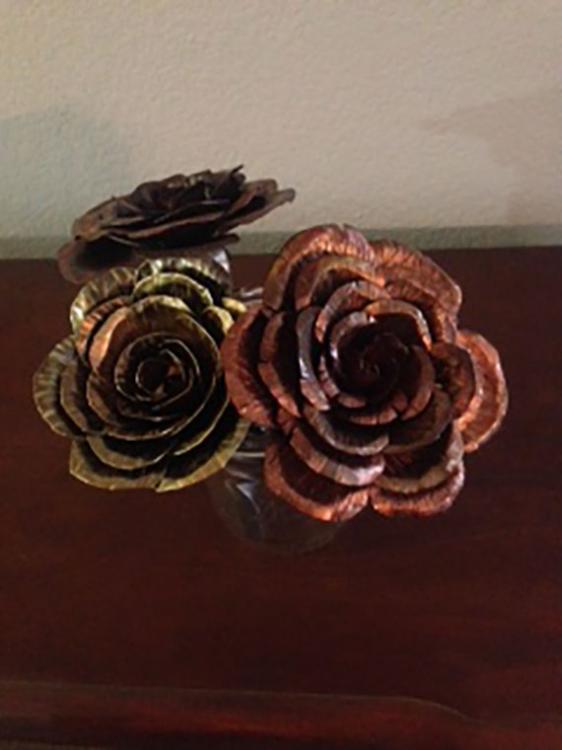

  1. If you use .016 copper there is no need to heat in your forge. you can texture them cold and put them on the stem. when you tighten the fastener start at the center petals and shape with needle nose pliers. when its all shaped how you like it you can apply SLOW heat to change the color of the copper to taste. a shot of clear coat will make them look really nice too.

  5. Please let my know what yall think of these.. I use copper, brass, and tin sheets mounted on 3/8's square bar. Thank You
