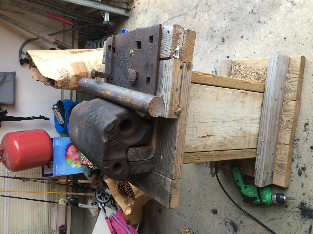

  15. My brother-in-law says he can do the 9" portion of 1 3/4" at his work. I'm still going to explore the VoTech angle. May end up with a hybrid machining/forging approach. I appreciate any tips/tricks I can get...theoretical or otherwise.
  16. Would a mig welder be capable of performing this weld. My brother-in-law does welding for a living and fun. Would you weld the cone side as well?
  17. Frosty Is either of these transitions at the back of the horn section what you were referring to when you say shoulder? Also if I'm able to get it machined would I want to find a bolt before hand or just provide some spec for the threaded end. Thanks
  18. I seems to me expansion would be most drastic along the length of the bar but do you think it would be an issue in pushing the tenon through the hole. Do you know if this part is cast and whether there's a potential of cracking it if it cools to tight.
  19. Thomas and Frosty I think given the 8 inches through the body of the coupler + maybe an inch of overhanging material on the working end leaves me 9 inches of material I need to shape. If I go the machining route I the length won't change. How would you suggest breaking down the remainder. Meaning how much of an end should I leave in the back to peen. What kind of slope/taper should I have. how small should the tip be for working small objects like bottle openers and hooks without being a hazard to get impaled on. Thanks for your help. Sorry for the flood of questions.

  21. I bought a piece of 2" x 18" long hot rolled mild steel rod to use create a horn for my railcar coupler anvil. The attached picture was an earlier picture before I finished up the stand. The bigger hole in the coupler is approx 1 3/4". The length the hole passes through the coupler is 8". Being hot rolled my understanding is that the rod will likely be a bit over 2" OD. So I'm looking for suggestions on what the best way of getting a horn shaped and mounted in the coupler. I'm mainly going to use the thick portion for working on hooks and things like that. The cone portion for bottle openers and opening up curves that got closed up to much. 1.) Shaping the horn. I imagine a day with an angle grinder and a stack of grinding wheels and flap disk might create the cone section. I'd be losing material that way though. I might be able to get some help from one of the professional smiths and a power hammer at our forge meetings. I wouldn't be losing material that way. This is a cheap-o project (other than time) but just to throw it out there how long would it take someone in a machine shot with a metal lathe to kick something like that out and would it be prohibitively expensive? 2.) Reducing portion passing through coupler. Again always have the grinding wheel options. To reduce on a power hammer do you have to have a sizing block to stop the hammer at the desired size? Does this sort of operation lend itself to having an end product that would slide into a set size hole or am I asking for a level of precision thats unrealistic. 3.) Mounting to coupler. Should I just forget about grinding down the pass through portion and just strap it down beside the railroad coupler? Leave it loose-ish just slid into the hole? Use some sort of caulk. I seem to recall posts about Brian Brazeal's thick plate anvils getting mounted using some sort of silicon caulk. I would imagine epoxy would be too brittle. Have an inch or so extra out the other end, heat up, and peen over like a big honkin rivet? Thanks in advance for your help. I can get better pictures of everything when I get home tonight.
