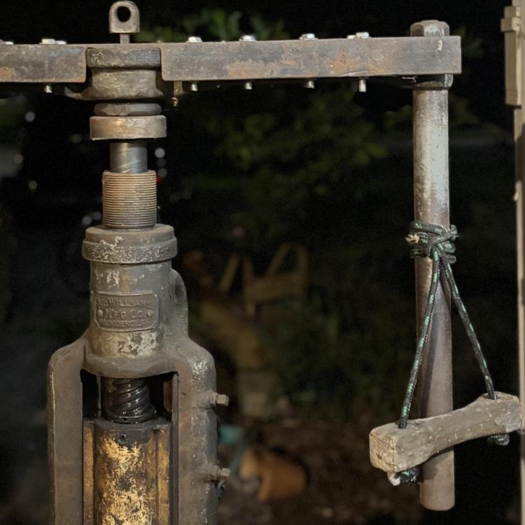

I ran into the same golfer's elbow problem myself, which I addressed by adding a handle on a rope loop to the handle of the press. Because this is free to rotate with the natural movement of the wrist, elbow, and shoulder, you don't get the same issues caused by forcing those joints into less natural positions. I'll see if I can dig up a photo or take one when I get home from work.

JHCC, I would appreciate a picture of your setup. The pneumatic cylinder idea is one to consider.

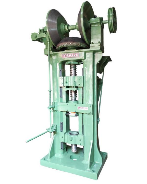

I remember seeing drawings of a mechanical drive. There was a horizontal shaft centered above the flywheel, with rollers at both ends. The shaft could be pivoted so that the rollers contacted opposite sides of the flywheel, thus driving it in opposite directions (not at the same time of course).
The biggest challenge might be allowing for the vertical travel of the flywheel — I can’t remember how that was done.
Grant had a thread about his “friction screw press”, from which the photos are now gone. Here’s a photo of one from the web:

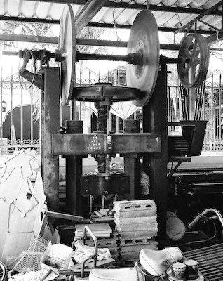

Cool.  This one is a little closer to what I was remembering (more obviously a flypress).
Looking at the picture I posted, it seems like a pretty clever design.  As the flywheel moved down (and accelerated) the "gear" ratio would increase.  Of course, bringing it back up would be like starting out slipping the clutch in fourth and then shifting down through the gears to first as you accelerated.  But it wouldn't matter as much then.
True, it is an infinite variability torque converter transmission. Very similar to the transmission in a snowmachine. (snowmobile for non-Alaskans)
This type transmission elegant in it's simplicity, efficiency and reliability, probably why it's been in use for at least a millennia.

When I was with Grant, he showed me that he had leather as the friction material, on both inner faces. The top shaft shifts sideways, to pick up the motion of the other direction. When he pushed down, the shaft shifted in the down direction. When it bottomed out, the impact would shift the top shaft and the inside face of the flywheel would lift the Top Die off the Work. Etc.. Etc...

Here you go. The wooden handle is attached to the press’s handle with a loop of rope tied with a prusik knot, which allows for easy repositioning.

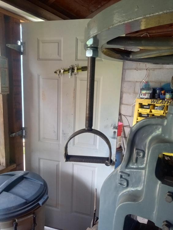

Thanks for the photo. Here's what I came up with and it works for me, pushing or pulling.IMG_20250607_083702736_HDR.thumb.jpg.5d06860390ccd65061afb2248e19446d.jpg
