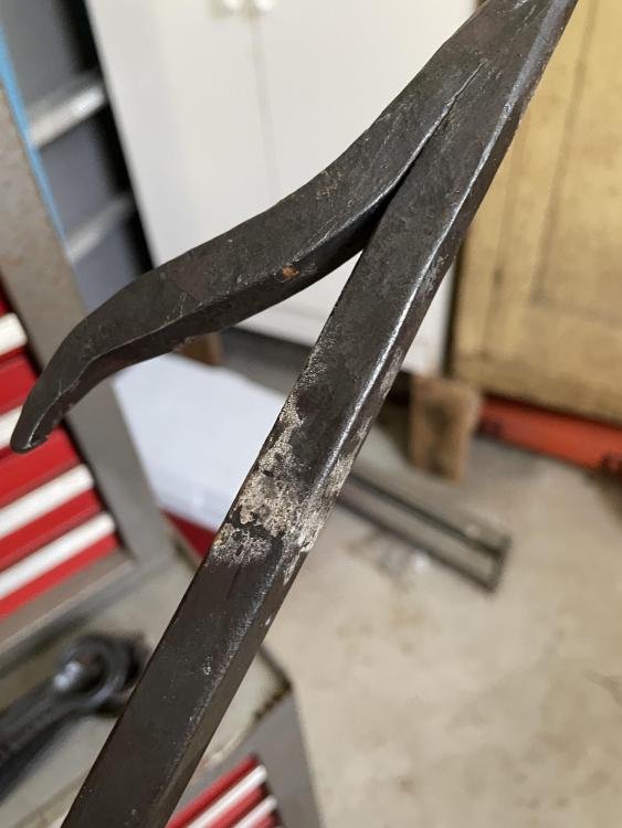

Borax shows up days later
I've had it show up at or close to the weld site, say where your poker is forged into contact before the weld but not that far away. If you haven't waxed, oiled, etc. it soaking in water will dissolve the borax but it it's trapped between the point and hook you might have to wedge them apart slightly to allow the water access. Heating up a little will make it dissolve better too. A little above boiling won't effect the steel but when you put it in water capillary action will draw water into any space large enough for water molecules. Re warming it will drive the water back out. A couple few repeats might be necessary.
Lastly, how much borax did you use?
I use vinegar to neutralize borax residue before applying a finish. I just brush it on and let it sit "a while" then rinse with water.

Try using Garden Lime instead of Borax. It works a treat.
Neil
Are you using just regular old Borax? Or are you cooking it? I have found that since i have started using anhydrous borax it is no where near as messy and do not have to use but a small pinch. I took a sauce pan from the kitchen, do not tell the wife:ph34r:, put about a cup of borax in it on my fire until it all melts, pour it onto a tray to cool. Then pound it into a powder. Oh, and do not try and make sauce in the pan later, hide it from the wife in the shop somewhere.
Since i have started using it i have only had 1 failed weld in the past 6 months also.
Next time, go to a welding supply (not a big box hardware) and buy a can of powdered welding / brazing flux, they are anhydrous borax, boric acid and some color for brand recognition. Last can I bought was $26 but that's a couple decades ago, "Petersons" WITHOUT the powdered iron. Keep the can or container closed or it won't be anhydrous very long.
It doesn't take much flux, even 20 muleteam. Flux isn't glue it's just there to prevent oxidization of the joint surfaces and if you don't clean them, carry scale and dirt out of the joint.
Brush, sand, file, etc. and flux LIGHTLY the joint faces BEFORE you wire, tack weld, etc. the joint together. Fluxing the outside doesn't hurt but don't wait till it's at orange heat. Orange heat is where iron / steel, oxidize rapidly, on contact with air in fact so waiting till it's oxidized before fluxing is contraindicated. Warm it till a little bit of flux on the surface melts, THEN flux the outside of the billet. Oxidization will be minimized and protection maximized.
Your flux doesn't need to squirt dirt and scale out of the joint if there isn't any. No?
