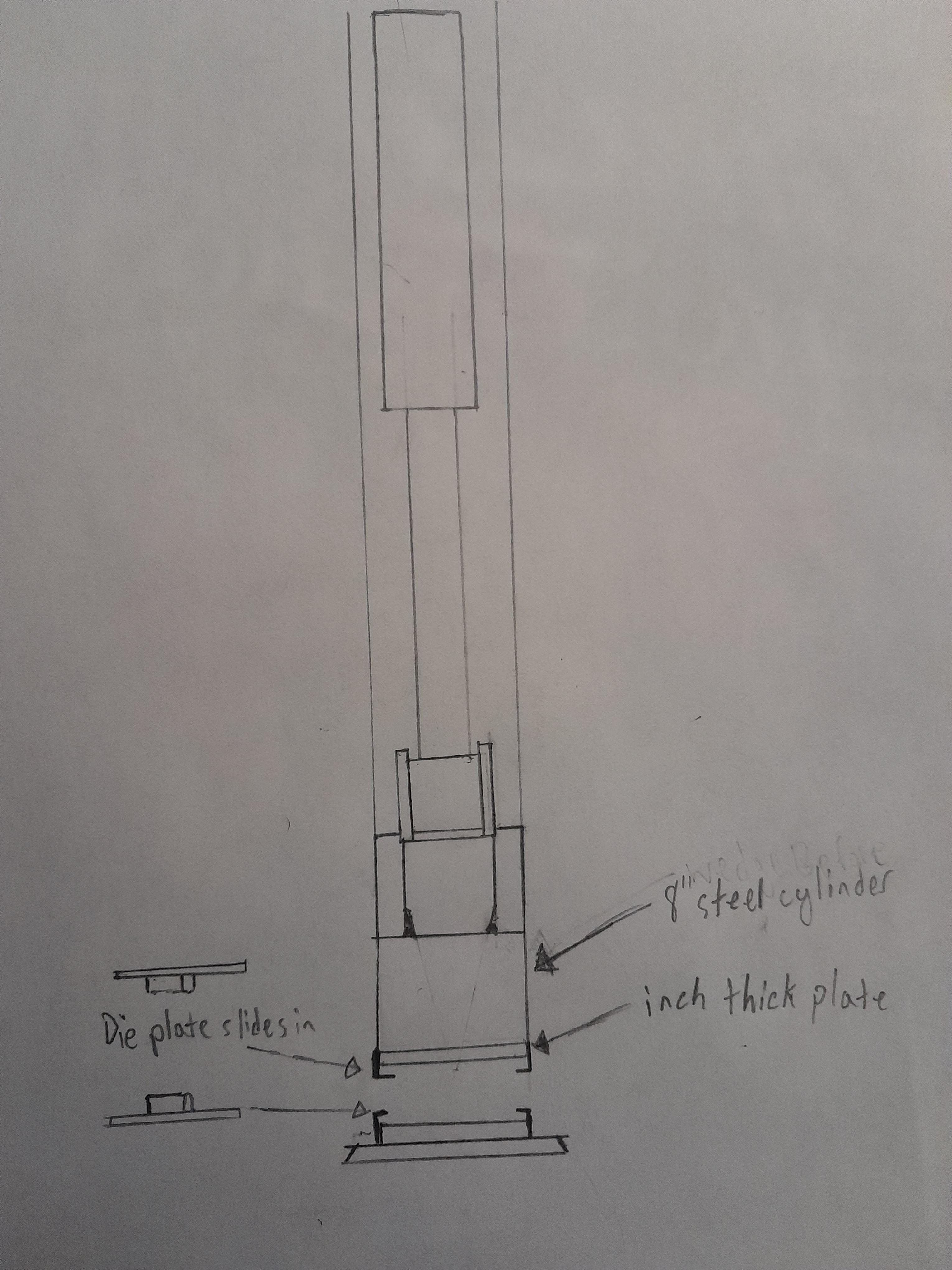

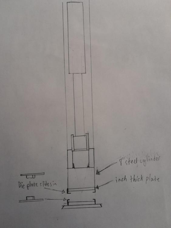

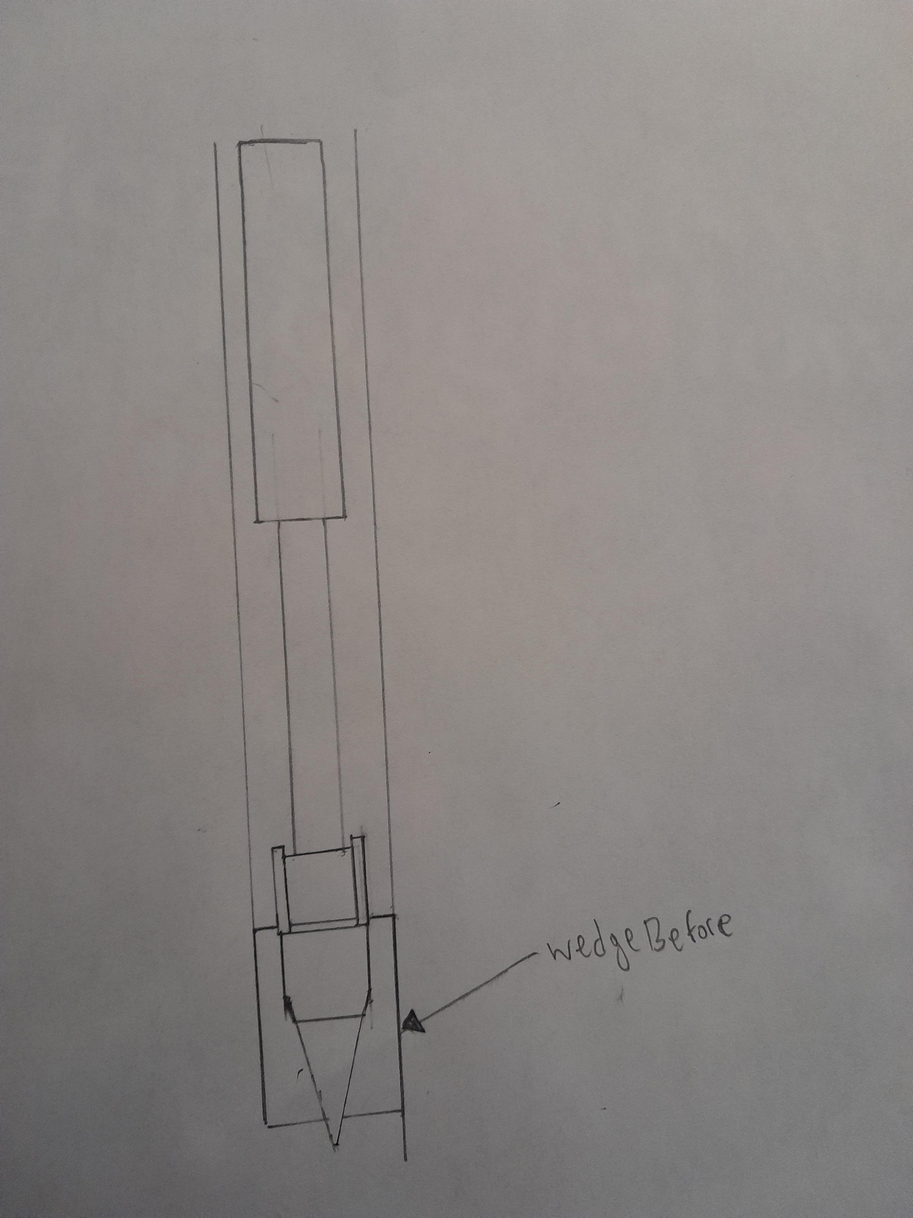

My idea for the ram/upper die is to cut the cutting edge of the wedge off and weld an 8 inch steel cylinder onto it. The cylinder has a 3 inch hole in the center that tapers to 1×3 inch. Weighs a good 65 lbs. Then I'm going to weld a thick plate over it to back the dieplate. Angle iron will hold the die plate against the ram head. I'll make a retaining pin of some sort. It'll have to be super heavy duty because I've heard that they bend really easy. Thoughts on the design? Also I found some pictures of splitter presses that people made. Can I share the screenshots of them? Idk if its copyright or not lol

Why make the mobile die so heavy? All the squeeze comes from hydraulic pressure it won't move fast enough to develop significant inertia. Just heavy enough to be a LITTLE stronger than necessary is just right. By a little a pretty standard level of overbuild is 30%, less in a compressive structure like a press.
I can't tell how the splitting sedge is attached to the ram. Is it threaded, pinned, or?
The wedge is pinned. The mobile die is that big to make sure the dies don't heat up too much. However itll suck the heat out of the steel too. I dont think the weight should affect the hydraulics. The real reason is I don't have any smaller steel lol. It's the same width as the splitting wedge so It fits. I have a few dozen pieces of the cylinders so I'm just happy to be able to use one.

The dies won't be in hard contact with the work long enough to hurt them and the faster the dies heat up the hotter the work will stay, maybe an extra push or two. The hydraulics won't notice the extra weight and it won't do you a lick of good.
All you need for the connector is a piece of pipe that slips over the ram close enough it doesn't wobble. Drill a hole for the pin and weld it to the die mount plate. Do NOT worry about making the retainer pin STRONG, it isn't a splitter it'll never have to drag the blade out of a block of wood by brute force. All the pin has to do is support the weight of the top die. If it weren't for the heat one wrap of duct tape would be more than strong enough.
I strongly recommend you make the die plates screw to the ram and anvil. Make ONE template with the holes the same size as the die plates. Make the ram and anvil die plates the same so you can exchange them.
One last suggestion. Do NOT alter the splitting wedges so all you have to do is put them back on so you can sell a functional splitter when you discover not many people will pay as much for a home modified forging press. When the time comes you move up to a purpose built press, power hammer, etc. and can use the money more than a dust collector.
