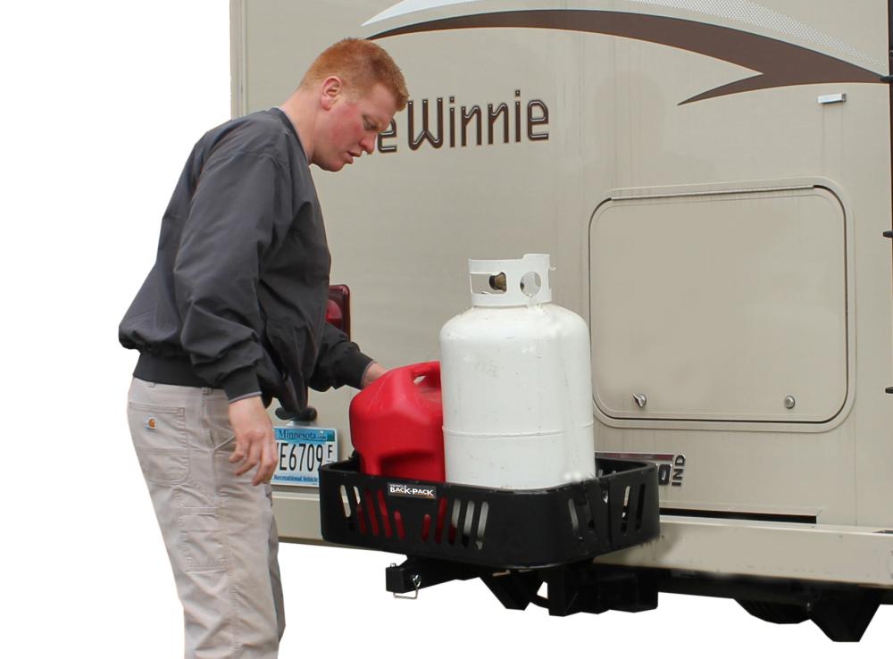

Well Frosty, this got me thinking the whole fuel thing. No pickup since the farm. Backpack makes the “fuel lock’r”. That would be good for gas cans also. And since a full 40# tank weighs 72 pounds, I might go with a 30# tank (55# full) first since I’ll probably only use one burner to start and I recently had retinal tears in both eyes and the surgeon warned me about very heavy lifting which puts a lot of strain on the eyes and could cause it again.  Just have to figure out how to secure it. What happened to the days when carrying 100# feed sacks was routine?any info one your suppliers tank mount would be appreciated.image.thumb.jpeg.3aeb9ca146852855a5f687bbd4dc5c33.jpeg

WE bought a Haul Master luggage carrier from H F for $70 U.S. fits the Reese hitch and will hold 500 pounds. It's low enough that loading heavy tanks are easier than lifting them into the bed of the truck. It is built with plenty of ways to strap stuff in.
I called both propane distributors that also share appliances, equipment, etc. Neither carry a tank carrier that fits a hitch receiver but thought it sounded like a good idea. One of the fellows says they do sell consignment items and what I saw may have been a custom product, there is nothing like I describe in the catalogues.
The counter guy said they sell a fold up cargo carrier that fits the hitch receiver and it holds 3 milk crates securely and people transport propane cylinders with. 20 and 40lb cylinders fit milk crates snugly and 1" ratchet straps keep everything secure.
I'm thinking what I saw was something someone was selling on consignment and maybe it didn't sell well enough to continue or things just changed.
Both guys at the propane warehouse and main store front liked the idea. Hmmm?
Great start but they all seem to be too big. I just don’t need something 4 or 5 feet long. We Americans sure do have a lot of stuff. I’m checking out the fuel lock’r.  My days of needing something that big to haul a lot of crap outside the vehicle are over. I hope...
