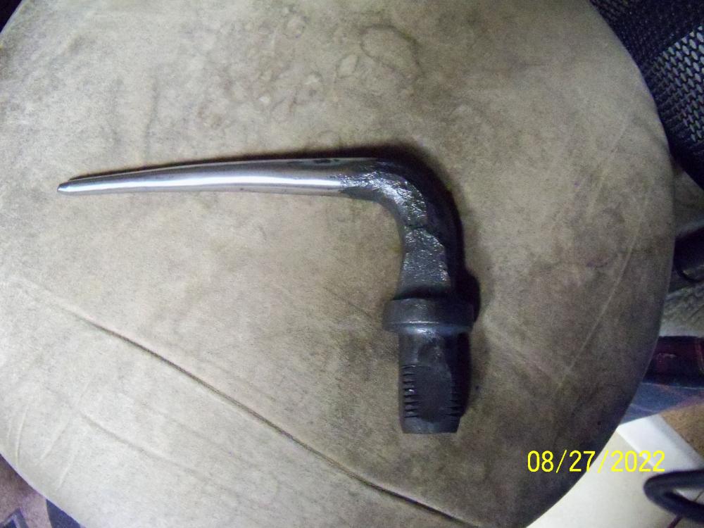

Irondragon Forge ClayWorks Posted September 9, 2022 Share Posted September 9, 2022 Swing by my shop and I will give you several connector ends from some sucker rods. Even let you use the Star power hammer to do the heavy pounding. Like this one. Quote Link to comment Share on other sites More sharing options...
