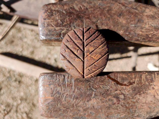

Heres pics of my veining tool. First hardy tool I ever made. I made it out of an old drill rod. Its slightly radiused. The idea was I could forge the center spine deeper and as I worked to the outside, the veins were less deep. It sorta worked. It was my first lesson in " too complex".  I don't know how many aspen leaf key rings I made at crafts fairs,,, lots. Using a tool like this or just a chisel makes for a good demo.
Frosty, The veins are all raised.
Different leaf but the same type of die I made. I made mind from flat stock and laid it on the anvil. Where the main vein exited at the base I transitioned it into the stem and it stopped just short of the leaf tip.
Yes the veins stand proud of the leaf.
You see what I mean by a die making veins that stand proud is much faster than hand forging them. No?
