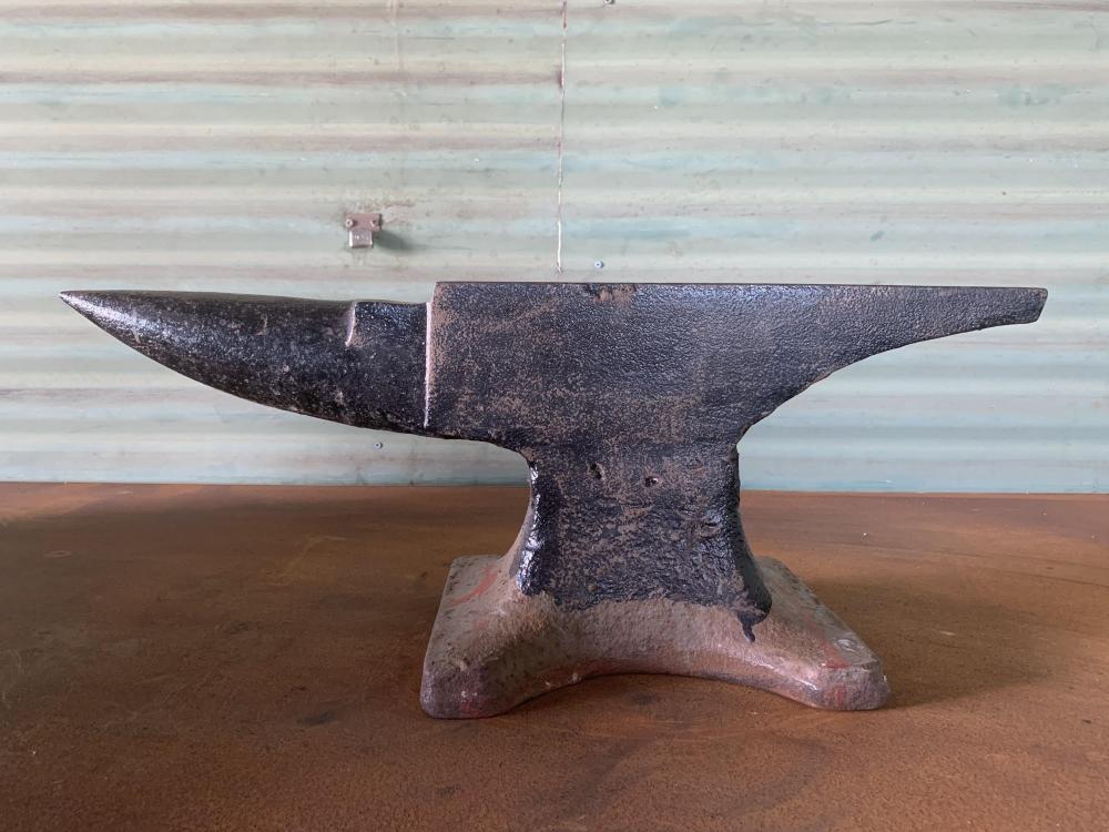

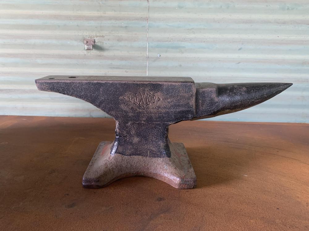

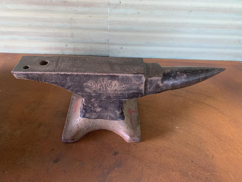

Hi,
I just bought this “so they say” US ARMY Trenton anvil. It’s about 110lbs (50 kilo’s).
There are no markings or serial numbers.
Does anyone know something about this type of anvil? What would be the value? And the origin. I know Trentons where made in Ohio.
This one was left behind in Belgium during the second world war I have been told.
I would appreciate the imput.
Thanks,
Alex
I’ve seen a 30 pound Trenton with a US army forge from WW1 before
that was supposed to be part of the original kit, so it’s believable that Trenton was an army anvil,
not sure what the goin rate is in your area,
but here in eastern Oklahoma I’ve been buying used anvils for $2-3 USD a pound, but that ones pretty clean so it might bring $4 a pound,
That’s my region but different places may be higher or lower depending on scarcity,
Nice anvil but the probability of it being former US Army from WW2 is lower than it would have been for WW1 because of the higher proportion of animal transport in WW1.  However, the Engineers in WW2 could still have had anvils and forges as part of their equipment.
What's the weight? if its around 30-50 kg you can maybe get 200-300 euros for it if you find a buyer, it seems the most common problem with marktplaats and the like is a good supply with a bit less demand. I think you can better keep it as a travel anvil, small anvils are a bit more rare than the 200 kg beast that pop up often.
~Jobtiel
  • 2 weeks later...
You can still find some old anvils on Army posts, usually hanging around the mechanics and metal fab guys. Half of the time they've unfortunately had the stew beat out of them.
A lot of times they are indeed Trenton's, with a few Vulcans and no-names thrown in.
