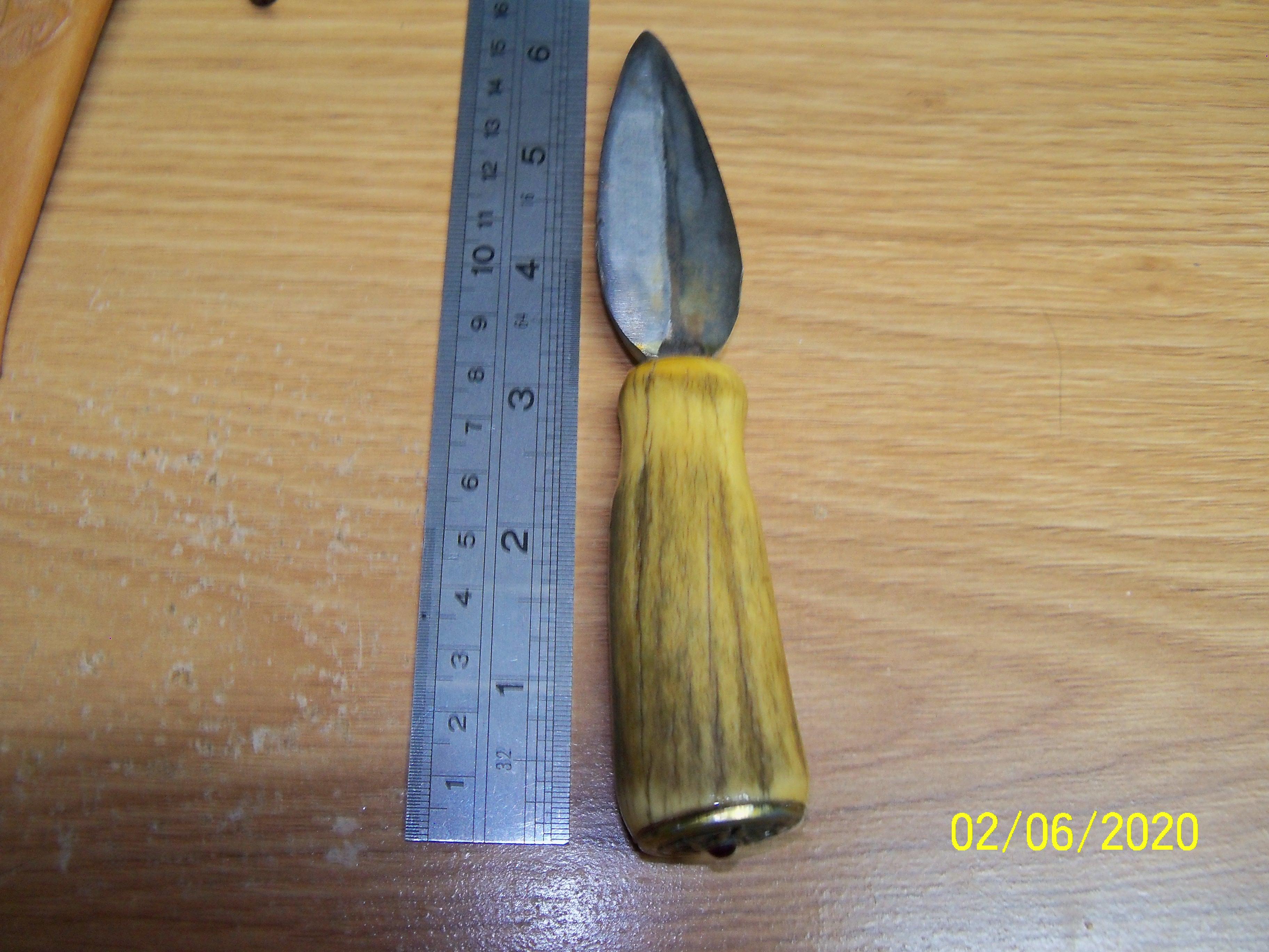

I made a small neck leaf dagger for my wife out of a piece of the semi-truck wheel that, I cut down for my forge. First made a test coupon, which did harden, snapped off when hit and tempered back to straw color. It holds an edge OK but not as well as some 1095 or 5150. The only way to tell if your wheel is worth messing with is to test it.
