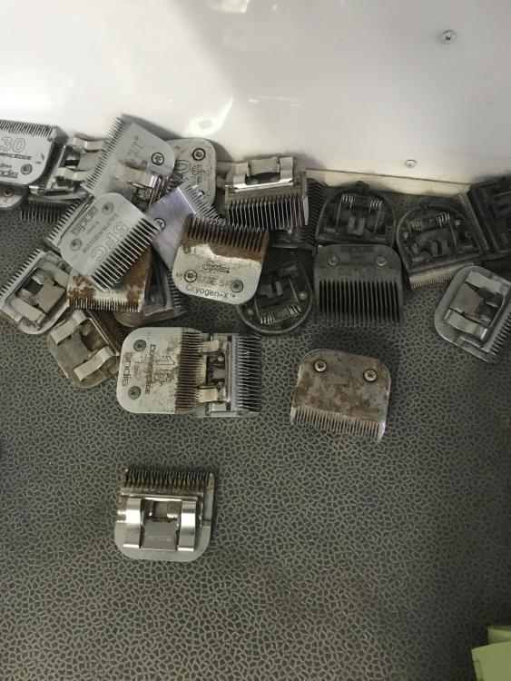

I have access to broken grooming clipper blades and it seems a waste to toss them.  There are 4 separate pieces to each of them.  Could they be used for tooling?  Ax bits? Welded together to make chisels and punches?
Maybe though it'll be quite a trick to prevent cold shuts with all the space between the "comb?" teeth. Just the blade if it's a single piece of steel would be a lot easier to faggot weld into a usable billet.
A perhaps greater issue being the blades maybe probably are stainless steel and so will require some of Mr. Hrisolous's special flux.
If you give it a shot and let us know how it works please.
You'll want to test them to see what type of steel they might be. It might not be worth the effort.  You have enough to experiment with tho. Just be wary if they are chrome plated.  Look in the safety section to learn more about the dangers of that.

There is a huge gap between what could be forged and what should be forged. Those look like they would take a lot of time and effort to use and so unless there is an overriding reason to use them, not a good trade off.  They fit the "The stock was free it just took me 20 hours of work to get it in a usable form for for what I do!" category...
The gaps are not a total down check though, we're forging timing chains, chainsaw chains and other "gappy" items into billets on a regular basis.  It's the possible stainless content that would prevent me from using them.   Does advertising for replacement blades give any hint of what they are made of?

I would definitely cut off the teeth and use just the solid part. I don’t know about stainless because it doesn’t take much for them to rust.
I did email one company asking the type of steel and they said it was “proprietary”.  One ad did mention the Andis blades being “chrome-coated carburized steel”.
not sure if the Wahl blades are coated.  They seem more naturally colored.
3 hours ago, Glenn said:
Those blades can usually be sharpened and reused.
Not with broken teeth. They’re unsafe to use against skin. The small blade on the bottom is replaceable, but if the large half gets a broken tooth, it becomes useless.
