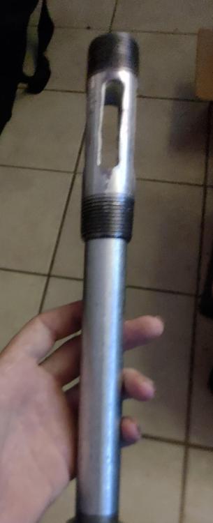

This is the initial stage of the burner build, air slots roughly cut out of the 1" pipe, and test fitting to the 3/4" mixing tube... Yes the tube is too long at this point, it'll get cut down eventually. The cut slots are around 2.5" long probably a bit under, I still need to file and grind them to their final shape. The choke will be a section of 1-1/4” pipe that slides up over the slots.

Did you remember to bevel the inside of the mixing tube, before pushing it into the pipe nipple?. You don't have to have a flame retention nozzle on a burner mounted in a forge. Bettery nothing than what you have in mind.

the upper edge of the 3/4" mixing tube is beveled, in that photo i was only friction fitting the parts together the final burner will be welded.

Got in a bit of work on the burner prototype during the evenings this week. It's a bit rough but should work... this is in line with figuring out my final design, I expect some problems with this first one and I'm hoping to figure out what construction methods will work best for me, and the tools I have.
The slots are still not pretty, the only drill press I have right now is a piece of crap 8" bench top type, with a lot of runout (visible amounts) and no way to fix it. It's fine for what I bought it for, woodworking, just kinda crap for any real precision work.

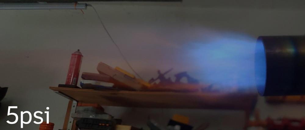

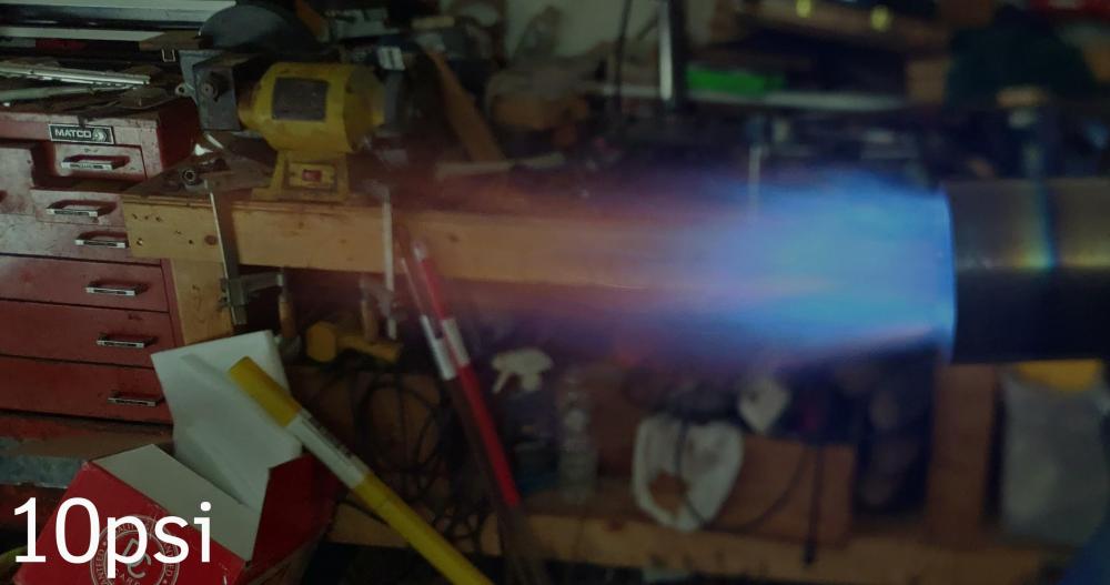

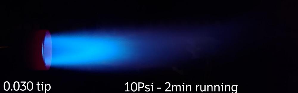

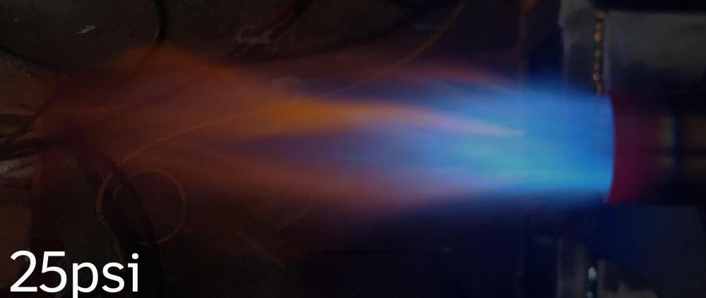

Tossed together a simple nozzle to run a few tests on the burner as it is:
I'm using an old fuel gas regulator for a torch set... This one works up to 25psi, while the regulator section is in good shape the Guage's are a bit worn out, so they don't read very well below 5psi.
This is running the .030 short type 11T mig tip.
My camera really brightens the colors a LOT... I had to edit the exposure to the minimum to get these remotely close to what they actually look like. At 5 psi visually it's dark transparent blue, and actually hard to see even with the lights off and the garage door only open about 24". But the camera really made it look bright blue/white before I edited the shot - that's what I get for a camera that works well in low light conditions... LoL.

If that is 3/4" pipe for the mixing tube, then I would suggest trying to find a 0.025" MIG contact tip; not a  0.023" tip.
I have .025 tips on order already, Along with the larger 1/4-27 thread size types. They're just not a size I normally kept for my welder, I had .023, .030, .035 and .045 in my welding box to test with. I tested .023, and .035 but it just didn't run right with the 0.23 one- had to choke it over 1/2 to work. For the .035 it was hard to not get a light blue with green inner flame at higher pressures, and it was definitely fuel rich with  much longer tongues of flame.
This version looked mostly useable to me, but I still planed to test the .025" tips.

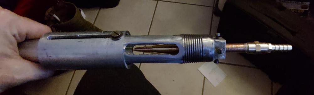

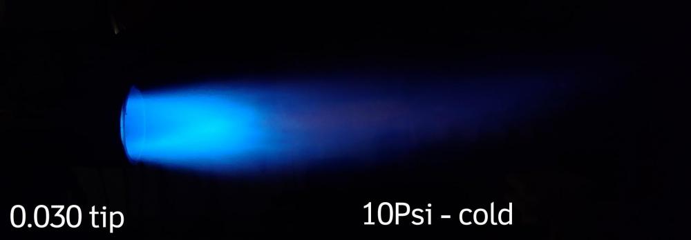

So I finally got time to finish up the 2nd version of this hybrid burner. I have a bit more testing and tuning to do, but it's looking good so far.
I tried a .025 tip, but the flames were definitely oxidizing at any setting. Super dark blue even at higher pressures. So I moved back to the .030 tip
P_20210914_181855_1_1.thumb.jpg.c85a5441e5a3af5460299d7f0bd195a4.jpgP_20210914_182103_1_1_1.thumb.jpg.4c3a368c3781b7fd4ed78f033a0e9852.jpg
With the .030 tip it looked much better. Especially once it heated up the nozzle a bit.
