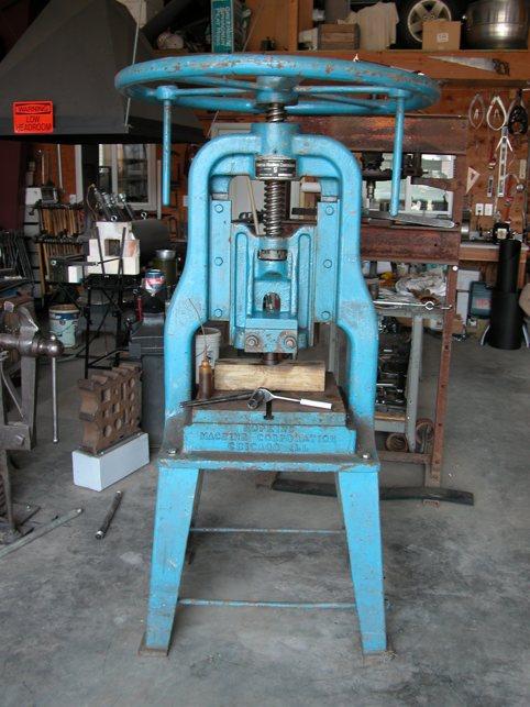

Anachronist58 Posted August 20, 2021 Share Posted August 20, 2021 I support JHCC's premise. My 5 ton flypress gets used for so many different projects. It is a great mechanics tool, and not only can one aggressively work metals hot or cold, but also with delicacy and finesse.... Sure would like to see a pic or five of that flypress... Robert Taylor Quote Link to comment Share on other sites More sharing options...
ThomasPowers Posted August 20, 2021 Share Posted August 20, 2021 Here's one a lot like mine: (Better picture than I have of mine). Of course with the blasted "Buyer's Reaming" + paying a rigger to load it in my pickup mine ran the better part of US$100. One of the nicest things about them is that they are *quiet*! Quote Link to comment Share on other sites More sharing options...
