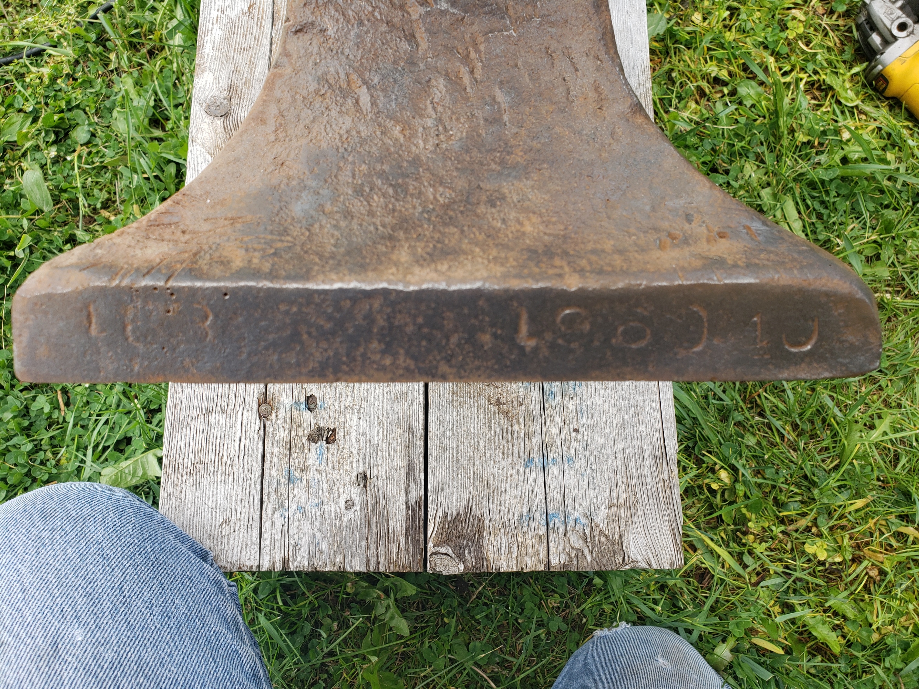

Really no clue on the maker or age, but it appears to be cast with a plate. I can't find any markings on it. Looks like there is a lot of plate left and it's actually quite flat. Some chipping on the edges, but I think it's within rounding range for what I would do with it. Weight is 150 from what I was told. Haven't put it on a scale to check yet.
Got out today and got it out of the trunk and cleaned up. The worst chips on the side away from me I rounded off and made radius' (is that right?) out of. Mostly just to keep them from chipping further, but the will make an ok spot for starting handle contours when I'm making knives. Well, in my brain at least.
I did use a flap wheel for that and just lightly on the face to clean up a few spots that looked like weld spatter that had landed on the heel. The rest was just wire wheeled and rubbed the whole thing down with linseed oil. I got it mounted on my block and chained down like the little Vulcan was. It is slightly higher than the Vulcan that I set doing the knuckle thing, but it actually feels more comfortable to use that way. Time will tell on that one I guess.
I did get it on a scale. It weighs in at 160 pounds. I also found just a few hints left of some stamping on the foot under the horn. Looks to me like it has a 163 and a 1960 10 stamped into it. 163 pounds and made in Oct. 1960 maybe? No clue personally. It also has a bit of depression in the center of the foot.
So I still have no clue who it was made by, but I did forge out a knife blank from a piece of 1095. Hits very nice and has a decent ring without being tuning fork annoying. Definitely more than the "thump" I got from the Vulcan. A ball bearing is showing about 85ish% rebound.

I think you have a Trenton, clues wt 163 & serial number 196010 on the front foot and the caplet indent in base. The only other anvil make that uses the caplet I know of is Arm & Hammer but their wt is on the side with the horn facing to the right, under the trademark. A picture of that side after cleaning may reveal remnants of a trade mark.
Someone with a copy of Anvils in America may be able to confirm that and give you a date range on when it was made. In either case you have a very nice anvil that should serve well for several more generations of Smith's.

Very cool for the information. Thank you. The other side just has a few more punch marks. There were/are quite a few chisel marks around the bottom of the waist and at the top of the foot as well. So my thinking was they made a lot of tooling.

Look for clues of the Trenton diamond logo on the side with the horn facing right. Might be really faint if it's there. Looks like a Trenton to me as well. I really doubt it's from the 1960's, that's just the serial#. At some point later in their manufacturing they used a wroughtiron lower with a full steel upper welded on at the waist.
Thanks guys. So pretty safe to call it a Trenton then. I have a few projects lined up for it already as soon as I get the time to get out there now. Anxious to do some more hammering on it.
