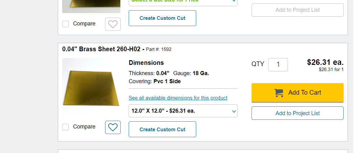

hello new to this section,
so i live in canada and cannot use coins as it is 100% illegal I am unsure about US quarters as they are used just as often as currency (look just like a canadian quarter with a fast glance same with british and ive even found AUD in my wallet) i can get brass and copper sheets would this be a good idea or should i look for another source
561837840_brass.thumb.png.cb1e7b1d134c886c5ab2d1065b624e61.pngcopper.thumb.png.126cb0ddf447e1066273a828fe1c114e.png1589078445_.02copper.thumb.png.14c54ceb4880129d1cceef6942377e79.png

The Currency Act's prohibition of melting down, breaking up, etc applies to "any coin that is current and legal tender in Canada." In other words, if it's a Canadian coin, leave it alone. If it's a coin from any other country (including from the US), go for it. Just because it's in common use does NOT make it legal tender.
That said, teenylittlemetalguy had a post a few years back about how much better it is to use plain sheet metal instead of coins:
Just don't make brass & silver mokume unless you need a puddle of silver solder.

ok ordering today should i go for a .02 inch both or .02 copper and .04 brass?
