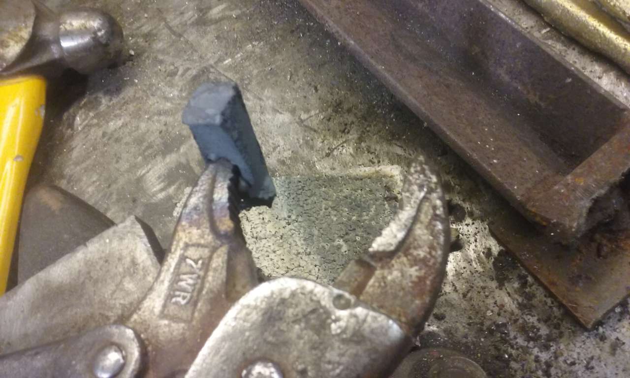

Propane will melt your iron.
  Can you get it hot enough under the right circumstances to melt mild steel?  I ask purely out of curiosity and have done no searching or research on it.  I tried it once on a lark in my old ramshackle forge and it got squishy.  I probed it with a vice grips and it froze on them.  :)
I have accidently melted a piece of mild steel in my simple pipe forge and a friend of mine melted a billet in his propane box forge.  Of course high carbon steel melts at a lower temperature than mild steel and cast iron melts at a still lower temperature.  Luckily as this makes "puddling" work in the indirect method of wrought iron smelting.
  Thanks Thomas.  One thing leads to another.  I know I said I haven't been researching it but I have been reading all the information in the "articles" section from coke making to iron ore to steel production.  It's kind of eye opening and satisfying to know where all of this material we work with comes from.  Good thing about metal working : there is no end in sight as far as learning goes.
