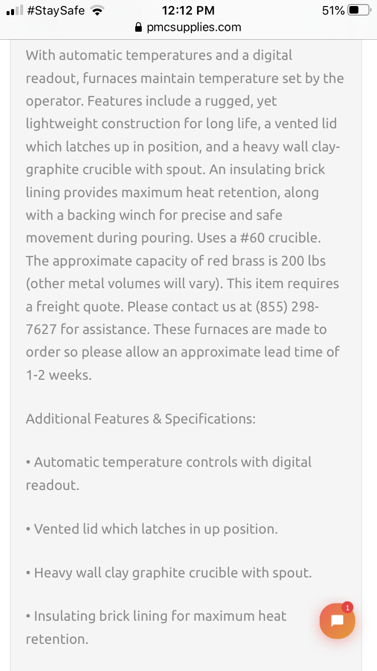

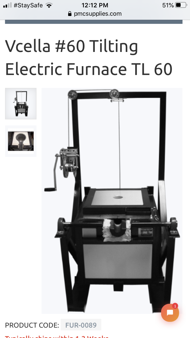

Hey, so my knowledge in forges and smelting is pretty minimal. But my goal is to have a forge big enough to be able to melt 45 lbs of cast iron in one crucible. My goal is to be able to sand cast 45 lbs dumbbell plates. There is a unit that I found from a company in USA called pcm supplies. I phoned the company and they say that the forge I was looking at would get to the melting temps I would need, but it says that the forge runs on 110 volt 3 prong standard plug in. I just have a hard time believing that with 110 volt I would be able to reach those temps. Would anyone have experience smelting and casting cast iron? And what do you guys think of this forge? I have attached a picture of the electric furnace and it’s description.
