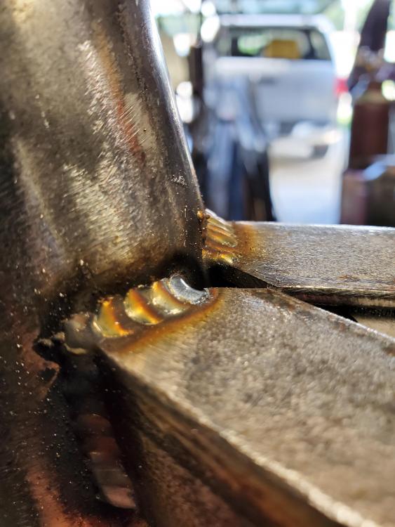

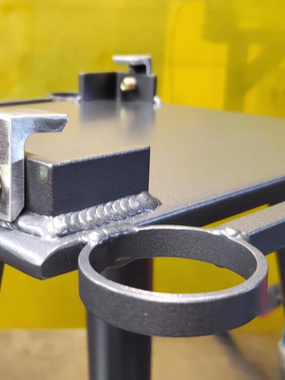

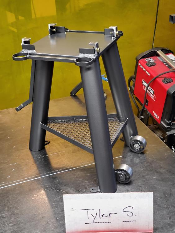

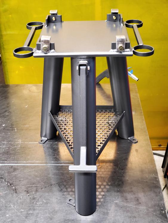

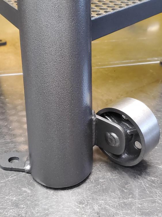

Custom stand for an Emerson 150 lbr.
This custom tripod stand has 3" round sch40 legs sand packed, welded and weighs in just under 100lbs. Also, has 3" wheel kit and handle for easy mobility around the shop.

That is very pretty. Much better welding than on my stand!
  • 4 weeks later...
Very nice job and well thought out. Is the sand for extra weight or sound reduction?

Very nice design — clean and functional. Quality welds and attention to detail are very apparent.  I like the theme that this and the other sample you posted have in common.  I will shamelessly use some of your ideas in building my own stand. Thank you!
