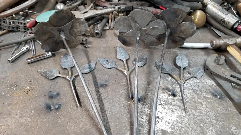

Daswulf Posted December 26, 2020 Share Posted December 26, 2020 On blanks I cut out from a template I was given by a friend, I start (after cut out) by drilling a hole in the center of the petal rounds. You could hot punch round holes, or square holes that would hold better without wanting to twist on the stem. Then I forge a stem making a little bulb at the top and taper the end that the petal rounds go on square, leaving enough that i can pein(rivet) the petals once on. You could use a crosspein hammer to texture the petals if you like before attaching them to the stem. You'll put the star piece on first, then largest to smallest petal round. Personally I use OA torch and modified needle nose pliers to shape my petals. Then forge my leaves and weld them onto the stem. Have you tried contacting them for instructions? Quote Link to comment Share on other sites More sharing options...

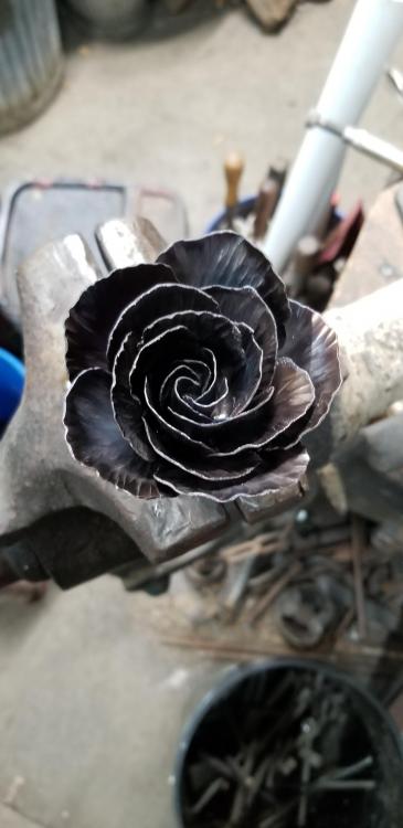

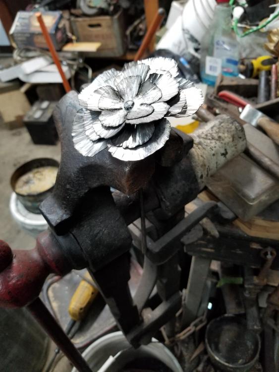

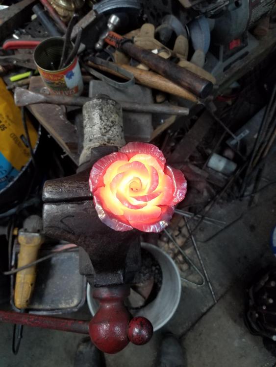

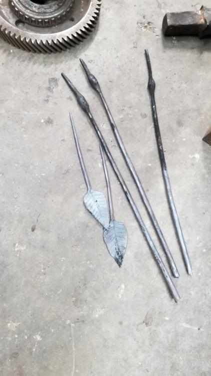

Daswulf Posted December 26, 2020 Share Posted December 26, 2020 Here is basically what my stems end up as after forging. (Lost some photos in transferring pictures from my phone) the part the petal rounds go on gets trimmed and peined/riveted one they are on. Pictures I have after the petals are riveted on the stem. Alternate the gaps in the petal rounds. one thing to mention in my process (using an oa torch and needle nose pliers) is to start bending up and curving the petals with one of the small center ones then work in a circle either way you like doing the next petal. Have some water handy to cool the pliers. Here is an image of one after. Have images of more of the process but not on my phone atm. This one I curled the edges over after bending up and curving. This is one I didnt curl. Hope some of this is at all helpful. Quote Link to comment Share on other sites More sharing options...
