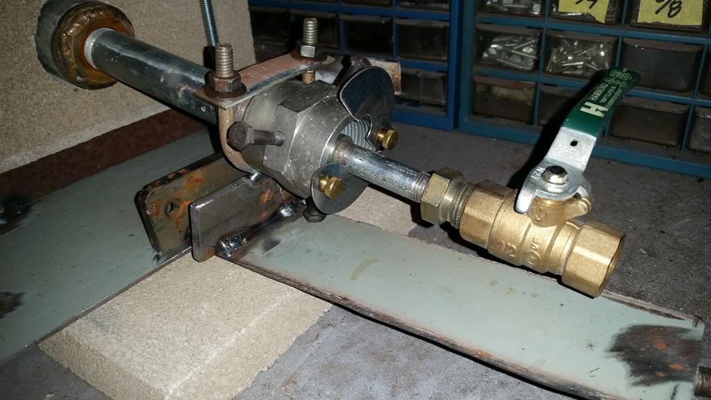

I’m just starting out, built a quick fire brick forge. Inside dim. H=4.5", W=6.5" & L=9", with one home made burner based on research. I have a 20# LP tank, now I’m not sure what regulator I should purchase. Do i need to consider a larger tank?
Consider: this is a temporary forge for now, once I get going I would like to build something like the LP tank forge. I would like to progress into Damascus and forge welding, possibly a dual burner. This all said, I would like to buy a LP regulator that fits my set-up now and can be used as I progress. Thanx

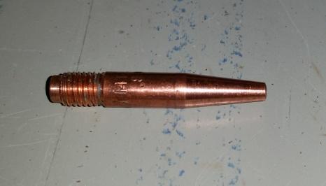

Here are a couple pics, surely this will create more questions than it answers. But that will help me in the long run. I have .035 welding nozzle for the gas. Let me know what you think and any questions you have about it. The ball valve is a WGO valve. Joints are sealed with gas rated goop.

So the gas hog is in reference to the lack of thermal retention. Kaowool and refractory will be part of the new build. At first glance does the burner look ok?

I'll evaluate your set up point by point. Menards or any big box soft fire brick will be low temp IFB (Insulating Fire Brick) under 2,200 f. for the better stuff. Expect it to crumble in a few firings even if you don't hit high orange, it's not intended for direct flame contact (Flame Face) and especially not propane flame.
I know it's more expensive but Morgan Ceramics K-26 IFB is rated for 2,600 f. sustained direct flame contact while maintaining it's strength. Forget Big Boxes or even good hardware stores for refractory supplies, contact a HVAC supply or service company. If they don't sell retail they will know someone who does. Use the phone, email contact tends to be ignored if you aren't interested in pallet loads.
Where did you get your burner? If you made it who's plans did you follow? Without specific details of it's current construction I see a few things that are red flags to me.  It doesn't have a proper or close to it, air intake bell, that's just a coupler. There is an unnecessary fitting blocking intake air flow, if it's so you can use the set screws there are MUCH better ways. Mostly just doing a good job of drilling and tapping straight holes.
I never mount a jet that deep in a burner but I don't do this like most folk.
You didn't include a pic (stills PLEASE) of it burning so I can't say if the flame is good bad or close enough to tune.
All in all it's not a bad first build but not a particularly good one.

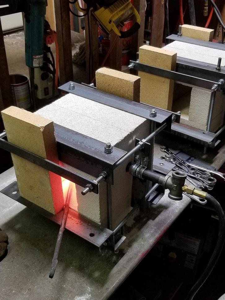

Below is from a club forge and burner clinic we held about 2 years ago. Cost to club per unit was under $45. Price to members $75, non members $95. Profit went to the club treasury of course. They were all killn washed with Plistex 900. The one in the pic took about 2 minutes to come to that temperature. The burner is a 1/2" T burner, made at the build clinic.
We bought 0-20 psi adjustable "high pressure" regulators. One of the club members is a caster and gets an excellent price break or we would've used 0-30 psi regs. However, I've been using the same 0-20 psi adjustable for about 35 years and it supplies more than enough volume to run four, 3/4" burners.

I don't think we actually made "plans", a couple sketches and sometimes argumentative discussions. We used a cut list and bought the steel and allthread in 20' lengths. Bricks were on two pallets in Pat's studio. I'll ask Tristan if he has the list or drawings. As built plans would be confusing, Pat's a professional artist and seems to have an almost pathological dislike of measuring things. The holes in the angle iron for the bolts were all eyeballed by guys who've never used an iron worker so they vary as much as an inch. We ended up laying them out on a table and picking the most similar for the assembly. One of the other buys cut the all thread so those're all pretty close.
I'll see if anybody has pics during the build or at least one with the split brick baffles off. I THINK there are 12ea. K-26 AFBs and 2ea. 3,000 f. split bricks for the baffles / doors.

My suggestions are based on a 3/4" mixing tube, my best guess at what you have there:
Use a 3/4" x 2" or greater bell reducer for the air intake. Drill and tap for the set screws, one closer to the  large end, one set deeper. 6 set screws will hold the jet more securely and allow you to align it correctly.
Use a 1/4" scd. 80 pipe nipple to hold the mig contact tip jet. the ID is almost perfect to tap for the mig tip. I stopped telling folks what tap and drill to use, there are too many different ones in use. Buy the mig tips at a welding supply and ask the guys at the counter for the tap to chase out the threads. This is a common thing to need to do with mig welders so supplies carry the taps. If you buy at a Big Box store you'll have to determine what the threads are.
I position the jet. (the open end of the mig tip) farther back from the throat, The throat is the end of the mixing tube in the air intake. However most people place the jet deeper, it's easy to adjust with the set screws.
Buy a fitting to make up the 1/4" pipe nipple to propane hose fitting. IIRC 1/4" FPT x 3/8" MPT. (FPT is Female Pipe thread. MPT is Male pipe thread.)
Put the  1/4 turn valve on the regulator rather than the burner. The less weight on the burner the easier it is to align and keep aligned. Being at the tank you can shut it off without getting close to the HOT forge. Your kids will LOVE turning it on and off and doing it correctly is a good thing. Also when shut down the hose will depressurize from regulator to burner rather than leak off over time.

What plans did you follow? It looks to me the tip is a A/O cutting tip. An interesting burner though, first I've seen of that design. The piping looks like galvanized pipe, a bad idea as heated galvanizing gives off toxic fumes. Might want to research metal fume fever. If it is galvanized soaking the parts in vinegar will remove it.

Thanxs for the heads up, I'm very aware of the galvanizing issue, I assembled it for the pictures. I have a bucket of muriatic acid I use for just such parts. The design is based off several I've seen, just didn't have a reducer on hand, so I thought I would use a coupling. Pretty sure the tip came off one of my welders.

Yes, that is a 3/4" mixing tube, should I leave the coupler on the exhaust end entering the forge, or just use the mixing tube directly into the forge chamber. I don't know when this will post as I have now received my 3 warning from the mods, they have to redact and approve it I guess.
