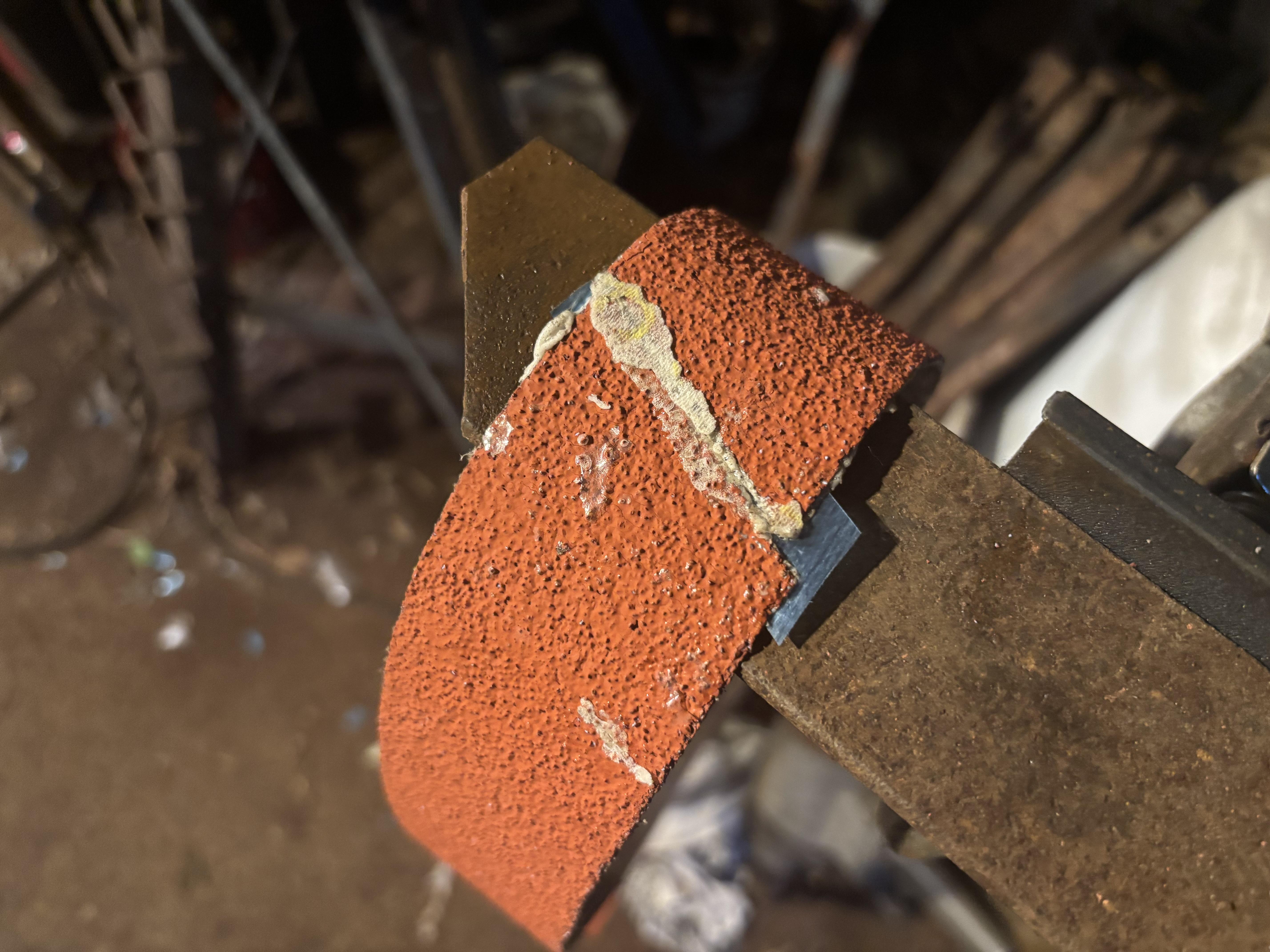

Can you read the brand name on the back of the belt or is it too smeared? A scalloped joint makes sense, maximizes the area of the glue joint but allows a more gradual thickening.
I wonder if a scalloped shear would work well, a whack with a hammer would save a lot of time and blades and you could make them as uniform as reasonably possible.

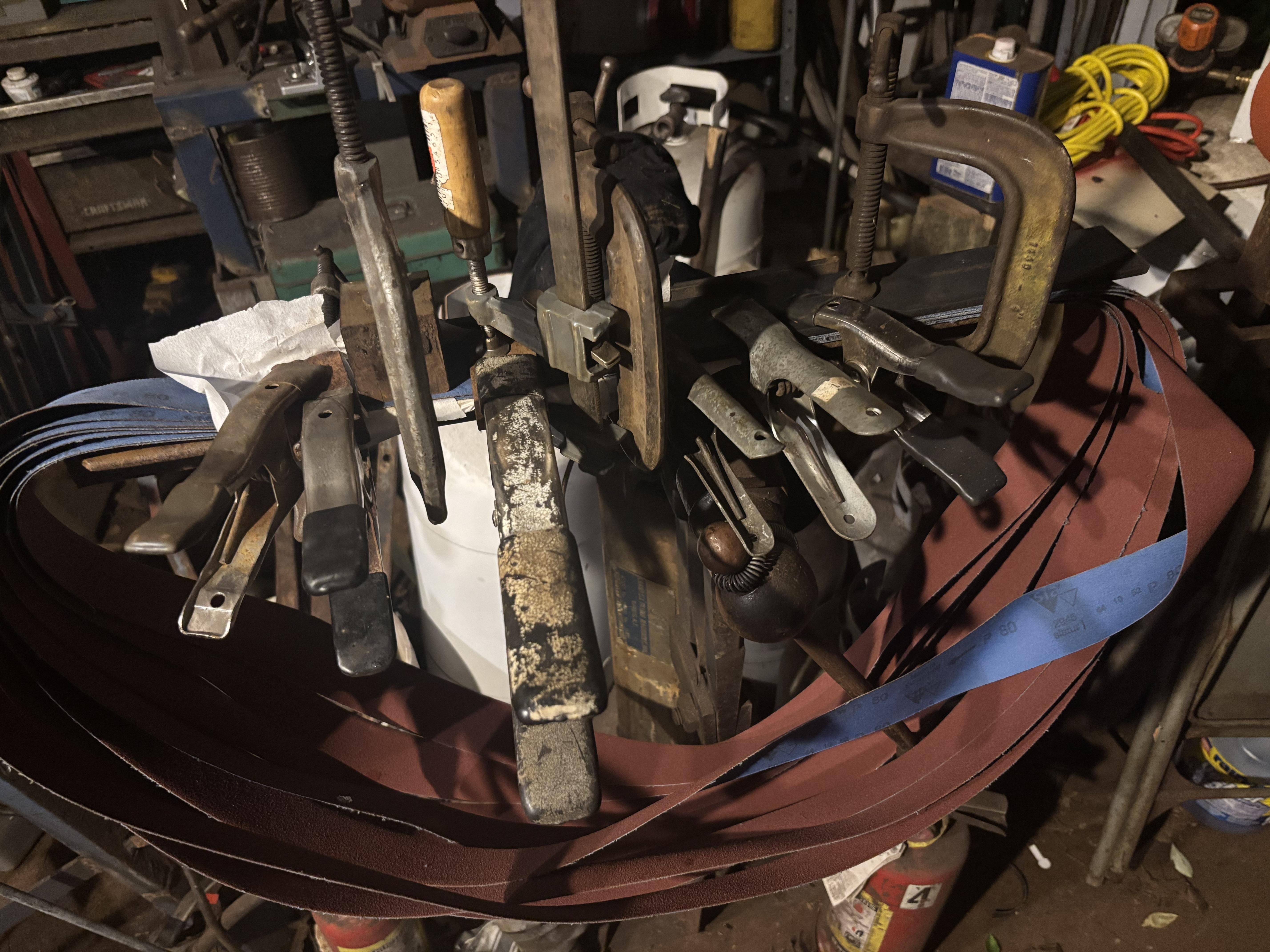

I was wondering about the practicality of gluing up so many at one time.

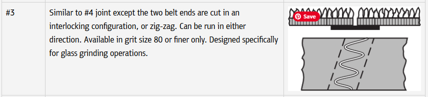

It seems that this is known as a "sine wave splice". Here's some info from the 3M website:
Quote
A sine wave splice is constructed of interlocking fingers that enable the splice to travel smoothly over contact wheels, reduce hinging, and provide added strength to the joint area. Sine wave splices are typically used for coarser grades and wide belts as well as on belts that are going to be washed.
And from the Klingspor site (the "#4 joint" mentioned is just a simple butt joint):
Quote
Klingspor also has a nice little video about belt splices. Here it is cued up to the bit about this kind of splice:

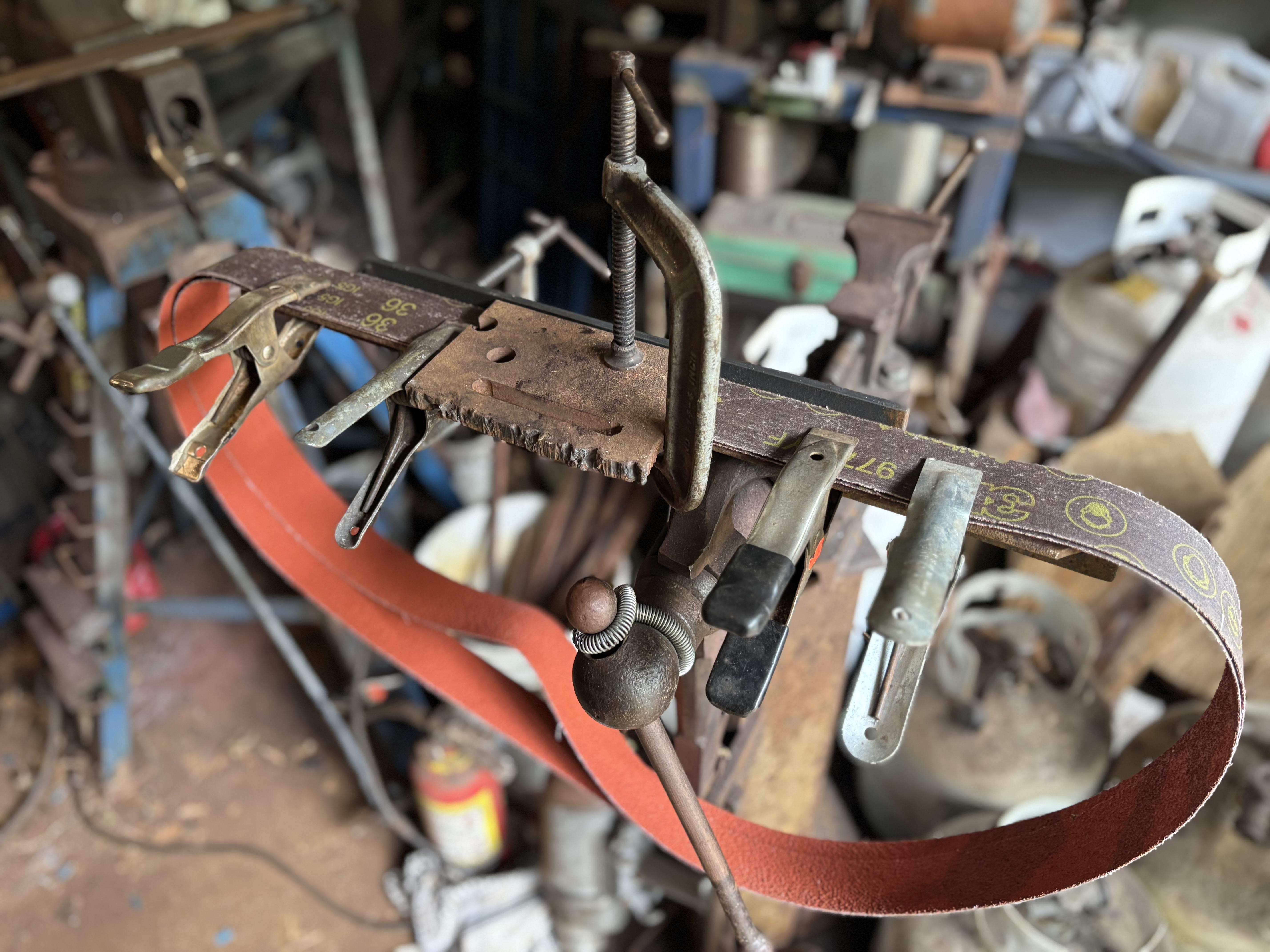

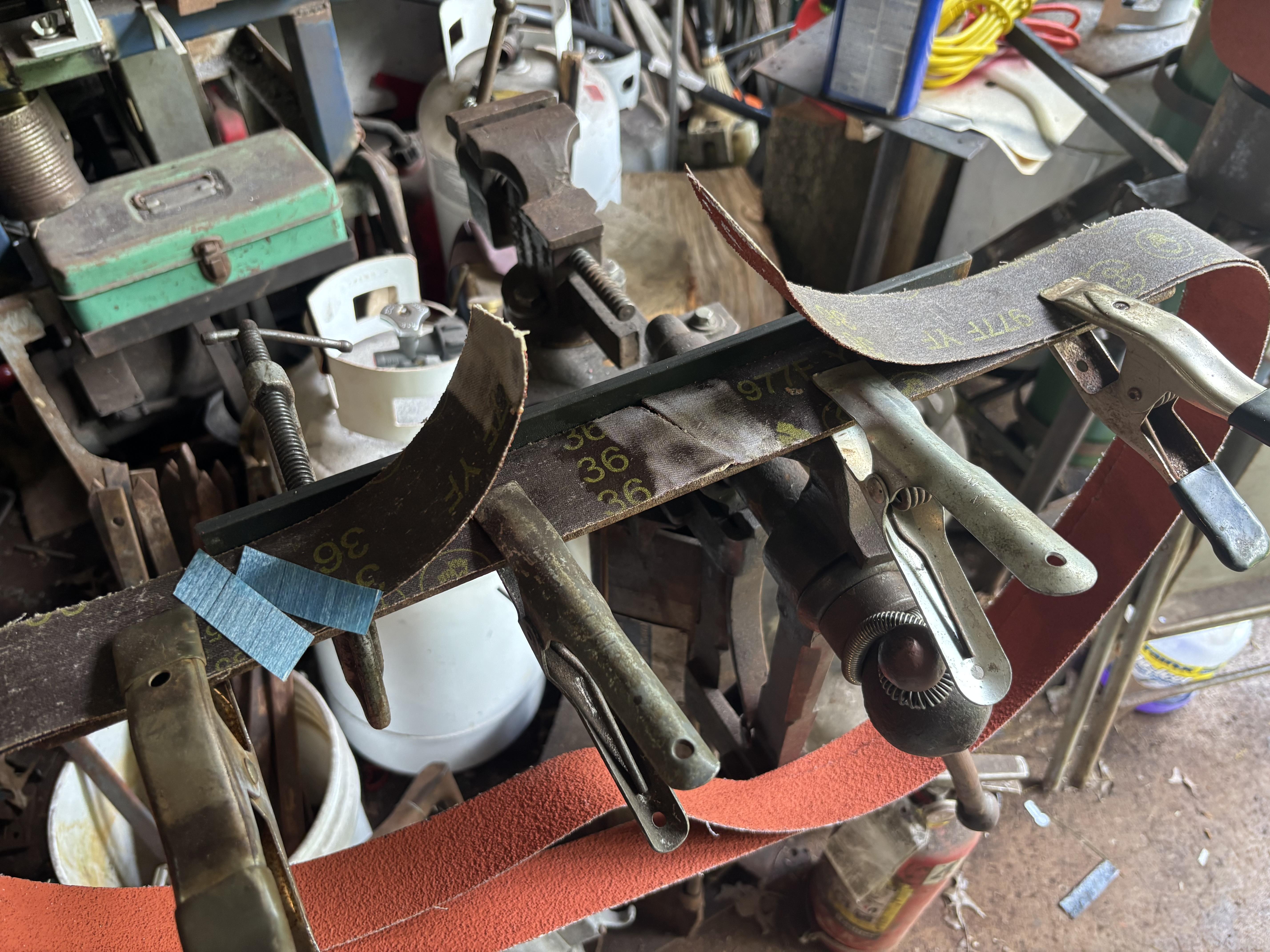

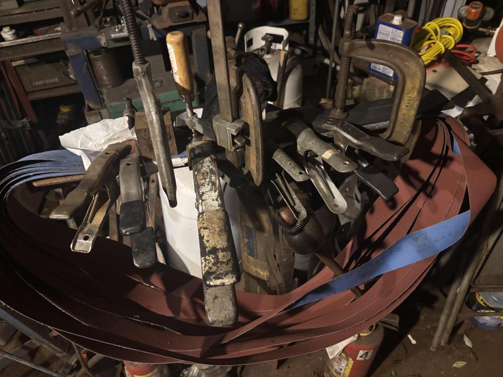

It was actually working very well, since the Gorilla Glue has a decently long open time. The only problems were the two described above, both of which could have been mitigated with better planning.

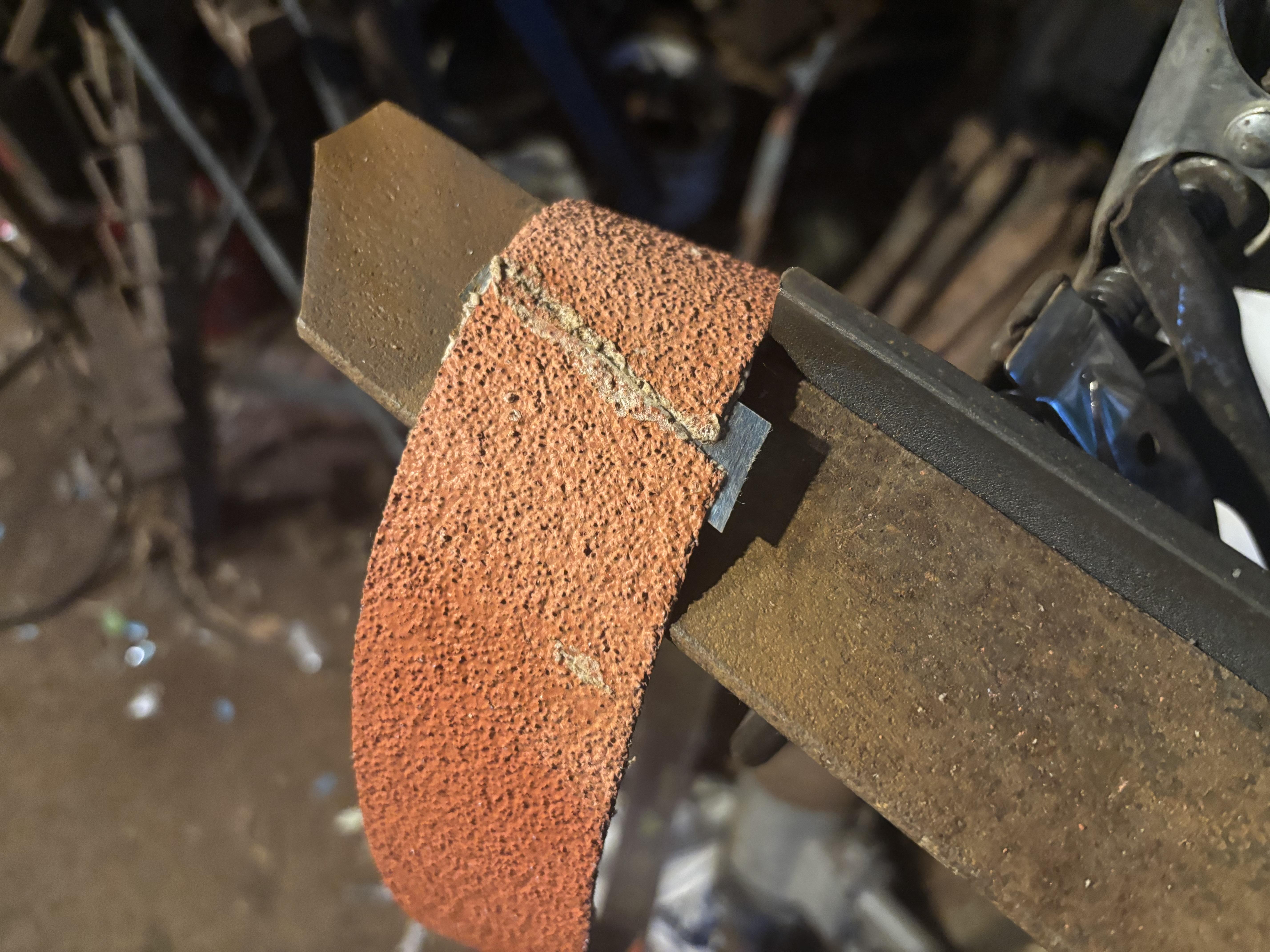

Update: I reglued the two belts that didn’t do well the first time. Step one was to sand off the glue residue on the new grinder:
Then on to glue-up, this time with a fence at the back for proper alignment:
 Which worked very well.
The tricky bit is replacing the spring clamps with the caul, as the ends of the belts want to curl up and pull apart. Maybe doing it in segments would work better.
We talked about this quite a bit when you first got started but at risk of repeating myself. Have you considered gluing the full width belt and splitting it into 2" belts afterwards? Keeping wide aligned is easier than narrow. Clamps would be more unwieldy but not much.
I haven’t since I first started using the proper splice tape. Might be worth a try.
 In the meantime, I made up a batch of 80 grit belts. Went pretty well.

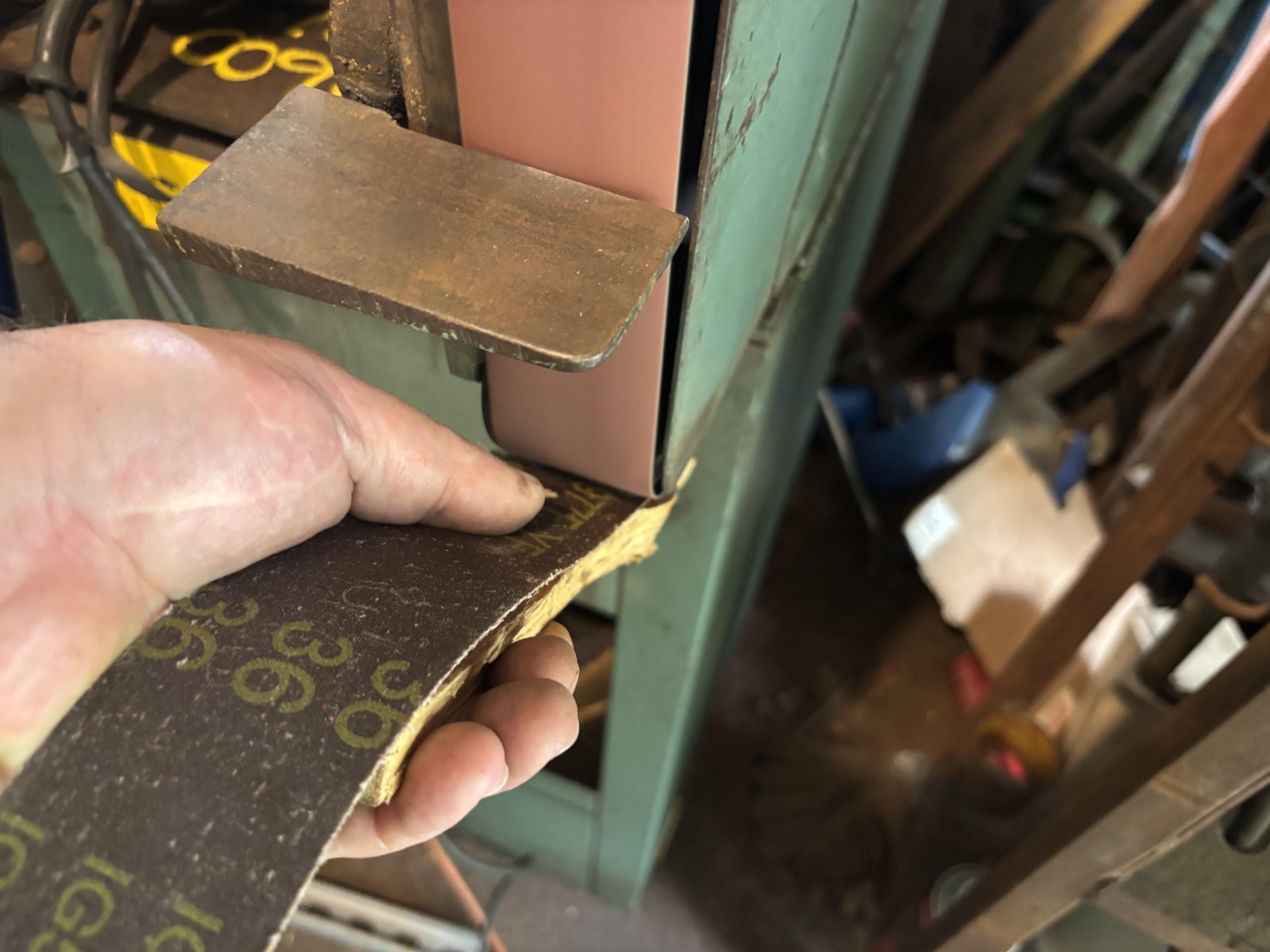

 Also, here are photos of a 36 grit belt before and after having the glue squeeze-out scrubbed off with a stiff wire brush:
How long do they have to stay clamped for the adhesive to set?
The one with the glue squeeze-out looks like it shifted too. That sort of thing was common when someone used too much adhesive in the rubber plant, the fabric would "hydroplane" on the excess adhesive and the joint would shear sideways. It was almost impossible to prevent the joint from shifting.
According to the manufacturer, clamp for 1-2 hours, cure for 24 hours for full strength.
One of the notable things about polyurethane glue is that it expands as it cures, and if unclamped, foams up and pushes the pieces apart. That’s not what happened here (this is one of the ones where the ends didn't come together in the first place), but it’s an interesting effect nonetheless.

Quick note: I was grinding something this morning with one of the 80 grit belts and caught a corner of the splice on the workpiece. I’m pleased to report that while the belt ripped, the glue joint did not fail.
No blood? No problem.
Isn't catching a corner an indication of a problem with the splice?
The root of the problem was that I hadn’t split the belt evenly, so one side of the splice was a little wider than the other. In retrospect, if I had mounted the belt the other way around on the grinder, the wider corner would have been on a trailing edge rather than a leading edge and thus much less likely to catch. Oh, well; live and learn.
