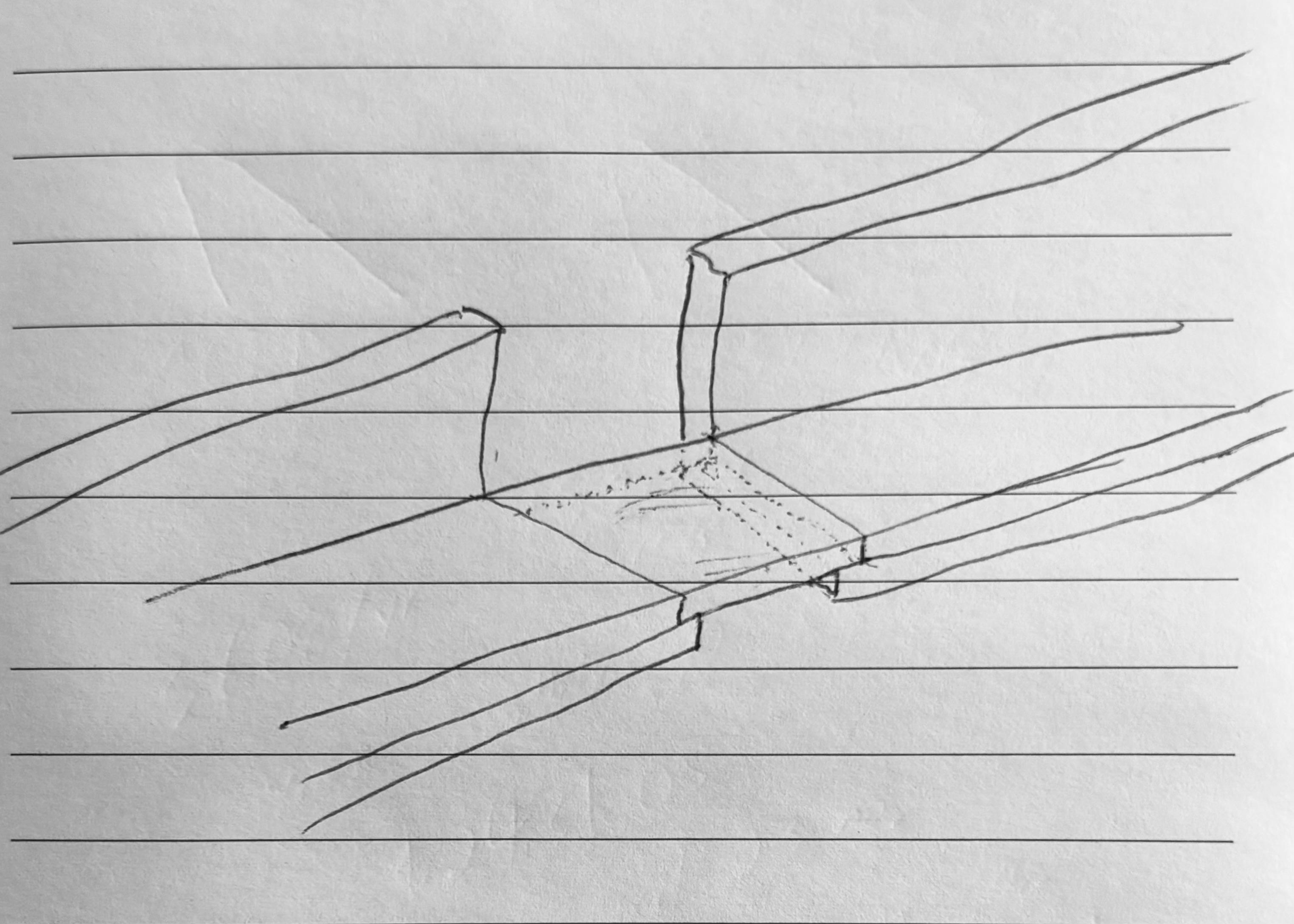

I'm playing with an idea for a clamping jig with a space for 2" x 3" (or thereabouts) plexiglass clamping block inserts, thus:
The idea here is to set up a belt with the ends in proper alignment, spread on the glue, apply the tape, add another plexiglass block on top, clamp everything together with a C-clamp or a couple of spring clamps, lift the whole thing out and set it aside to cure, put in another block, lather, rinse, repeat.

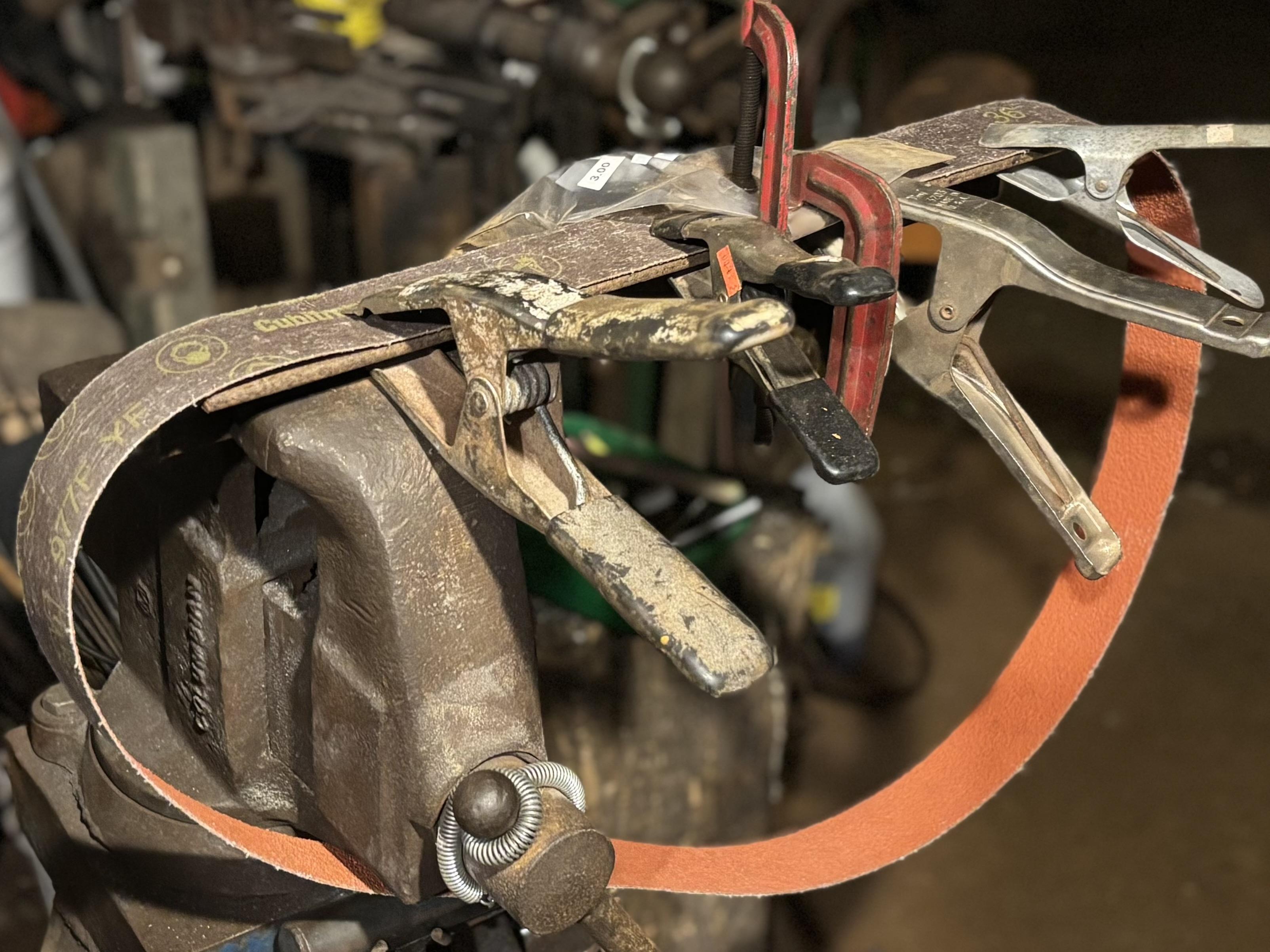

Update: upon closer examination, I discovered that the polyurethane had not adhered well to the backs of the 36 grit belts. Gluing up in batches had allowed the joints to go out of alignment. Not abrading the backing cloth and not clamping heavily enough had prevented the glue from adhering properly.
I therefore reglued two of the 36 grit belts, first removing the glue residue and then roughing up the cloth backing with a farrier’s rasp. Both the backs of the belts and the splicing tape got a wipe with a wet paper towel. I glued up the belts one at a time, carefully aligning the two halves, clamping the joint solidly, and allowing each belt at least an hour under clamps to let the glue cure.

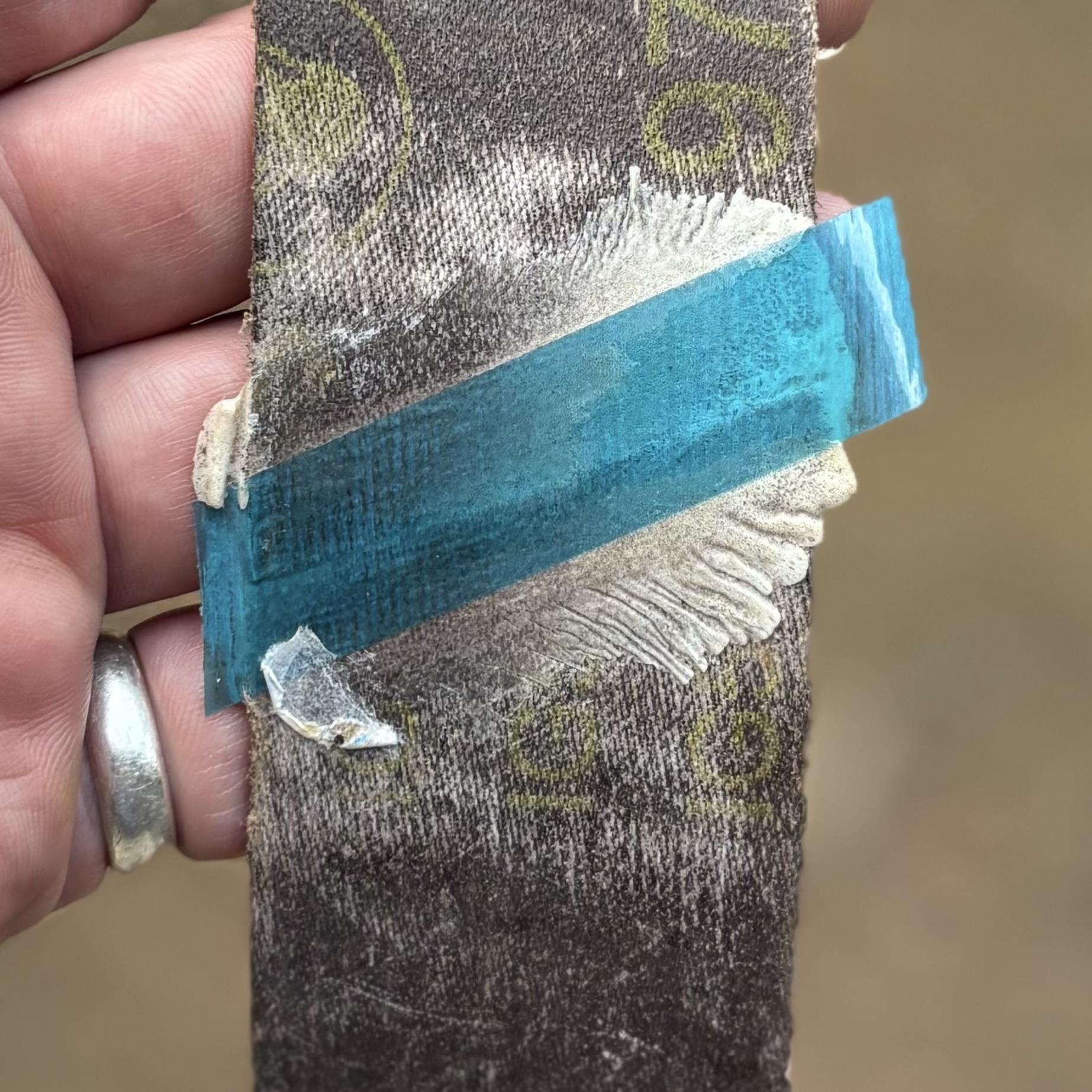

Here’s the back of a belt whose slice failed. As you can see, the glue did not penetrate the (unabraded) surface at all.

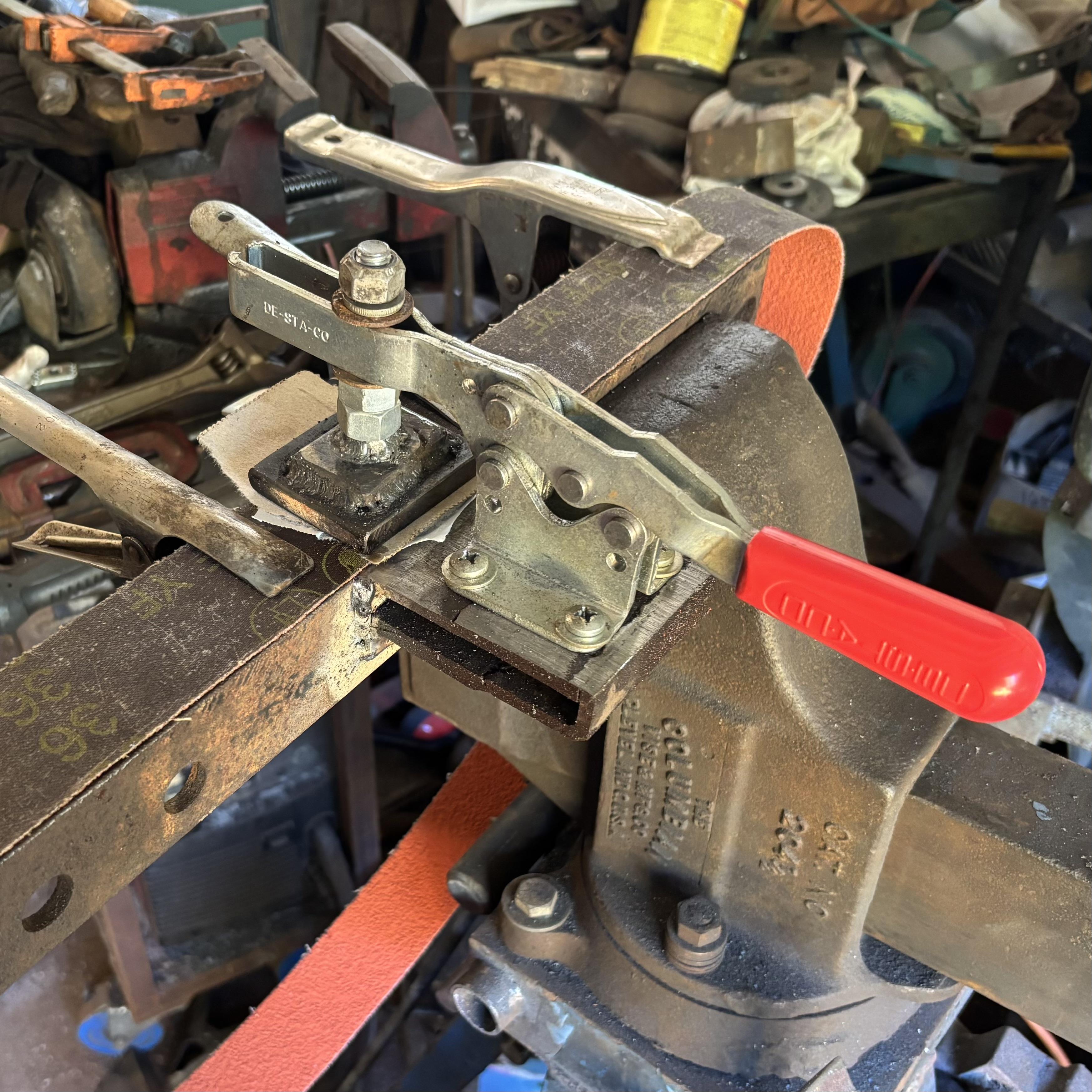

Here’s a belt under clamps for regluing. Each end of the belt is held onto the jig by two spring clamps (four total), which allow very precise and secure alignment along the straight edge of the angle iron before gluing.
The caul I used to hold down the splice tape this time is a 3” length of 1/4” x 1-1/2” flat bar, held down with a beefy C-clamp or (as here) a pair of smaller ones.

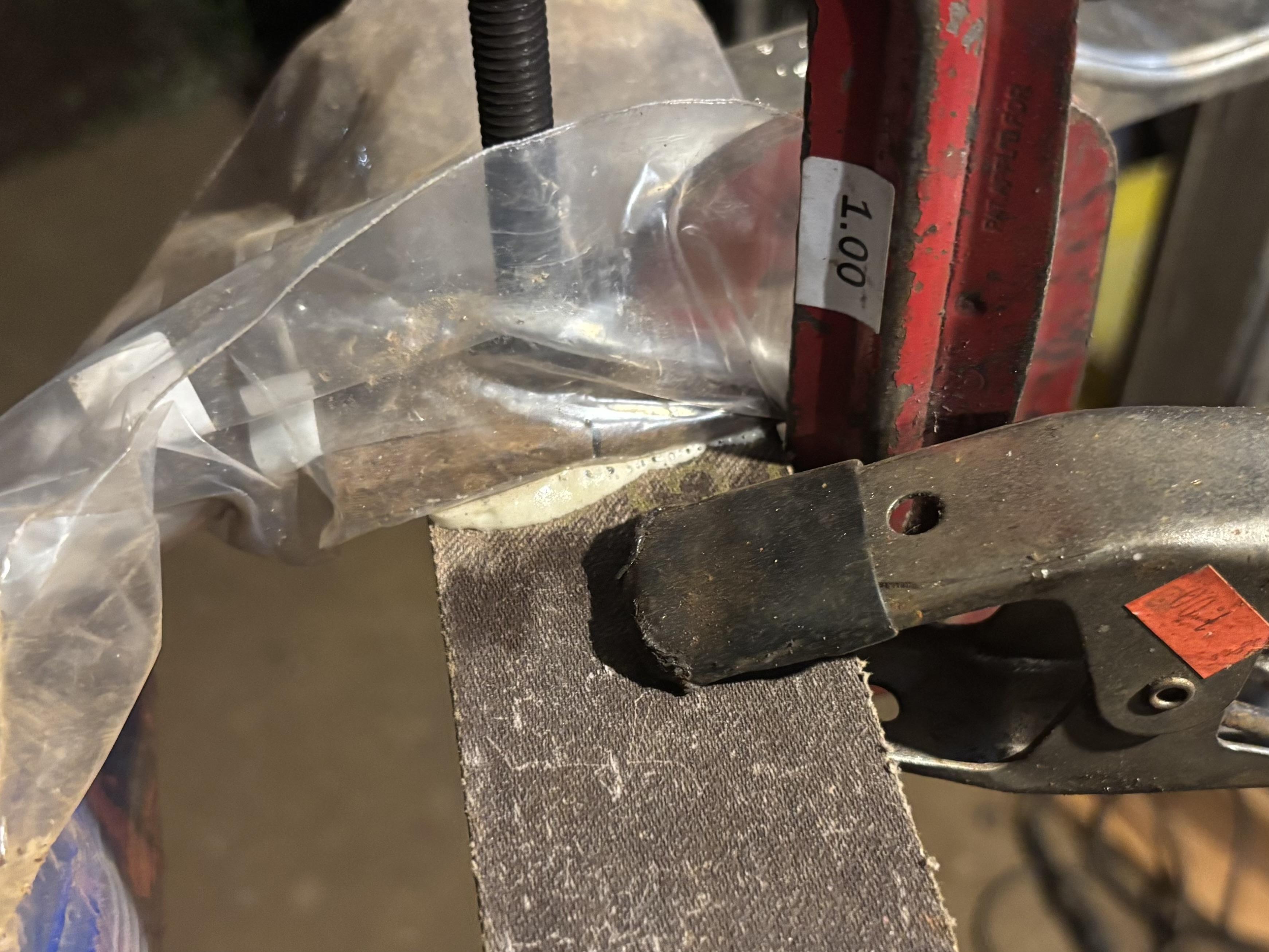

The glue squeeze-out cleans up quite easily once everything cures.

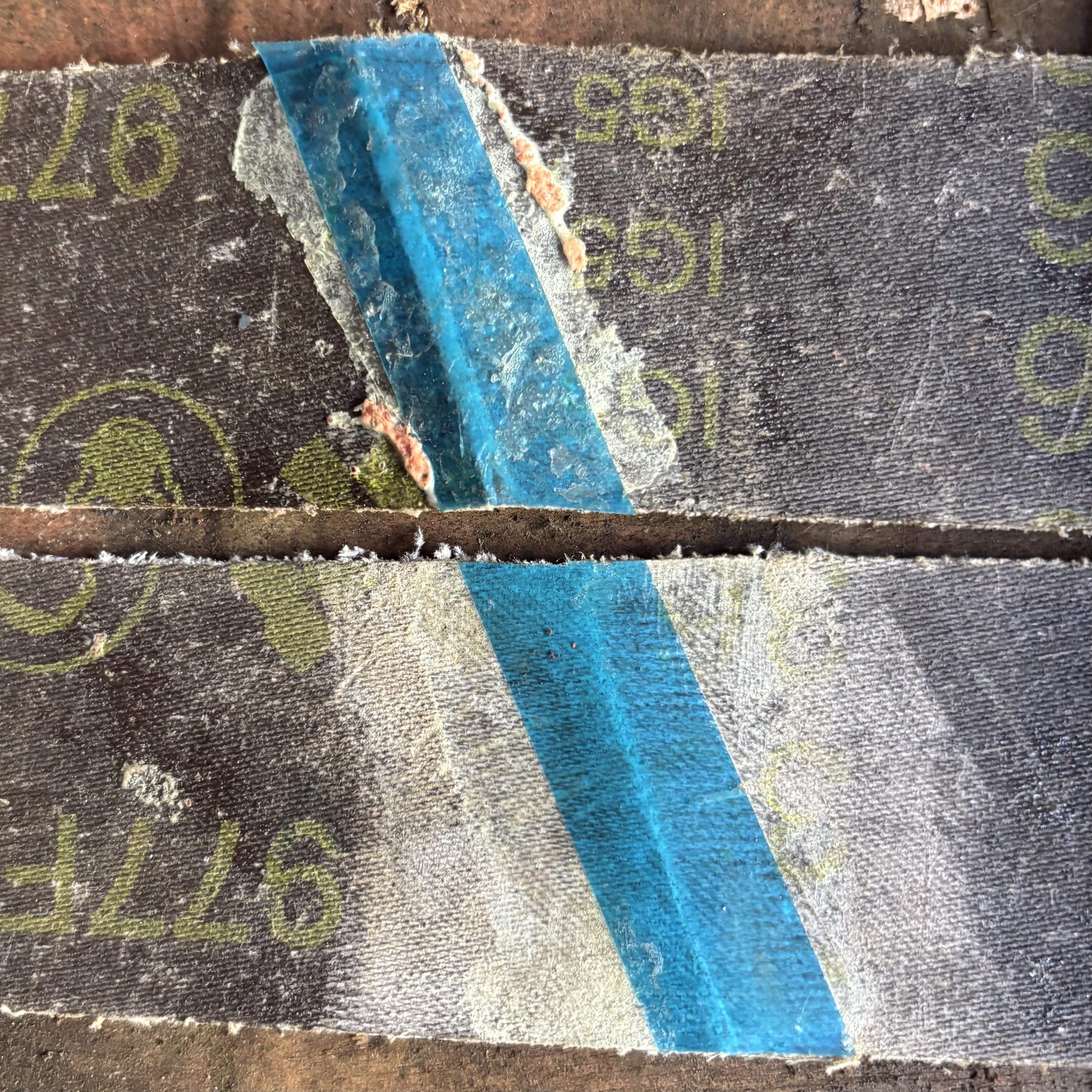

For starters, here’s a comparison between the previous batch and the latest. The belt on top is from one of the batch glued up as a batch and didn’t have the backing abraded. The one in the bottom was individually glued after the coating on the back was filed off.
The joints were lasting longer before self-destructing. Indeed, one belt lasted long enough that I was close to trashing it anyway (remembering ThomasPowers’s dictum that you should “grind like the belts are free”). However I could see that the point of failure was still the interface between the glue and the belt. On the next belt, I abraded the joint area with a scrap of 36 grit bent, in the hope that the ends of fibers thus raised will increase the mechanical strength of the joint.

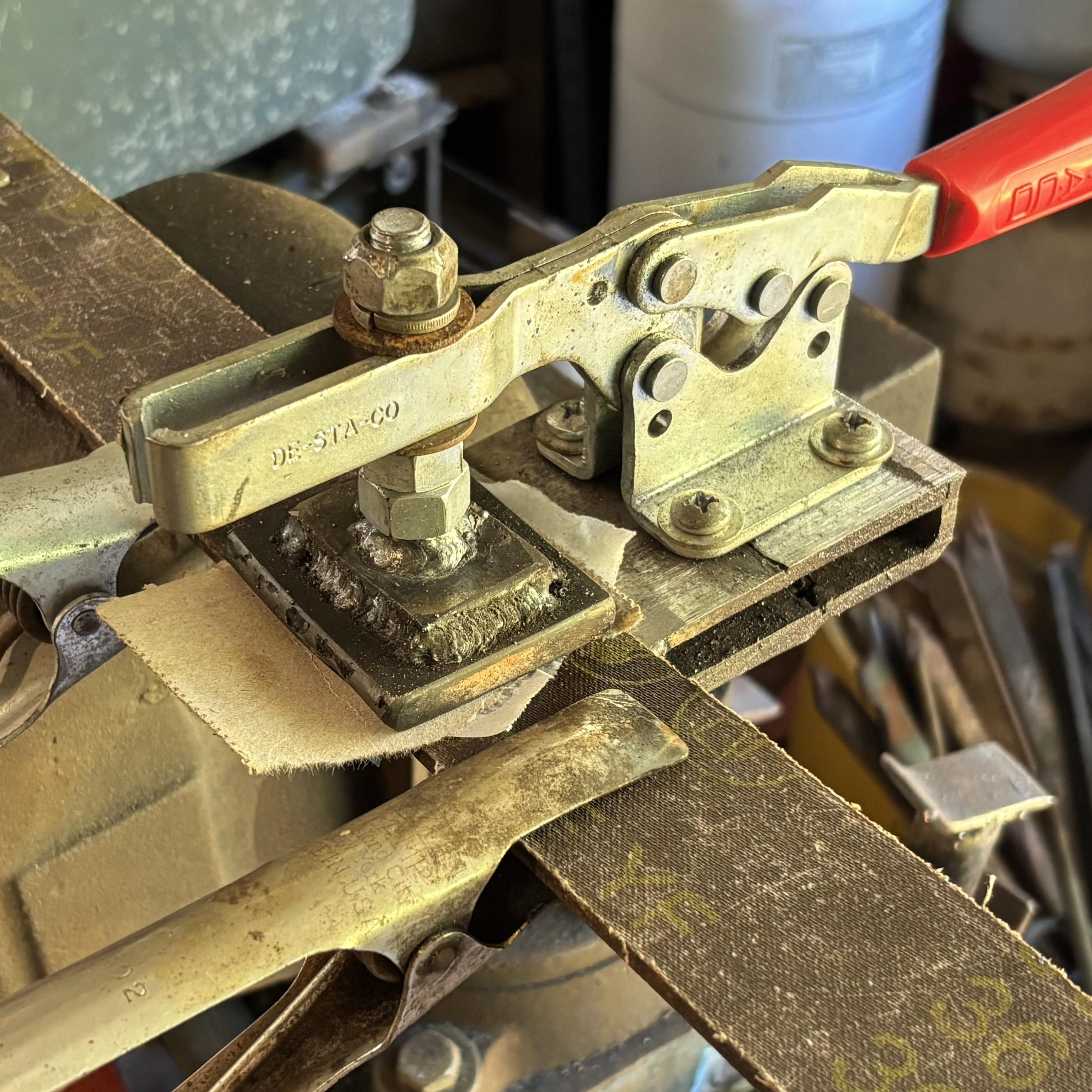

In other news, I mounted a toggle clamp on the gluing jig, to simplify the clamping. Here it is, with some thin cardboard and some parchment paper between the belt and the caul.

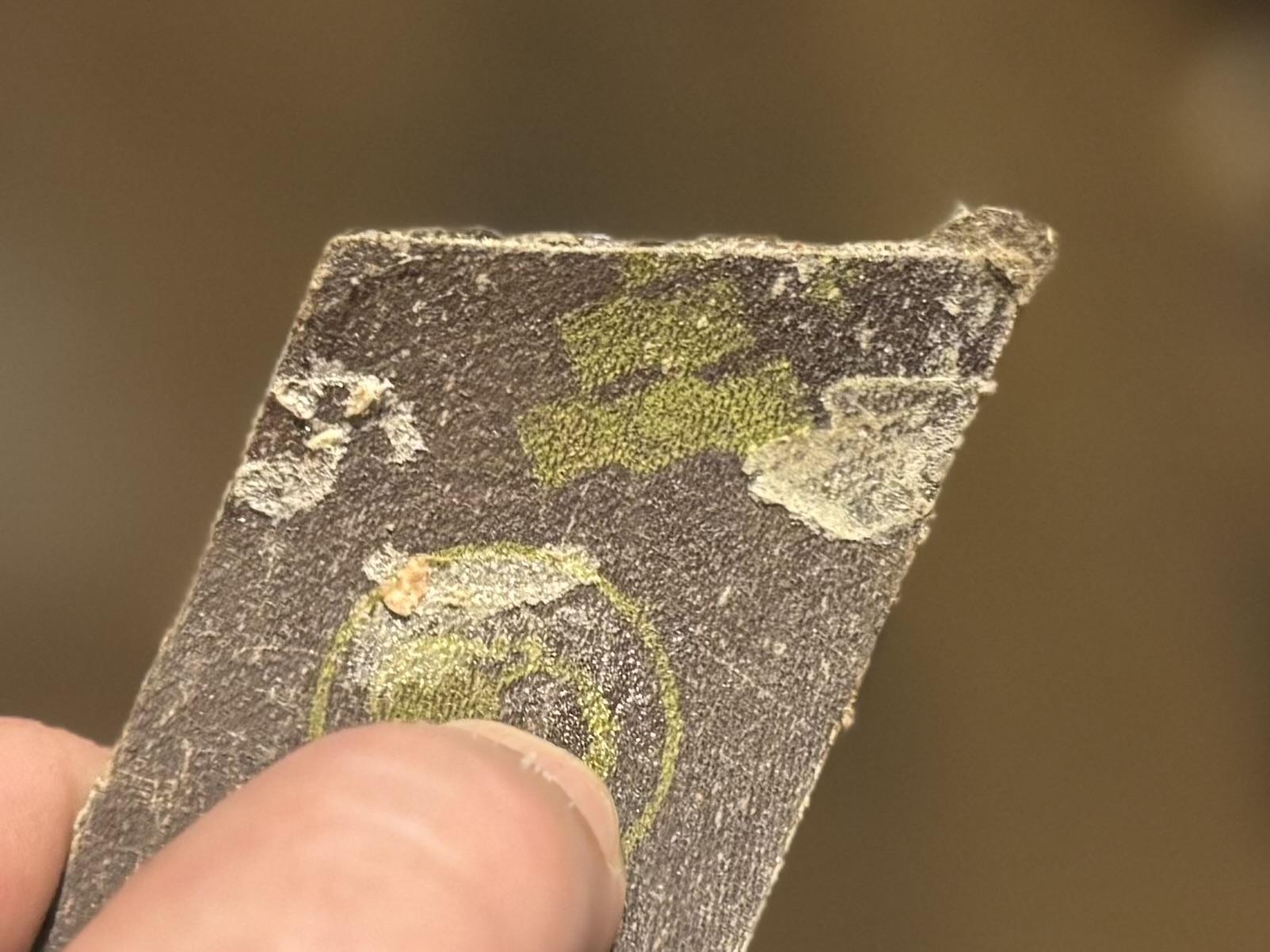

Here’s the most recent splice, out of the clamp but not yet trimmed or tested.
As you can see, the clamp was a lot tighter on the left-hand side than it was on the right. The bond looks decent, but irregular. I think I need to make the connection between the caul and its bolt flexible, so that it won’t press more on one side than on the other.
An observation: One interesting characteristic of polyurethane adhesive is that a thinner layer is stronger than a thicker layer (not unlike hide glue, come to think of it).  Really hard clamping pressure across the entire width should help.
