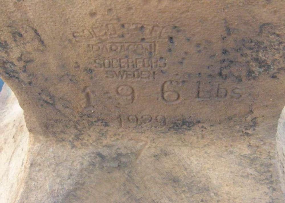

My neighbor is now willing to let go of her late husbands anvil after seeing how I appreciate his wood working tools. It is clearly cast so I tapped a small cross peen laying nearby and it seems fairly dead. So I'm guessing cast iron but could sitting on dirt hide something? After brushing the waist I could read made in sweden. To the left of that there might be something but I can't make it out. Any idea what I might be looking at? She said to make an offer.

I believe that's a Soderfors. Very nice anvil if it still has its hardness. How's the rebound tested with a ball bearing?  If it isn't good, the anvil could have been through a fire and ruined the temper. Otherwise, I'd guess it's just the dirt deadening it.
Well, the crud and rust on the top could disguise any kind of ring or rebound, as well as sitting in the dirt. Looks kinda like a Soderfors, cast steel and measured and stamped in pounds. Looks well used with nice round edges. I'd clean the top off with a wire brush real good and give it another tappy- tap. It should bounce your hammer back at you and ring like a bell. I do see what seems to be a horizontal crack just below the face that bears investigating. It gives the appearance of an applied steel top, but this is a solid cast steel anvil, so..... Make sure you know what you have there before whipping out the wallet. An anvil like this without any issues in my neck of the woods could be worth $3-4 per pound (US).

So I got the chance to evaluate the anvil further. First I got it of the dirt and sitting on dry 2x6's. Then I brushed the crud off the face so I could tap it with my forged 3lb that I know to be hard and know how it reacts on the peddinghaus. I didn't have a chance to get a ball bearing and the 1/2" bearing I have I'm pretty sure I torched years ago. The anvil face is hard and rebounds great and has a good ring. The hammer that was laying there from the previous visit is indeed soft.
I inspected the "anomaly" under the face and it doesn't seem to be a crack. I tap all along and around it and didn't hear any change. It overhangs the side and that corner is well used. It really does look like the way a chisel mushrooms from use. Also I think I can make out Soderfors on the side.
